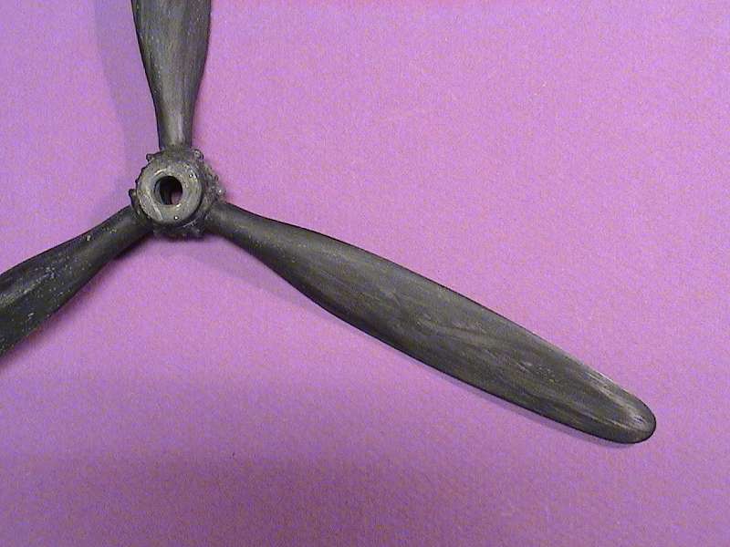

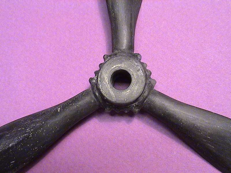

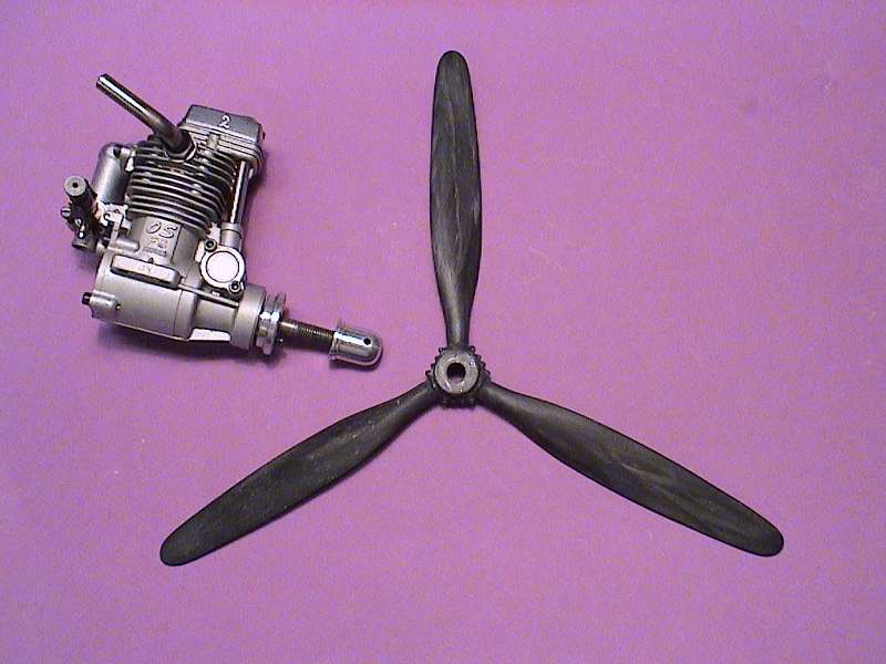

Here is my scale 3-blade 10x5 carbon prop for my Marutaka DC-3 (span 211cm). Engine is OS FS .26. This engine turns this prop at 9200-9500rpm on 5% nitro and 15% Motul "Micro" all synthetic oil.
Regards!
Jan K
Sweden
