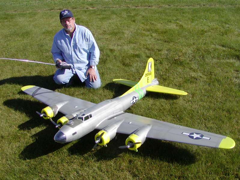

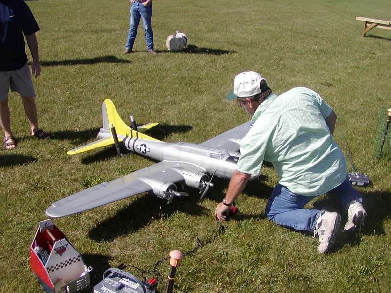

Inspired by a recent pilgrimage to Bomber Field, RV Man put 'er up in the air today. A lot of scale detailing, cowls, etc. were left off till after flight testing.
The little 2-stroke Webra's performed well. This Fortress seemed really fast and smooth in the air, even at 1/2 throttle. Required 12 clicks of up trim, none of aileron. According to RV Man: "Not nearly as hard to fly as a P-38!!"
Landing without flaps (RV Man's trademark) was fast and very smooth. The crowd erupted in applause. I've got video, but no idea how to post it.

Great plane. Have you flown it yet? Pics airborne?
Just info.. I fly my C130 and use aileron to rudder mixing. On my second flight the #4 engine quit, (a bit lean) and I flew the plane in and landed using rudder with only minor issues. So just consider mixing. Also when flying if the plane makes a sudden turn in any direction (which is what the herk did) suspect an engine out. Make the plane go where you want don't let it drift off your flight path. The rudder becomes critical. I also use only 50% flaps for landing and full for take off. Total Herk flights todate are 29 with at least 4 hrs in the air time.
Best of luck and post flying pics please. Have a nice day. Jim

Sorry, no in-flight stills.
I do have about 10-12 minutes of video, including takeoff, landing and several low passes, but I'm nowhere near sophisticated enough to post it here.
Yer dead on about engine-out. I lost the only P-38 I ever had an engine-out, but my experience with other twins is you need to get on rudder and get the plane straight EARLY, 'cause once you start that rolling/spinning business, you may as well set your transmitter on the ground and start looking for a trash bag!
