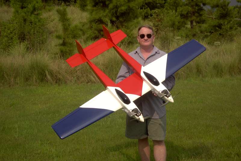

My buddy and I are currectly getting ready to start a project experimenting with engine out thrust. We are going to use an ARF for quick results and build in 9 degrees of engine out thrust on each side. 9 degrees gives you 99% (cos9=.9877) forward thrust and 15% side thrust. We are going to offset the nacelles 5 degrees and use thrust plates for the additional 4 degrees.

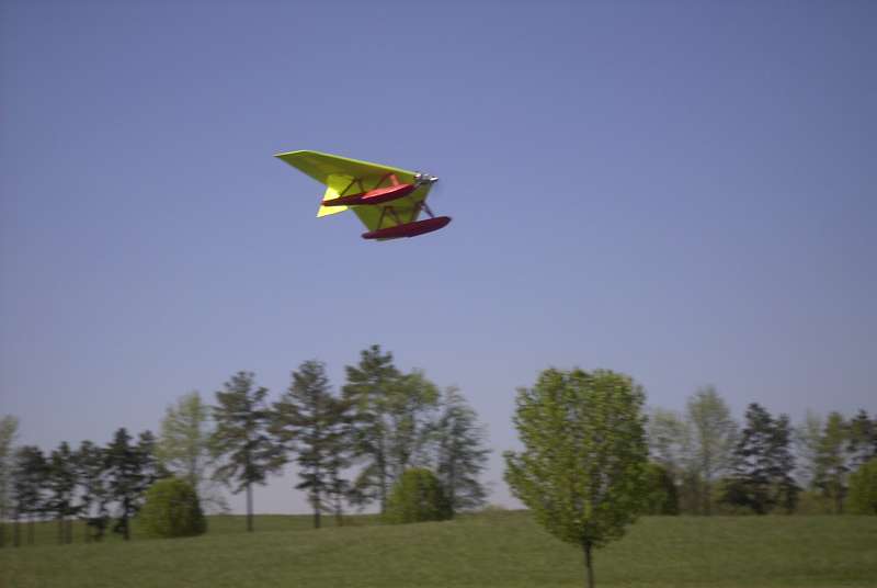

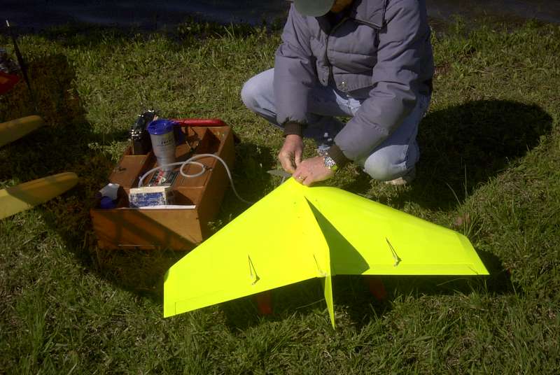

The North Star, a delta seaplane also by Mikulasko has the engine mounted above the wing almost the same distance as my conversion ( 5 1/2" from center of prop shaft to center of wing rib, my conversion is 5"). The North star has the prop located 14" behind the center of gravity, mine are 8 1/2". Very similar setup for a very sucessfull model.
The North Star plans call for 1 1/2 to 2 degrees down thrust. Thats why I thought it would be OK to leave the original down thrust in the Enforcer. (Thats down behind the CG, so maybe has a net positive effect at the front).
