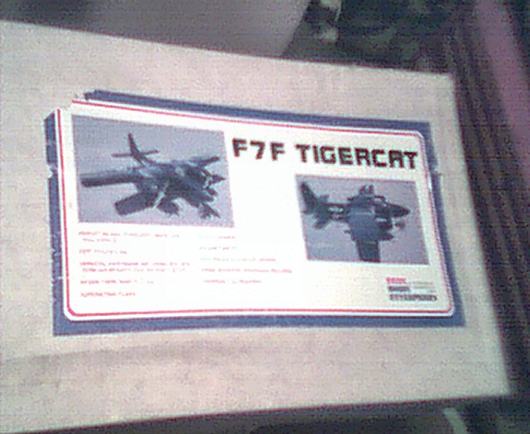

George:
Almost right:
Nothing is so cool in the air as a P-38!!!
Except an F7F.
See the big nacelles on the little airplane? More power, more speed, more thrills with an engine out!!!
Haw.
Bill.
