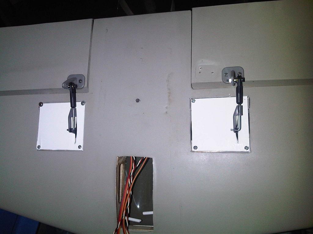

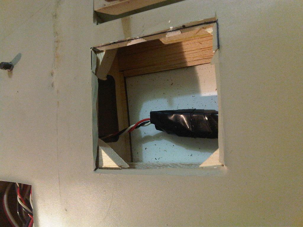

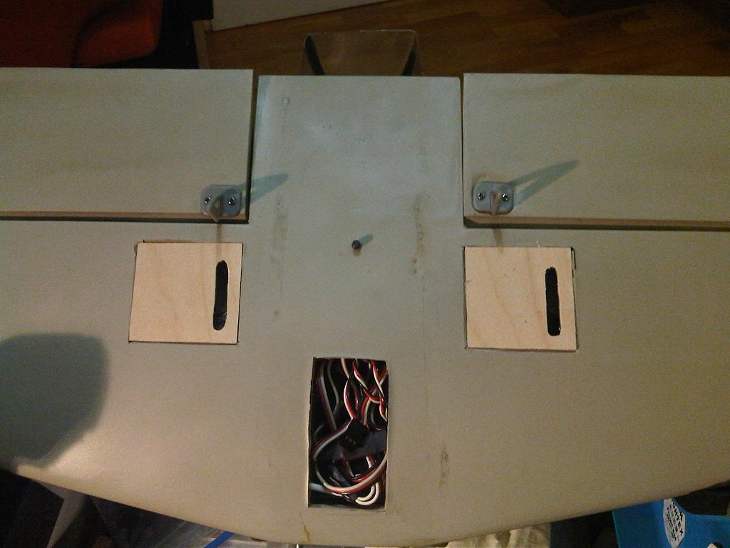

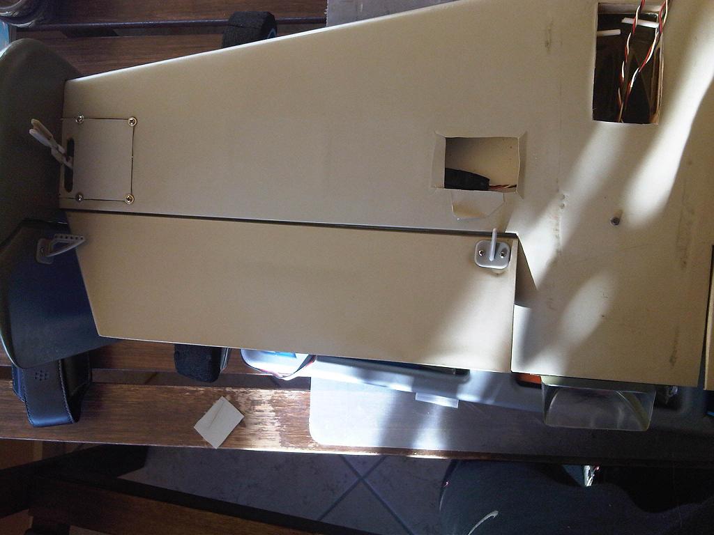

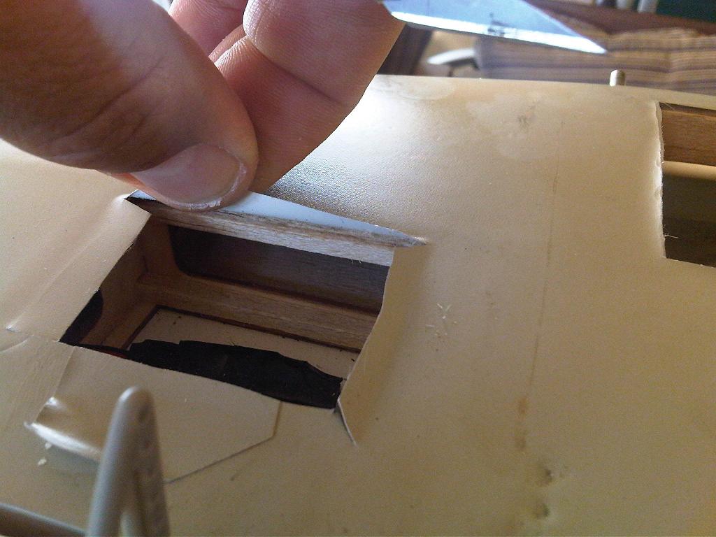

Modded the tail to have two elevator servos (one for each for redundancy), used D-MG16 mini servos
Used ball links for smoother operation

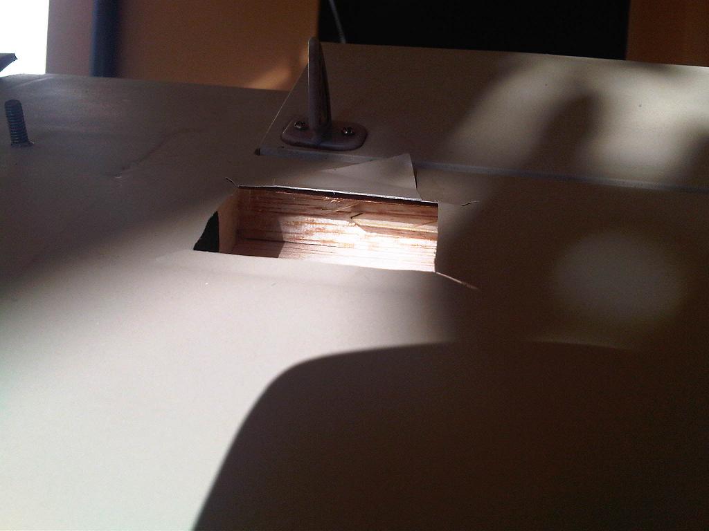

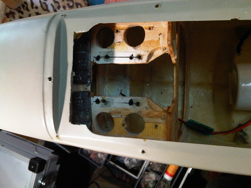

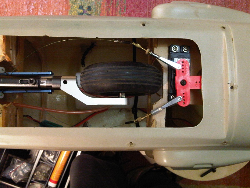

Next problem to solve is the front gear that hits the servo mount when retracted
I searched the thread and saw that some people had to cut off part of the ply mount [link=http://www.rcuniverse.com/forum/fb.asp?m=2970034]link 1[/link], [link=http://www.rcuniverse.com/forum/fb.asp?m=5198734]link 2[/link]
Any suggestions?

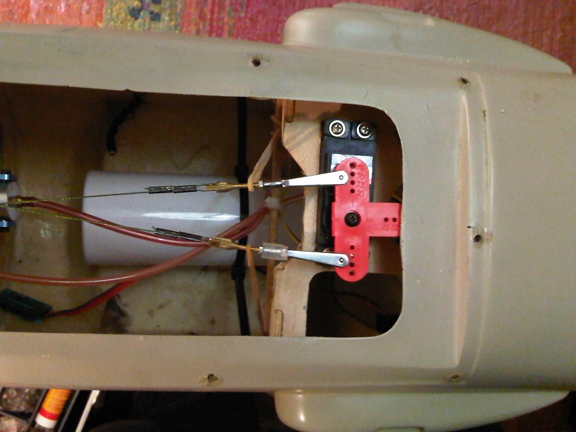

Had to chop some of the front retract mount for the wheel to retract properly.
Also copied the rubber band trick to keep the pull-pull wires out of the way

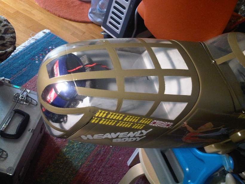

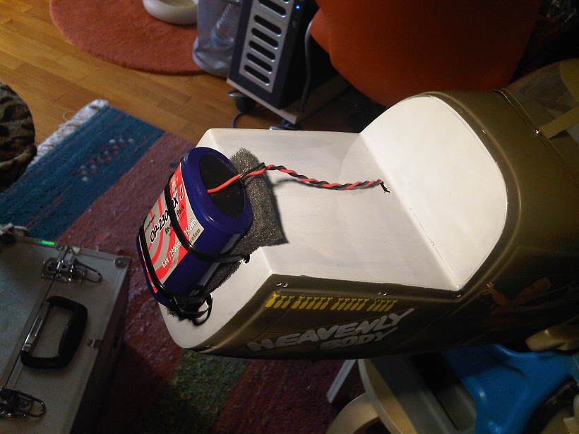

Battery up front for CG balance
