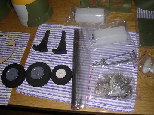

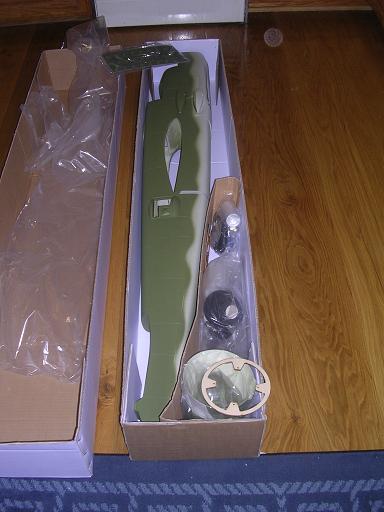

This is the first of two boxes:
First picture:
As it arrived in box one.

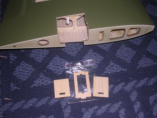

Second picture:
Everything out of the box.
The fuse is fiberglass.
Third picture:
Hard foam wheels.
In case you want to get replacements, they measure 2 7/8" and 3 3/4".
Usual hardware stuff. The control horns are colored: nice so they match the plane.
The tanks are 8 oz (maybe 10). No label so I'm guessing.

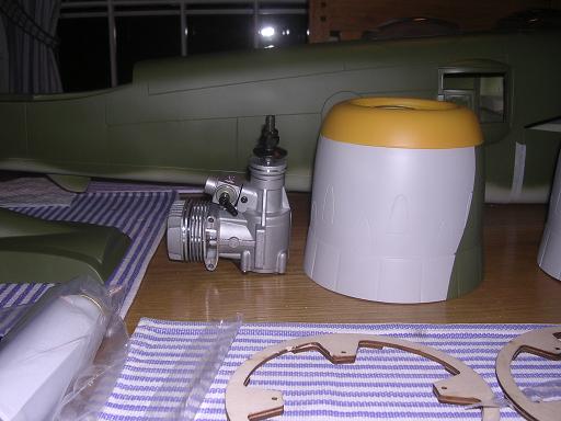

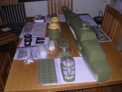

Fourth picture:
Cowls with an OS FX .91 next to it for comparison.
The head will be sticking out the bottom but not by too much.

Fourth picture:

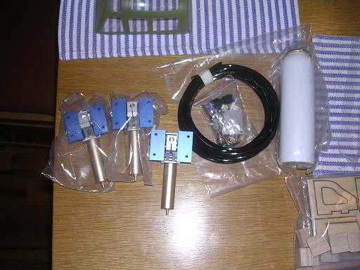

My Feedback: (43)
First picture:
Retracts appear sturdy and no slop noticed.
Looks like 3/16" diameter.
Will have to buy struts unless they're in the other box.
I plan on putting at least a medium robart air tank in, or if not enough room, 2 or 3 small ones.

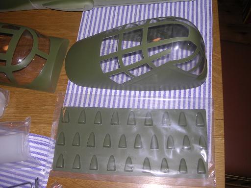

Second picture:
Six canopies.
Already painted.

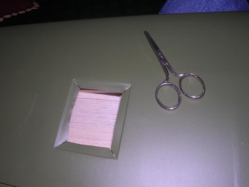

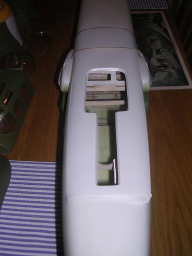

Third picture:
Nose retract area.

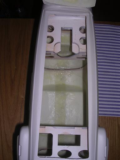

Fourth picture:
Nose retract with cover removed.

Second picture:
Six canopies.
Already painted.
Third picture:
Nose retract area.
Fourth picture:

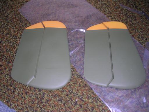

My Feedback: (43)

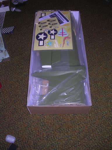

The second box arrived today:
First picture:
As is, with the cover off.

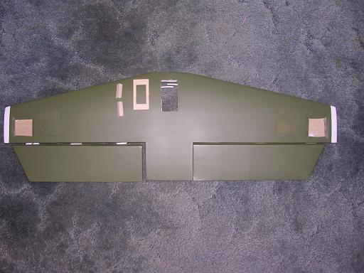

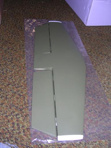

Second picture:
The horizontal stab is the first item out.
It is built up wood, fabric covered and painted so all parts match.

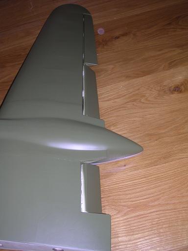

Third picture:
Left wing.
Built up wood with fiberglass nacelles.
The wings are partially sheeted so the ribs show through the fabric covering.
Don't know if the real had this but it wood seem that
the entire wing would have been aluminum covered.
This wasn't real noticable (at least in the basement) and it would save on weight.
First picture:
Second picture:

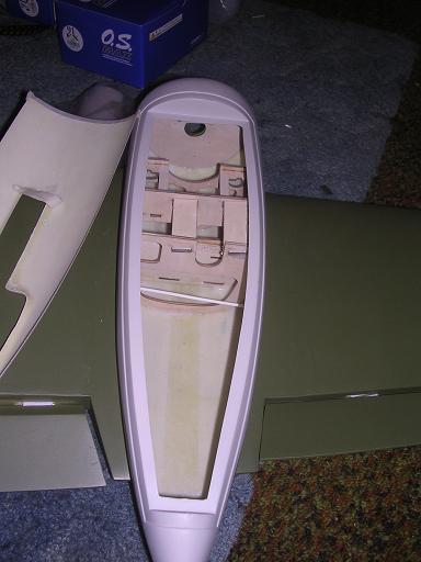

My Feedback: (43)
First picture:
Bottom of nacelles.
You can see the faint outline of the piece of fiberglass that is removable.

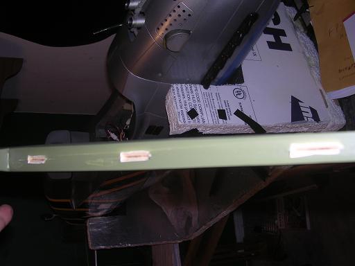

Second picture:
With piece of fiberglass removed.
That white line is the guide for optional wire controls of all 4 flaps by one LARGE servo.
There is not much room in there for larger tanks.
I bought 16 oz sullivan's flexible tanks and I'm not sure if I'll be able to get them in there.
There's a servo mount on both sides which I'm assuming for upright or inverted engines.
I may be able to carve some ply away and have the tank shifted to one side.
I don't thing this will affect fuel flow.
I may have to go to 12 oz flexible tanks.
The manual says 15 lbs.
With the one servo, versus four, controlling the flaps and one also for the rudder,
this may be possible.
I didn't see any instructions for elevator servos but I only looked through the manual quickly.
With this light of a twin, and using OS FX .91'x, I will be able to fly at 1/2 to 3/4 throttle
and save a lot on fuel consumption.
All the parts are very light so she may come in at 15 lbs.

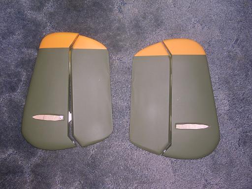

Third picture:
Vertical tail and rudders.
Built up wood and fabric.
The manual also shows optional wire control with one servo of the rudders.

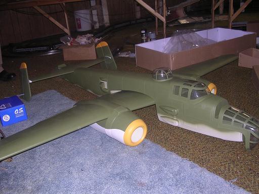

Fourth picture:
Loose assembly of the plane.
83" wingspan.
Seems like it would have been easier and stronger to make the top removable for
putting the wing on (but time will tell) instead of having the bottom removable.
The plane would also stay upright that way when putting her together at the field.
Four bolts instead of 2 dowels and 2 bolts are used to hold the wing to the fuse.
The wing is two pieces that obviously stays together.
I was thinking that we would have two outer wings to attached so the business part
would all stay together (again, time will tell on the design).

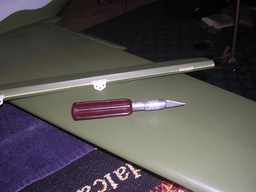

All hinges are CA type: I'm using Great Planes medium nylon pinned hinges (GPMQ3972).
She looks nice, even in the 'loose' assembly stage.
Bottom of nacelles.
Second picture:

Fourth picture:
83" wingspan.

Fake radial engines.
Dare design ( www.darehobby.com ).
9 cylinder scale radial engine, diameter 3 1/2" ,part # 1028-12.
One per package but very 'cost effective'.
I noticed the rear gunner's canopy has paint on the back portion of it.
I believe this is suppose to be clear.
Mine has a light coating so I'm going to try auto polish to remove it.
If that doesn't work, it should be an easy fix to cut out the old and put a
new piece in since it is flat.

Hinges:
First picture:
Tonight I installed the Great Planes pinned hinges gpmq3972.
I put triangular grooves on both surfaces so the pin area has a place to move freely.
I use an Xacto knife to cut it and the back side to widen the slot for the hinge to slide in.

Hinges:
First picture:

Third picture:
I use small scissors to cut the fabric covering away for the hatches.
I like leaving 1/4" around the edges so the wind doesn't lift it up.

First picture:
All pinned hinges are in the wing.
It takes awhile to cut all those triangles and grooves.
I put oil on the pins before epoxying the hinges.
One side of the hinge first and after it dries, the other side.
After sliding the ailerons and flaps to the wing,
before it dries, I check to make sure the ailerons and flaps move
the distances I want them to. This insure our servos won't be overworked(like us!).
Keep lots of 2"X2" paper towels and alcohal (not that kind!) around to clean up excess epoxy on the plane
(and your fingers): Those finger marks will show up rear good on that mat finish.

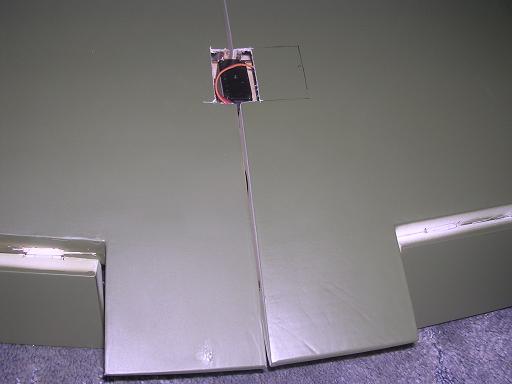

Second picture:
The center wing section is cut out for the flap servo.
There's a small bag with a servo tray that I used (in picture).
I used my trusty razor saw.
The outline that is to be cut on the rib is already laser cut but not all the way through.
There's no outline for the sheeting.
I cut to within 1/4" to the next rib.
Third picture:
Here's the dry fit.
Top view.
Fourth picture:
Bottom view.
Looks like we'll be routing all out wires, air lines through this hole.

hinges (stab area)
First picture:
The horizontal stab.
I'm also going to use one servo and guide wires to control the rudders.
The stab is symmetrical but there is a bottom and top (bottom has servo hatches).
Again, I'll be using the hatches with the small rectangular holes.
Second picture:
Vertical fins and rudders.
Also left 1/8" covering for where the stab goes into the side of the vertical fins.
The vertical fins are multiple layers of balsa (rudders are built up).
All pinned hinges for all tail surfaces.
Third picture:
A better view of those triangular slots for the hinge pins.
