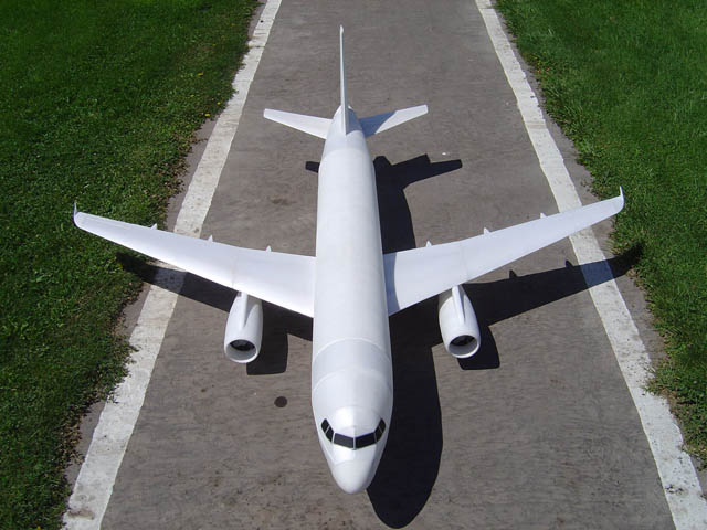

All of these A330s and A340s have 0 degrees. Due to their size (4 meters) they are easy to handle with some rudder input.
Pic comes from [link=http://rauch-airliner.com]rauch-airliner.com[/link]
