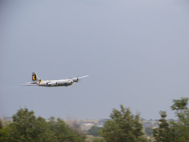

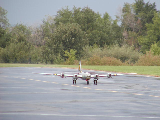

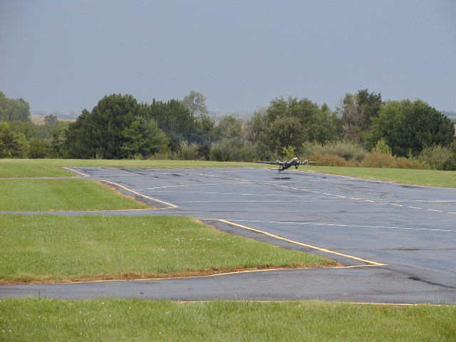

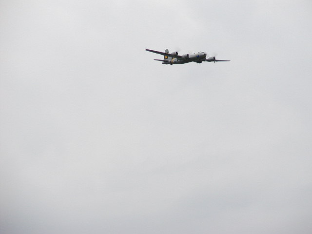

We flew again today. It was truely a miserable day but it was the Labor Day airshow and it was for a good cause. We had a little damage on this flight on landing....retractable scale tail skid, but it is still flyable. we are still learning this plane. Check out the nose high attitude on landing and you can probably see that the inboard engine#3 is not running.
