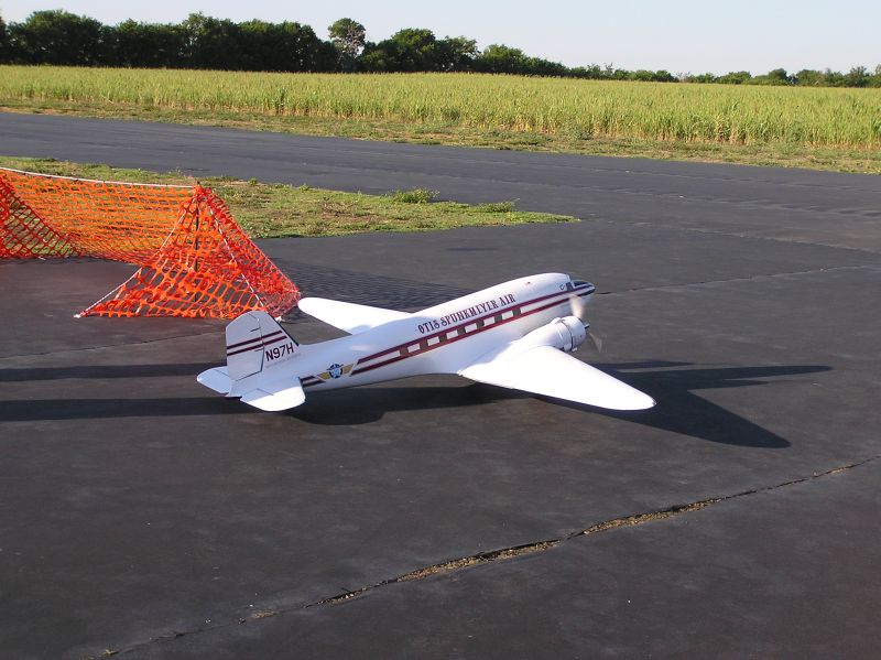

He has flown a beautiful Top-Flite DC-3 for years, although the only time he's lost an engine is at low power on final approach.
The reason he's so adamant that you shouldn't use rudder when an engine goes out on a twin is the following statement in Top-Flite's manual for the DC-3:
The good news is, if you are flying at normal speed and you lose an engine, all you need to do is continue flying
your DC-3 using only elevator and aileron. In all situations refrain from using the rudder when an engine quits. Otherwise, you may induce a spin.
Is Top-Flite afraid that you'll overcompenstae with the rudder, or is there something unique about the DC-3 that means using rudder in an engine-out situation is ill-advised?

One other thing you can do is to fly level and pick up speed. The rudder was put on the plane as a flying surface. If you gain speed the rudder and other controls will be more effective. The minimum speed the rudder will hold the plane straight is known as (for a twin) single engine minimun control speed.
I fly the model herk and have over 1000 hrs in the full size. The rudder MUST be used on the full size to get the bird back to the runway. I demo/ed this to a student when I was an IP. He would have made a smoking hole without the rudder.
Now for the model,, cautious use of the rudder is helpful. Remember you can't feel all the back pressure the servo does. In the real bird you have direct feedback to your foot.
On my model herk I mix ail to rud. That way when I lose and engine (twice in 35 flights) and turn into the good engines I have rudder to help. (WARNING don't turn into the dead engine unless you are extremely high and have lots of airspeed)

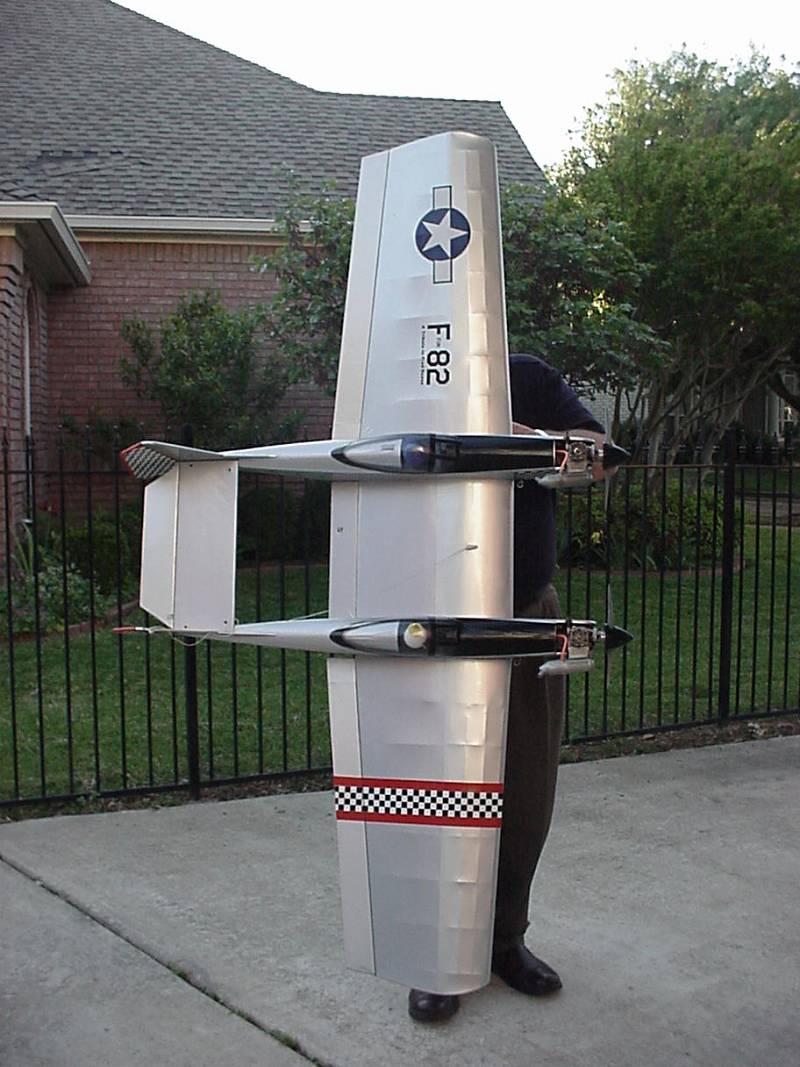

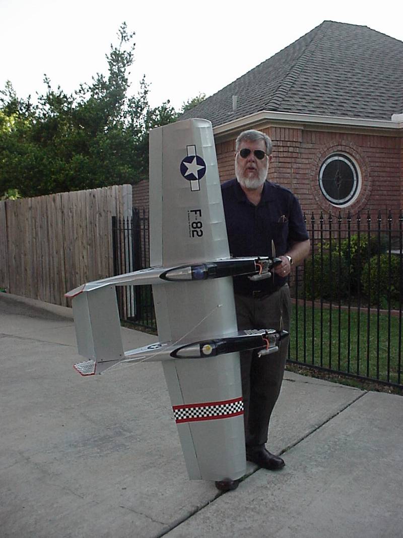

I don't think that I would want him flying my DC-3 on just the ailerons. The F-un 82 on the other hand will fly on aileron only with either engine out and is capable of single engine take offs and single engine aerobatics. Twin vertical fins an rudders in the propwash plus a light wing loading make this possible.
I have flown two of the topflite DC-3s for another fellow and have made single engine go arounds with both.
I use the rudder and also the old light twin axiom that you can climb or turn with a dead engine but you can't do both.
For reference the F-un 82 has 2 OS 25 FXs and weighs 7+ # the DC-3 has Saito 100s and weighs 34#.
