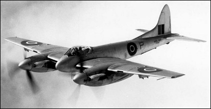

Thanks everybdy for the replays. W. Robison summarized the facts very good and things start to make sense in my little brain.
When i started the design, I copied everything from the full size plan, but then I realized the models are much harder to fly in abnormal situations, so I want to add more stability. I heard a long time ago that downthrust has a way of cancelling out some of the left turn tendencies, but nobody seemed to confirm that.
Here is my project...
JG
JG

JGrc, Get a Pica Duellist 2/40 and bash it. Check it out, Duellist 3-view is very close to the DeHavilland wooden wonder, should be an easy alteration.
Single engine, not a pair? At least you're halfway there.

WLR,
I would get the Duellist except that is too small & I have the Hornet pretty drawn and ready to cut. Also I checked the dimentions and like you said is very close to the Duellist , I figured it might not be a visiuos airplane. To compare I measured distance from CG to vertical, angle and distance from props to CG then calculated percentage of the wingspan and is all within 4%. The Hornet has 0 downthrust, 0 sidethrust, 0 horinzontal and +1.5º wing incidence.

JG, Thanks for saying "Hornet." I knew it wasn't a "'Skeeter," but I couldn't remember what the later plane was called. Re-reading your earlier posts I can see that you were looking at a larger model to start with, had I seen that before I would not have suggested the bash.
But, as I have said before, I have had the best flying planes using everything at zero-zero, both single and twin engined. The 1 1/5 degree on the wing will make it easier to fly upright, but inverted you might not like it. You could attach the wing in a manner to be adjustable, as most pattern planes are, but that would affect the thrust line also with a twin. Oh, well.
Have fun, that's what it's all about.
