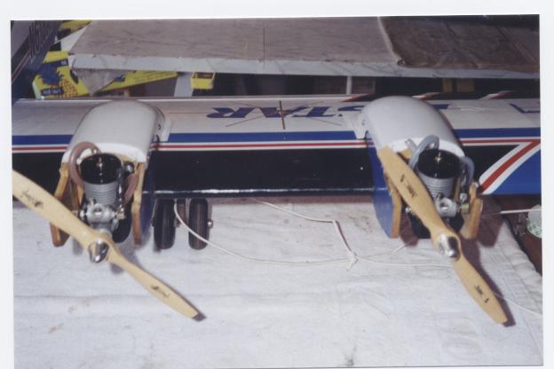

I've now installed four AP Yellowjacket .15's into my Twin Star Sq. I had to set aside my current project, to do the work. I wanted to get my Twin Star Sq. back into the air and I've had the last engine sitten on my work bench staring at me for ten day's now. The engines went in with a little more work then I originally thought, but they are now in and running. I've three of the four beginning to do their thing, but one will take more time. I will not fly until all four are singing and stay running in the vertical. So I've more work to do to brake them in.
The AP .15's came out at about the same weight as the OS Max .10's I removed. I had muffler extensions and full mufflers on OS .10's to fit the nacelles. The AP .15's have a much more compact muffler and lends itself to install in nacelles easier too. I've put 8 X 4's on the .15's, wood Zingers. I do not use plastic props...of any kind...But that is another story.
I've enclosed a picture of the new instillation.

This is what the OS Max .10's looked like with the exhaust extensions. The little .10's would fly the model Ok, but not with the power reserve I usually like in a model. The original .32's way overpowered the model and almost lost it due to all the vibration...and the covering that started to remove itself while flying. The wings are not built up strong enough to hold that much power, especially with the outboard nacelles mounted so far out on the wing. The four .15's should be perfect.
