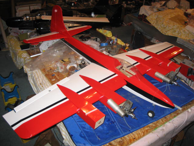

BillS
You happy now!!???..no, I borrowed the extra nacelles to mess with you. Tee Hee
No, it will fly as a twin!!

Thanks for the intriguing picture, which looks good. The twin disease is bad and unrelenting. But you already know that.
13” props? Must be using too much engine again. Assume the engines will be mounted at 9 o’clock.
With some thought about the inboard nacelle location the airplane could be a twin with option for bolt on nacelles for two more engines. As more experience is gained … ho, ho, ho.
Lets see … A .60 twin should come in at about 10# and 4 .40’s at a little over 12#.
The prop to fuselage clearance appears that it will be large. What is the center distance on the engines?

BillS,
The CURRENT and stock center to the fuse is now 10.5". My two cents is IF and I say IF someone were to do this. Move and glue the inboard nacelles center around 6.5", which would allow up to 12" props safely and then move the outer nacelles to a similar centerline to the inboard. My two cents, based upon the Cedar B-17..You would NOT need 40's unless something like LA's. Good .25's to .35's would work and be lighter. The prototype Ceder B-17 has magnum .32's, with inefficient three blade props and will go straight up..and that was before the new fifth engine.
Neil WILL pick up these nacelles again, but YOU asked for it!!

from twinman:
That 12in clearance sounds like 4strokes in mind, but is that much disk really needed for that red zipper? Couldnt someone go the speed route with twostrokes and hi pitch short props for narrower spacing?

Good point. 10.5” clear would allow for 20” props. My o my what a big engine.

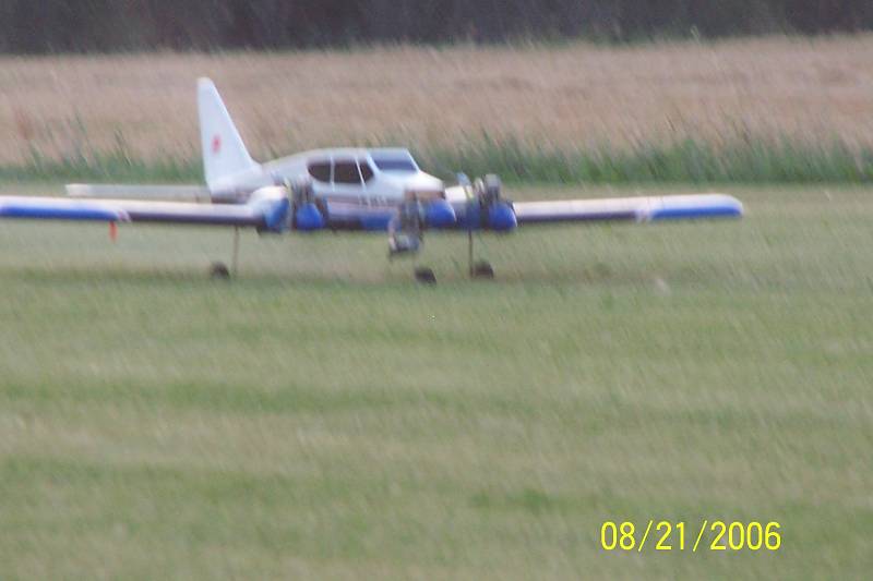

My four engine trainer. With 4 OS FP.25's it's way over powered and engine synch is very important with the outer engines so far out they have a lot of yaw pull.

An honor to have you posting here! I have to think there were some thrust line/ pitch issues with the engines in this position.
