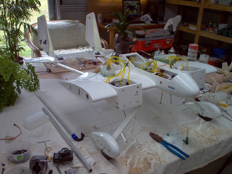

Hi Bob i supose you are talking to me down here in Australia, i am just finding my way with using this chat room so i will try to get a photo on here of my tripple engine, it is not designed on any real plane but i imagine it to be a unlimited racing class plane built for speed but it will look prity silly if it only goes slow when i eventually do fly it. for a few more photos look at my galery i just put them there today.[img][/img]

OK the photo worked. I have the 2 engines off the frount at the moment as the engine mounts broke when i test taxied it so i am making 2 new much beafier mounts and will have it back together in a couple of days. the wing extensions are not made yet as i want to get all the bugs out of this lot first and there are a few. 93cc combined engine power is orsome and more than a little scary?

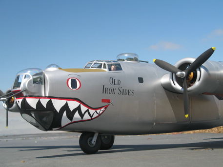

Electric is the ultimate for multi's . Yes the initial outlay of cash hurts a bit but the payoff in smiles and confidence while flying are priceless. Consider this- Instant on of all four motors, very low idle, never do you need to tune a motor, never need to sync a motor, never worry about an engine out, lots of power for the size and weight, can turn a bigger prop, the balance doesn't change during flight, need more power?, add cells, motors fit in small cowls and nothing sticking out, no need to fuel proof. Need I say more?
My B-24 is a joy to fly and I can only imagine the nightmare it would be if I had four .25's turning small props.

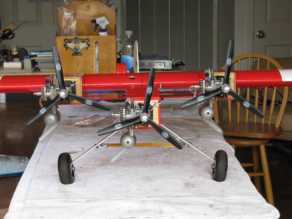

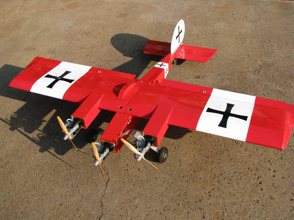

Nice flight and airplane. Four engines sure sound wonderful to the ears don't they. I just finished a three engine ugly stick...came out to ten pounds and flys on three MECOA .32's. Yes...multi engine R/C aircraft take time to set up and to build. But the pay off is in the flying and the joy of having accomplished something quite unusual.
Now...what is next on your building board... ?

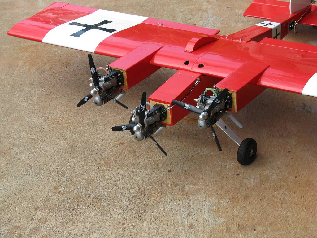

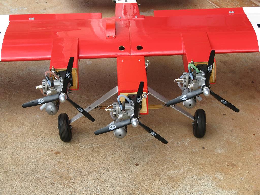

Yes...it did take some time to set up my engines so all worked in unison. I ended up using two servo's to run all three engines, with one for the wing pylon engines and one in the fuse. I made special hatches to get into the wing and do any repair or fixes to the wing engine servo too, and it was worth all the work. My model is so fast, it was a surprise, for at ten pounds, it was no light weight. I needed to add a bit of weight to the tail, and I ended up placing a fuse access hatch aft of the wing and installing a large five cell Ni-Cad to help the balance. I used 9x5 wood propellers first and then went over to 9x6...the props recommended for the engines. The 9x6 made the model even faster... : ) ... but I ended up going to 9x7 three bladed props to slow the aircraft down enough to land it. I had so much residual thrust at idle with the 9x5 & 9x6 props, I was not able to land it until the engines started to run out of glow fuel. I have now set up my Tx that at full down throttle, the out board two engines quit running and the center engine continues to operate. The model will fly on one engine well enough to land safely. My center engine has the largest fuel tank...and I ended up beefing up the landing gear to handle the 10 pounds of airframe. It handles the wind well and very solid in the air. All Ugly Stick type models fly well...and this one holds true to the type.
Because I mounted my engines horizontal, and with the props so close to the glow plugs, I mounted remote glow head assemblies on all three engines.
The hump near the center of the top of the wing, is the fairing I made for the out board engine servo. I mounted the servo flush with the top, underside of the wing, so I could mount Dubro Easy connectors to the enigne servo arm.

You misunderstood my procedure for setting up my engines. What I do first is, tune each engine to run its best...by itself. I then set up the idle, so all engines idle the same...be consistent in the idle to each other, with RPM and transition to full power. I do not care if the top end is not the same...but I do want the idle to be rock solid and all of the engines running evenly. I usually set the idle cut off to be the same with all engines, so I can shut them down if needed, all together.
To me a reliable idle is most important in my multi engine R/C models. I want a consistent idle and thrust from my model so I can land it with more finesse. Just getting them down in one piece is enough...but with a consistent constant idle, you can do it almost each time you land. There is a lot of drag on most these type of models, so I always carry a bit of power in my landing approach.
