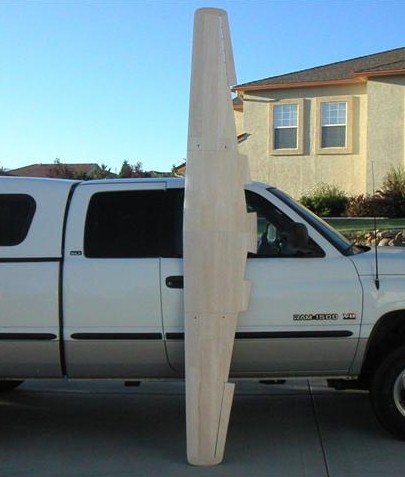

Past that benchmark a long time ago! Here are some pictures.

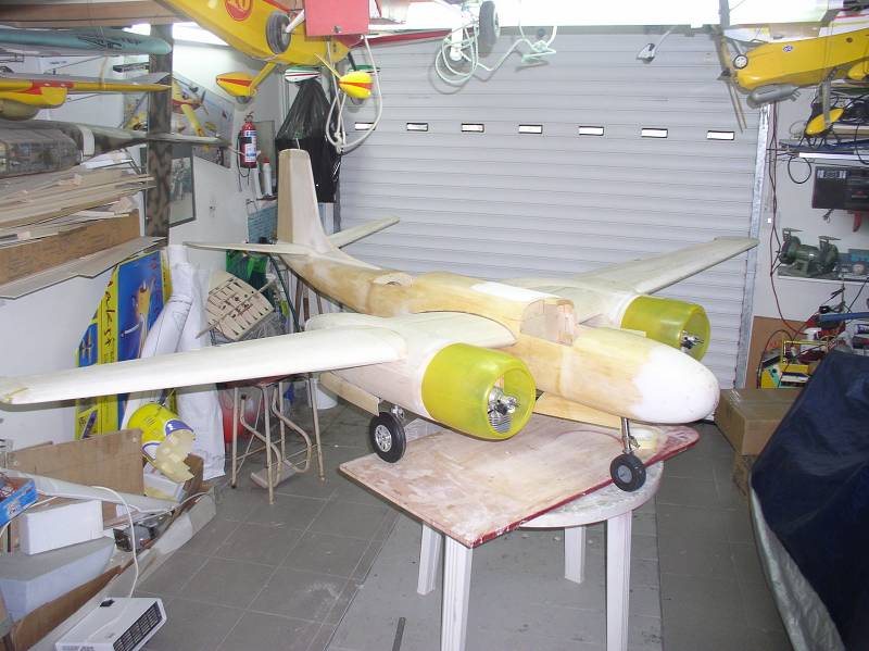

Hi there,
Mine has taken considerably longer than 1.5 yrs, I guess this is the 4th year or so. Long hours on the job limit my building time considerably, but fortunately, a fried of mine retired last year and gave me a helping hand on the monster and it is now nearing the painting stage. Originally, I was going to power it with twin 3W 24 engines, however I has serious reservations about this setup, and have now bought two Zenoah G45's. The build proved quite challenging, as the plans lack detail, especially for mating the centre section with the fuse. Anyway, I have tried to attach some photos but am not sure if I did it right. Good luck on the building.
Joseph
Joseph

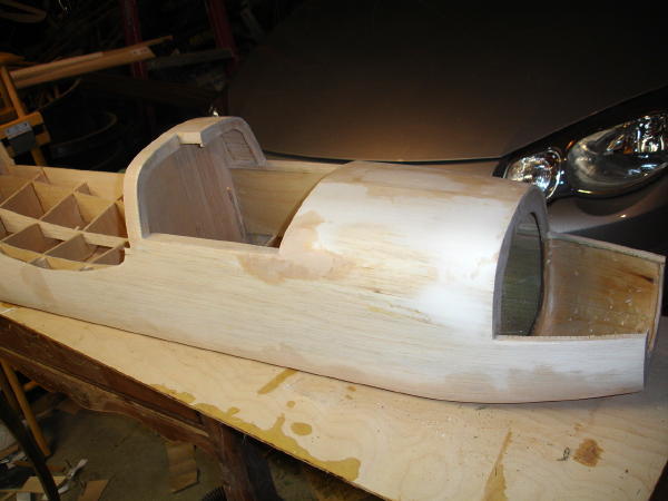

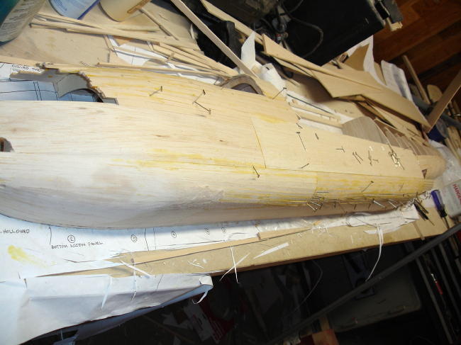

I'll restart my build here. First off I've been out of the hobby for about 14 years. It's good to be cutting balsa again. being my favorite plane ordered out a set of Don Smith plans in 1/7 scale. This gives it a 120" wingspar. The first thing you have to remember is that this paln is a blow up of his 105" plan. Thus when you put a piece of 3/8" balsa on the plan it is samll. Or don't order out a 4.5" nose wheel as called out on the plan or you will be sorry[sm=cry_smile.gif]
I always start with the tail. This plan calls for building a top and bottom half. Seemed to go ok but when I was done the tail had warped and was unusable. Probabily something I had done or humidity, etc. I built a new stab by sandwiching in 1/32 plywood with two pieces of balsa at the rear. This made the rear stab very strong and it just won't bend or warp. I built the stab as one peice covered with 1/16" balsa. The plan shows the elevator hinge line very near the elevator leading edge. I choose to use a more scale approach. This should help relieve some servo load. Once done I fiberglassed the stab. I started using West System resin but it was alittle on the thick side even after warming it and tended to set up to fast as least for me. I then changed over to System 3 epoxy which was very thin and gave lots of time before it started to cure. No rushing needed with this.
I cut out all the formers for the fuselage. I moved the plywood support in the nose area more to the side to allow a full cockpit. Before planking I tried sanding high spots down and fill in the low spots on the formers. Since these plans are hand drawn and enlarged, any errors are magnified. I used 1/8" balsa for the planking as stated on the plan but I think I should have used 3/16" due to increased spacing between the formers and to allow more sanding and less filling for a fair surface. I'm also building the 'C" model so the nose was alter accordingly.

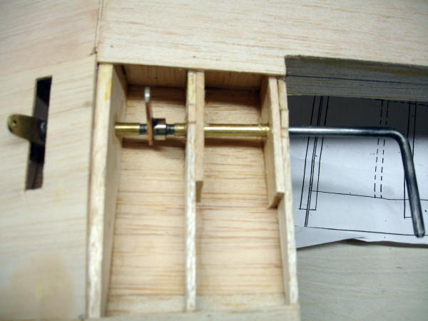

Hi Dave,
the gunners part is where I housed all the air valves, I have an ultra precision controlling the gear and gear doors, and one valve for the brakes, and another to open the bomb bay doors. I also put the batteries and power box under the hatch. If I end up tail heavy, which I doubt, as the G 45's are quite heavy, Ill place the batteries further forward and extend the wiring. I placed the air reservoirs above the wing. As for the flaps, they are as per plans, however, I used the robart fowler flap hinges, which are horrendously expensive, and the outer one jutted a little above the wing, which is why we made that blister. I still need to have a good look at the robart hinges as there is excessive play in the flaps.
If you will be using Century Jet gear, be careful about the gear mounting beams, as mine ended up wider after following the plan spacing. Also, the nose gear which is supposed to take a 4 1/2 inch wheel, will only tahe a 4" one. The gear is beautifully made however I did not expect century to use pop rivets to hold the scissors, etc, in an expensive gear as this.
Keep on building and post pics, at this rate you will end up flying it before I do !!!!!
If I can help in any way, let me know.
Joseph
Joseph

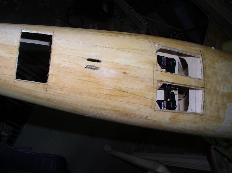

On mine, the gunner's compartment is where the air filler and switches reside along with the rudder servo (pull-pull). Under that floor are the two elevator servos. I can access these through the bomb bay door (non-functional) For flaps I am going to try to make something similar to the photos below. I found these on the internet but do not know who drew them. Tried to look for the site yesterday but can not find it.
Got any ideas on what to use to replace the pop rivets on the retracts? I do not like them either.
Great looking plane Joseph. You guys are getting me exited to get back on this again!

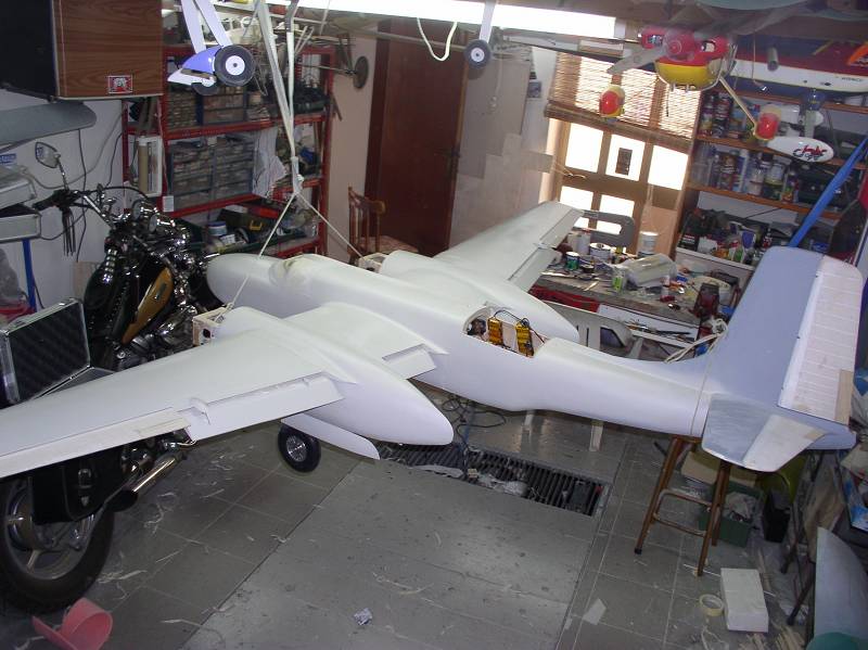

Joined: Mar 2005
Posts: 98
From: GhajnsielemGozo, MALTA
Hi,
Ichy, I am leaving the rivets as they are for the moment. The rudder and elevator servos (2) are housed about 1ft forward from the rear tip of the fuse, and all likages are very short. I had to make three hatches to access the servos, and also to acces the links from the pushrods to the torque rods.
Dave, it is the 120" version, and you are right, the nose wheel should be 5.25", but the century nose gear can only take a 4" wheel in the offset strut. I was really disappointed to find this fault, but I guess I have to live with it. The plug cables will stick out of the cowl. The 3W 24's would have been completely hidden, but I do not think that I would have been happy with the amount of power I would have had available.
Keep them coming....
Joseph
Joseph

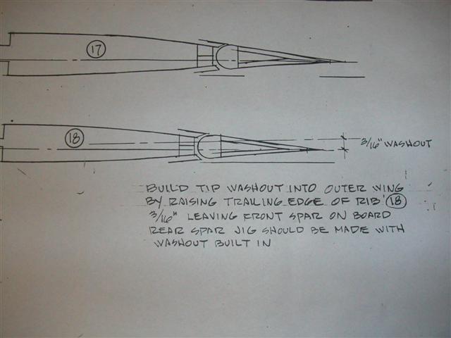

Dave, go ahead and redraw the wing ribs. The way they are they are off as much as 3/4 inch in length. The following is what I wrote in RCSB about the problem and including a picture.
"I think I found the problem of the wrong size ribs. In the upper picture there is a small tick mark on the horizontal line, indicating the length of each rib. Most of the ribs were drawn short because he added the length of the wing sheeting before instead of after drawing the rib. Does that make since? Anyway, I got the length off the plan view and when I compare each rib to this drawing, they all line up with the tick marks."
Also I would check the plans for length of port and starboard wings. I think due to changes in reproduction of the plans, they are off by a little.

Itchy, Thanks for the info. I thinbk I'll redraw...CAD... the ribs but using a 747A315 airfoil instead. It has a much "softer" stall then the NACA 2415. I wonder if anyone has ever tried this airfoil for model usage? Building is slowing due to very cold conditions in my garage [&o] I'll post some pictures of my progress.
Dave
Building slowly but steady

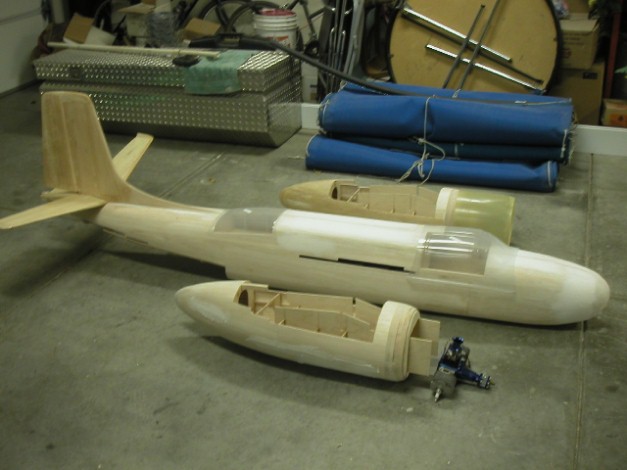

A little bit of progress...
Instead of using a balsa block where the fuselage makes an upturn just aft of the bomb bay I uses pink foam instead. Shapes very easily. When I fiberglass the fuselage I'll probably use two layers in this area.
The rudder was built up from 1/8 balsa base with a 1/8 inch brass tube for the hinging. I laminated two pieces of 3/8 inch balsa on each side to form the rudder's leading edge. 1/8 inch balsa ribs were installed as indicated on the plan. Lightening holes still need to be drilled. Positioning the rudder actuator and getting it perfectly aligned with the hinge line is proving to be a challange. After this is done the rudder pull pull control and servo will be installed along with the elevator controls. Sierra retracts says the front gear should be shipped this week. Hopefully it won't be to much of a problem to install.
Dave
Dave
Joined: May 2004
Posts: 241
From: Reno,
NV
Pink foam. Darn, wish I had done that. Balsa blocks and filler took a lot of time. Are you going to install the lower gun turret?
Eric, glad you are also building an Invader! I am using Glennis wheels and tires. Very heavy duty, but adds a lot of weight. Should hold up nicely for you. I will have to modify the front retact to make the tire fit because I wanted a scale wheel. The CJ retract I found out is not scale.
I am almost done with putting together an 80" Yak 54 ARF, so am in the process of cleaning up the work table to restart where I left off on the A-26.
But I am in the same boat as you Dave, it is so blasted cold here, I am turning blue! [&:]
