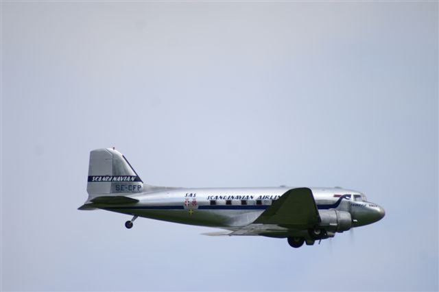

Hi!
I can assure you that one engine that turns in the opposite direction isn't needed on a twin.
OS has cams for their four strokes that makes the engine turn in the opposite direction though.
I use two OS .FS26 four strokes in my DC-3 below...both turning 3-blade, 10X5 carbon fiber props counter clockwise.

Cool...another .26 user!! I have flown twins with .26 and .91 4 strokes both turning the normal direction...there are no problems operating them that way.
If you do get a reversed rotaton engine, you would have to use a pusher prop on it, and they are very very limited in selection.
In the absence of a real compelling reason to have them turn in opposite directions, it is simpler, easier, and cheaper to use two off-the-shelf engines turning the same direction....
