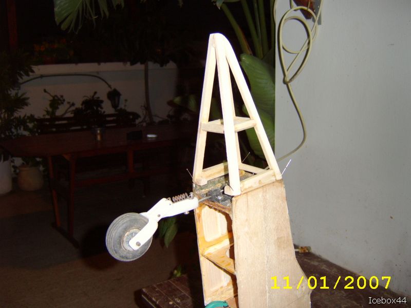

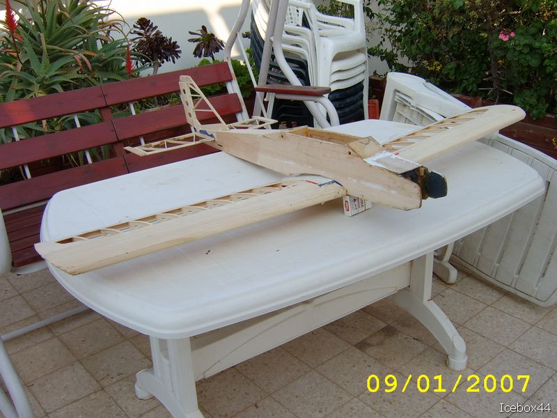

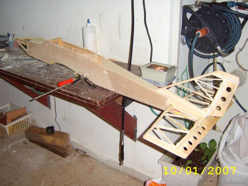

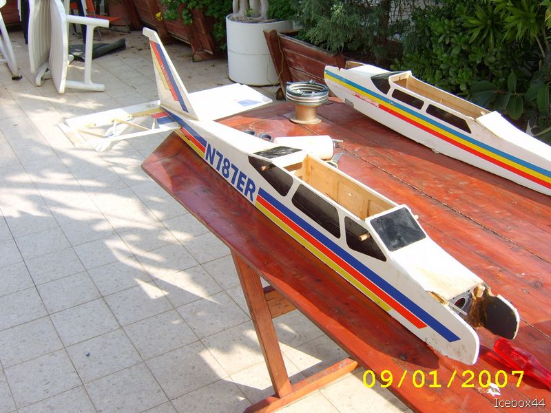

pics
ID:	617669   Click image for larger version
ID:	617670   Click image for larger version
ID:	617671   Click image for larger version

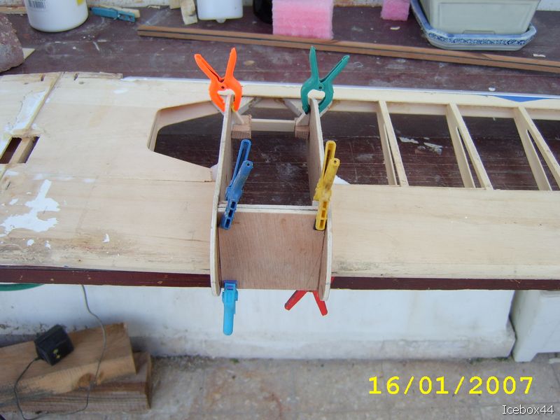

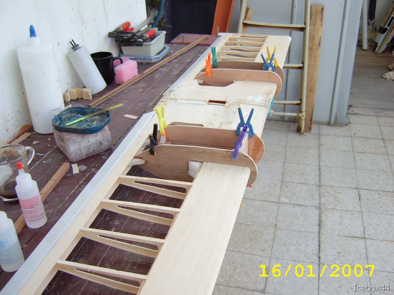

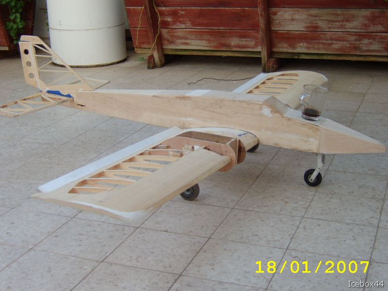

more pics
ID:	617677   Click image for larger version
ID:	617678   Click image for larger version
ID:	617679   Click image for larger version

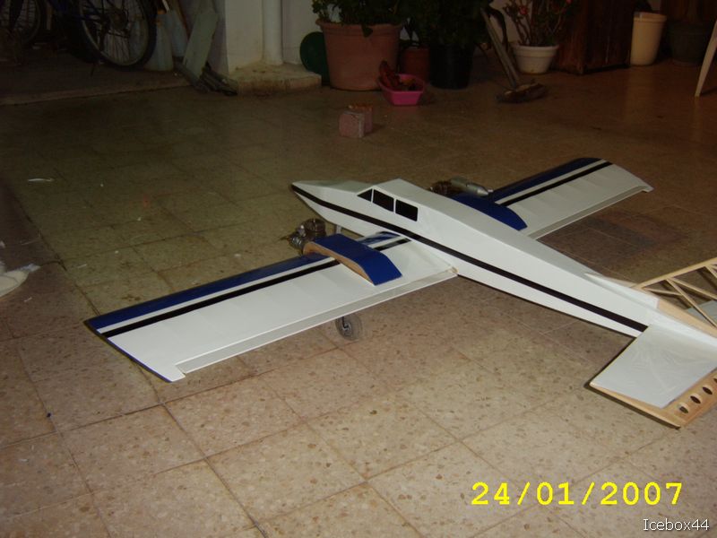

Old 02-10-2007 | 09:42 AM
Joined: Sep 2004
Posts: 41
From: gfdr, AK, ISRAEL
Default RE: modifying a trainer to twin

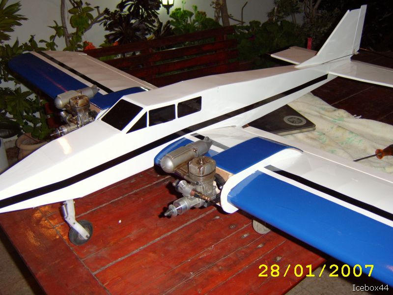

finished
need some covering
ID:	617681   Click image for larger version
ID:	617682   Click image for larger version
ID:	617683   Click image for larger version

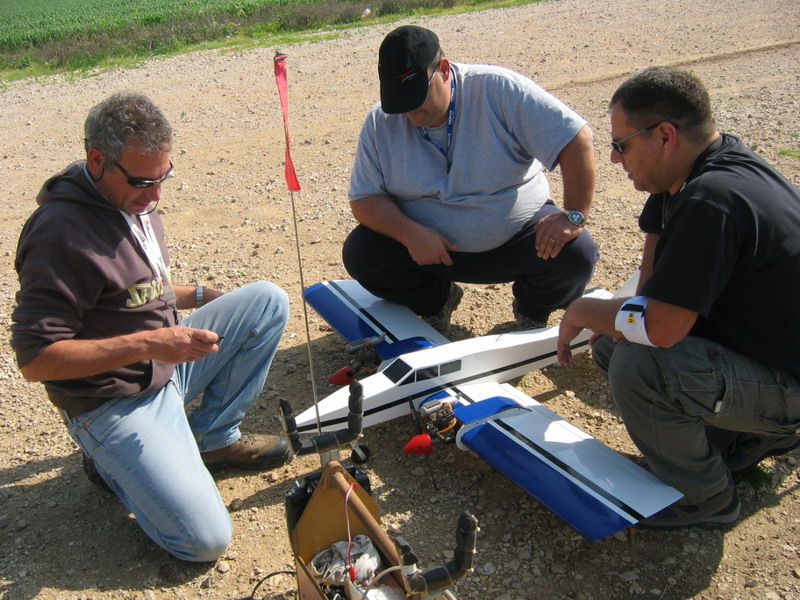

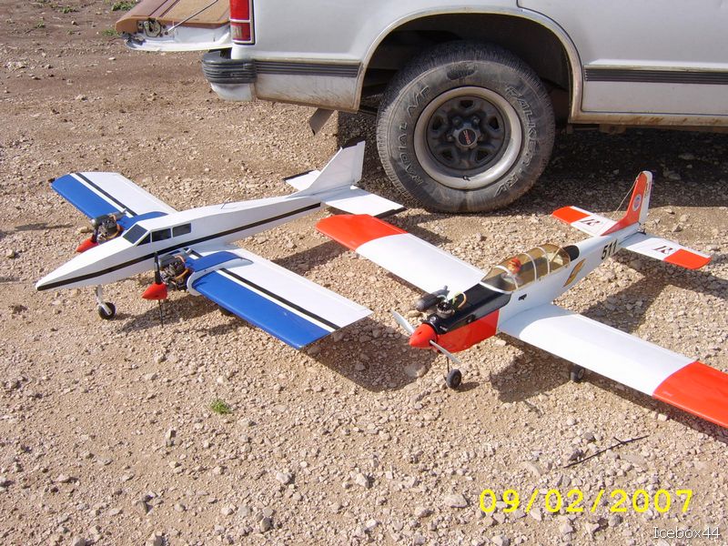

test fly day at the field.
ID:	617685   Click image for larger version
ID:	617686   Click image for larger version
ID:	617687   Click image for larger version

nice use of some old wood!
Questions:
when you cut in the pods for the engines - did you end up with a longer wing or just cut out '1 bay'?
how much tail weight did you need to get a good cg?
any thought to a foam nose? or maybe a single ply of glass to cut weight?
any thought to rotating the engines about 45 degrees (space allowing) and get the mufflers tucked under the wing?
Comments:
Fantastic job!
Great color choices on the covering
So how does she fly??!!

Hi
1. I left the wing at its original size.
2. since the engines are located near the CG point no extra tail weight was needed.
3. The engines are two old supertiger 0.40 that i had.
4. She flys great , very fast and the sound is amazing.
