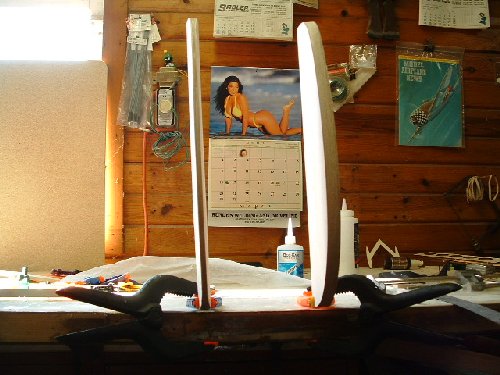

Old 03-10-2003 | 03:16 AM
  #31
Posts: 482
From: Central City, IA
Default Rudder Redo
Small set back as I decided to redo the rudders, I built the originals with no taper to them, some local experts convinced me that was not good, so I built new ones.

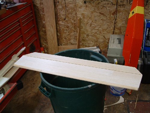

Old 03-15-2003 | 07:19 AM
  #33
Posts: 482
Default gus twin
Center mostly framed up need to add doublers inside yet

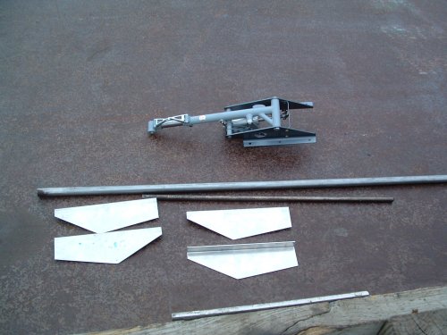

Old 03-21-2003 | 05:08 AM
  #35
Posts: 482
Default Gus twin
Couple of days getting things worked out building the landing gear. I had the mains made in a local machine shop (thanx to Keith @ Runde's Machine Shop) but bought the nose gear from Robart The basic parts of the main gear. I used my Robart zp38 gear as a pattern for the mains
Old 03-21-2003 | 05:10 AM
  #36
Posts: 482
Default Gus twin
The completed gear back home, ready to install

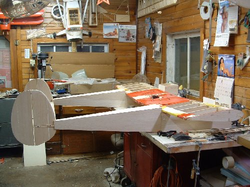

Old 04-07-2003 | 03:07 AM
  #42
Posts: 482
Default booms
shot of the radio compartment hatch

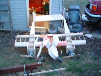

well this thread suffered a set back some time ago, we had a little accident with the project
ID:	76059   Click image for larger version

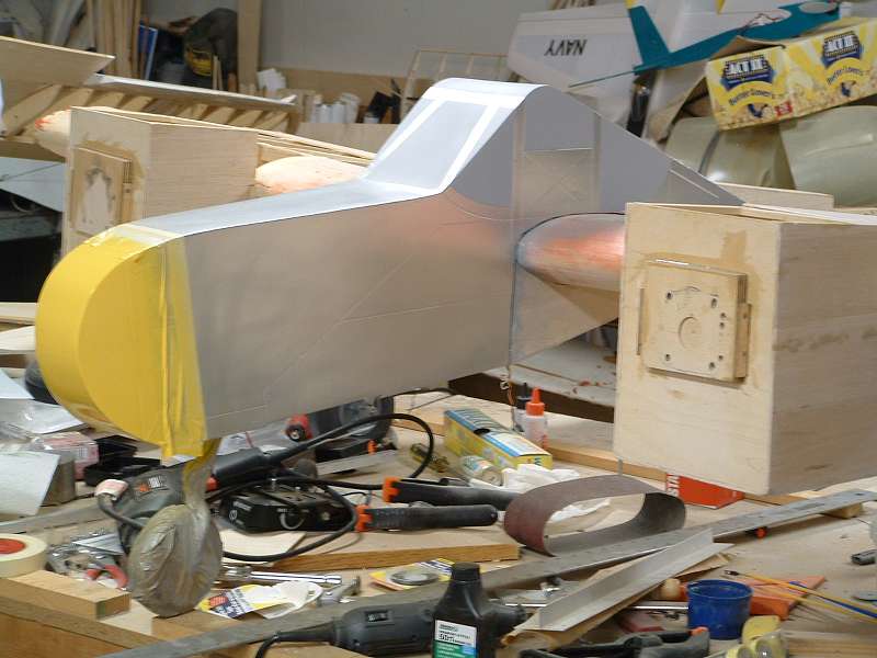

Posts: 482
Default RE: How to Kit Bash to a Twin
A base coat of Aluminum has been applied, some gray for the windows and the yellow nose stripe. Have been going through some photo books of late and not finding a particular subject to duplicate (this is not scale so what does it matter anyway) I have just borrowed from several schemes to paint this. Just trying different techniques I guess.
Old 12-21-2003 | 11:51 AM
  #50
Posts: 482
The anti glare panel has been painted as well as most of the khaki. The aluminum stripe at the front will eventually be painted red. I base coated in aluminum because I wanted to try some weathering however in recent reading I have discovered that P-38's had a black undercoat, lesson learned do research first. Will finish painting the center pod tomorrow and move on to the booms. WHile on the subject of research, does anyone have info on Richard Bong's mount from his flying circus days, this was before he married Marge (I think he was shot down in the plane I'm looking for). I want to use this scheme for my Zirloi
