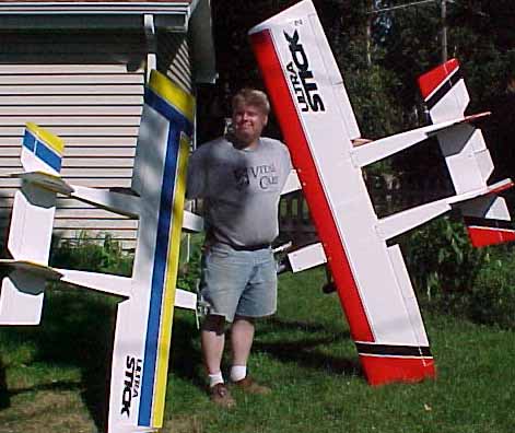

I was glad to see this forum Reguarding Twins and moreso in seeing your write up of The Big stick twin I have a GP big stick 60 Twin fuse design , Hanger 9 Ultra Stick 1.20 & .40 Twins and a Nosen Giant stick W/ twin 3W60's on it All are twin fuse and they all have Excellent single engine preformance. In short this design kept me in flying When I became bored with all else.
I fugure it's time to move on to something else though. Point of intrest is a Large ov-10 or A-10 or a F7F

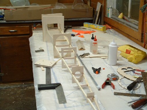

Default gus twin
the humble beginning

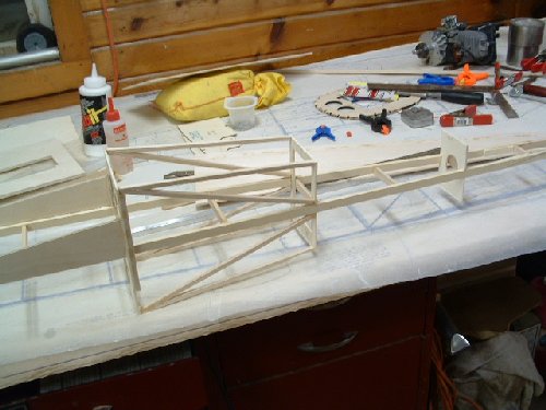

Old 02-16-2003 | 07:27 AM
Posts: 482
From: Central City, IA
Default Gus Twin
simple square fuse, should build fast, don't intend this one to be pretty, primary function is a test platform for equipment and a training model so I can be comfotable flying a twin when I finish my Ziroli P38

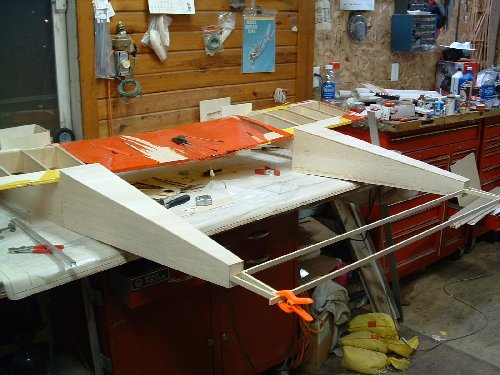

Old 02-16-2003 | 07:39 AM
Posts: 482
Default gus twin
bracing support for the aft section of the boom

Old 02-16-2003 | 07:51 AM
Posts: 482
Default gus twin
starting to look like a twin
Old 02-16-2003 | 07:56 AM
Posts: 482
Default gus twin
last one for tonight. Starting to plan the tail, requires some thinking, that will slow me down. I can finish sheeting boom 2 while I think

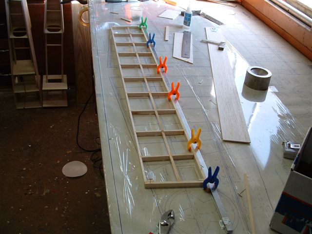

Old 02-17-2003 | 01:20 AM
Posts: 482
Default GUS Twin
Basic framework of the stab

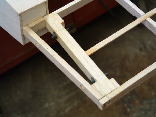

Old 02-17-2003 | 01:28 AM
Posts: 482
Default GUS Twin
Shot of the attaching bolts for the stab, I'm sure that I will have to assemble and dissassemble many times during construction, will probably epoxy in place once construction is finished

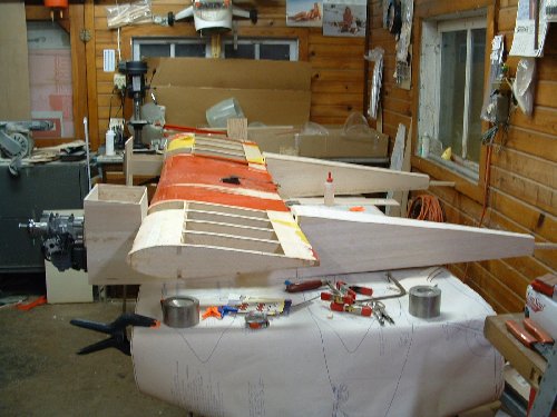

Old 02-17-2003 | 01:37 AM
Posts: 482
Default GUS Twin
Frame work attached and almost ready for sheeting. Blocking for hinges (robart) has been added, lower spar has been installed and hardwood for ballast box installed, and has been sheeted, need to add the preshapped leading edge and some triagle stock to the trailing edge

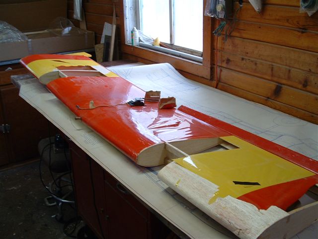

Old 02-21-2003 | 01:31 AM
Posts: 482
Default kit bash twin
don't make much progress during the week. Now have the tail sheeted and the leading edge installed

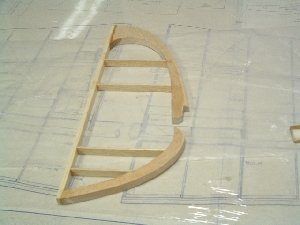

Old 02-24-2003 | 03:11 AM
Posts: 482
Default GUS TWIN
Here are latest photos of work in progress basic parts for vert stab
