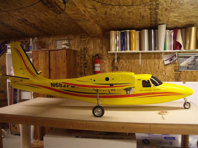

I am just finishing up on a Modaire Aero Commader with twin 50cc's.
Here is my problem, the all up weight is 57lbs. With a wing area of approx 2000 inches, the wing loading calculates to be 65.66oz per square foot.
For all you guys with lots of experience with big multe-engine planes, is this doable or did I just create a giate wall flower?

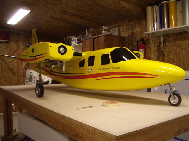

Here is a couple pictures for now...... Will have some better ones shortly. I did have to add 4lbs to the nose for the suggested balance point with the gear up. I do have a few goodies like nose brake and smart fly system but I was very suprised. I used an old UPS scale and weighted the components seperately so it could be off a little. Center section weighted 25lbs, fuselage also weighted 25lbs and each wing panel weighted 3.5lbs for a total of 57lbs...........

I got the plane from a friend who had it professionaly buildt but it was crashed on the maiden. Nose had to be rebuildt, tail snapped off and damage to the wing tubes, etc. I think it was more work rebuiding it than starting over. This may explain the extra weight but I was very careful and actually thought the plane would weight less because I scrapped off and enormous amount of paint and replaced 5 lbs of nicads with li-ion. Original weight was unknown. I think the cause of the first crash was low airspeed combined with a rearward cg. I got ahold of the current manufacturer for the correct cg, thus the 4lbs in the nose. The cg is recommended less than 2" behind the firewall with the wheels up which is several inches forward of the traditional 1/3 of the cord which is where it was balanced before. The plane was completely stripped so I can say that it is a well put together kit.
I can't remember the manufacturer of the main wheels. The nose wheel is a BVM with brake and I use the BVM smooth brake system. I put it on the nose only for simplicity and the fact that I just wanted to keep the plane from rolling on pavement at idle and controlling at slow speeds.

Paul,
Thanks for the pictures. I LOVE the way it's trimmed. I understand that the Aero Commander has a nasty habit of tip stalling when slowed down too much. I've got two of them. One is the 79" version and then The Modaire one. Haven't finished either yet, but both are ongoing projects. I think the Aero Commander is one of the most beautiful airpanes ever designed.
