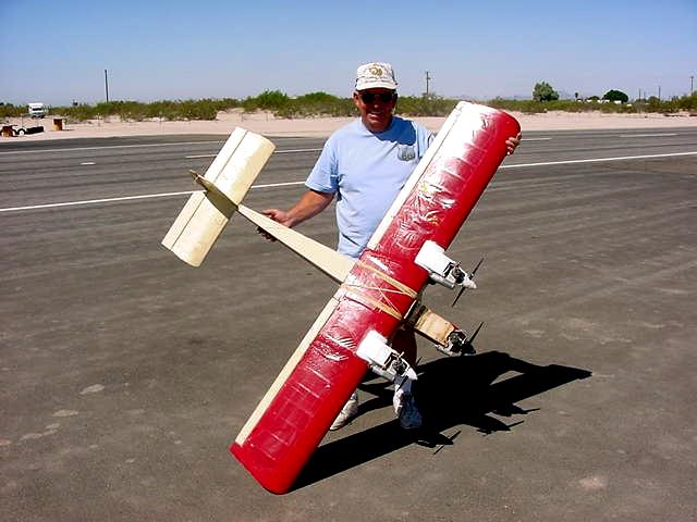

Yup! No doubt about it, a Telemaster 40 will fly with (3) .40's...
I bought a garage sale Telemaster with a Fox .40 in it and decided to do a twin....but first, since the Fox .40 was already installed, I thought why not build nacelles/lay in a pair of LA .40's and not bother to remove the original Fox engine....(1 plus 2 equals 3 engines!!)
And it worked! The little beast rolled about 10 feet and was airborne at a 60 degree climbout angle. Rolls, loops, stall turns, etc and then back into the landing pattern. A couple of slow flybys for the vultures watching and then a landing followed by a return taxi to the pits.
A second hop confirmed that this was really happening.
Technical stuff: nacelles slung under the wing with individual mini throttle servos and individual 6 oz fuel tanks. Tanks and servos are fully serviceable for fine adjustments. Engines are O.S. LA .40's with 10 x 5 props. Aircraft set up as a tail dragger. CG was set 1" behind the leading edge of the wing. 1100 ma power pack.
So there you have it.
The aircraft went back into the shop and I removed the original Fox engine and stripped everything down for a fresh layer of Monocoat and a return to the flight line as a Twin-Telly.
This multi-engine stuff really is fun.

Keep us informed, and please post pics after the recover job.

Thanks for the great observations.
I still (after lots of years) have 10 fingers and have stayed awake at night thinking what all three of those snarling little monsters would do to a couple of them if I got distracted.
I decided that it is just too much hassle to have 3 engines....plus, I mostly did it as a personal dare just to see if I could.
The Telly should be fun and a bunch safer with only 2 engines.

Russ, Delighted to hear of your successful 'triple' flights, like the new colors to. I am sure it will make a fine twin too, it may be a bit more work but you could makes some longer nacelles for the CG thing. Oh another thought since you are going to fill in the nose how about just making it a bunch longer and run the battery all the way forward, The long nose makes them look kinda neat anyway.

Russ What did you use to make your engine pods out of? Can you post a pic of the twin tele's new look. My hat is off to ya. Happy flying! Tim
