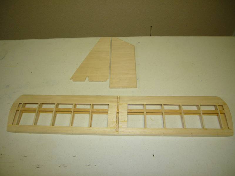

Spent some time building this past week. The TeleTwin is beginning to take shape. I thought I had a Senior Telemaster kit but come to find out all I had was some plans in a box. So I scratched together some extra balsa and begin building the twin. Started with the stab. The stab on my last Tele was one of the weak parts. I beefed up the stab by sheeting the leading and trailing edges and cap stripping the rips. I also built up the elevators instead of using flat stock. I also added 3" to the vertical stab and doubled the rudder size to accomodate better rudder control in the event of a engine out.

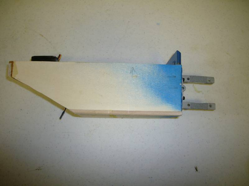

The nacelles are built of 1/8" lite ply with 1/4" ply firewalls. The accomodate a 10 oz tank and the throttle servo. The nacelles are removable and self contained such that I can work on the motor, throttle servo or fuel system without wrestling around with the wing. The nacelles are attached via 3/16" dowels in the leading edge of the wing and a 1/4" nylon bolt in the real of the nacelle that goes up into the wing.

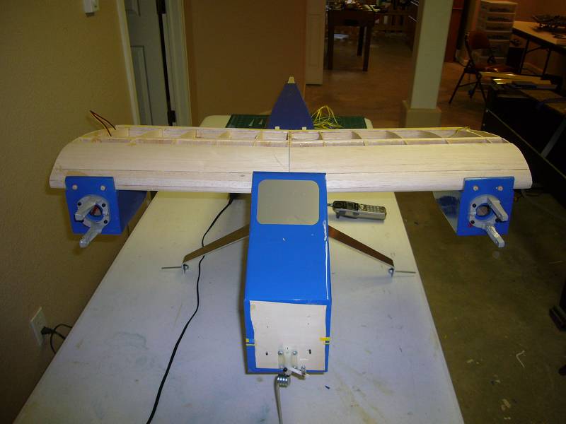

To ease transportation I built a center wing section that mounts to the fuselage via 3/16" dowels in the leading edge with 1/4" nylon bolts in the trailing edge. The center section is 28" wide to accomodate the nacelles and 2" of prop clearance from the side of the fuselage. I took most of the diehdral out of the wing. I used 1 degree of diehdral on each side when building the center section. This section is built up from the original plans by using 3/32" sheeting and doubled up spars. 1/8" shear webbing was installed front and back of the spar. The wing halfs were joined using a 1/2" x 3/4" ply joiner that was 16" long. The nacelle area has a 1/4" ply plate where the nacelle bolts to the wing.
The sheeting is not complete in this pictures but does give you an idea of how this section is contructed.

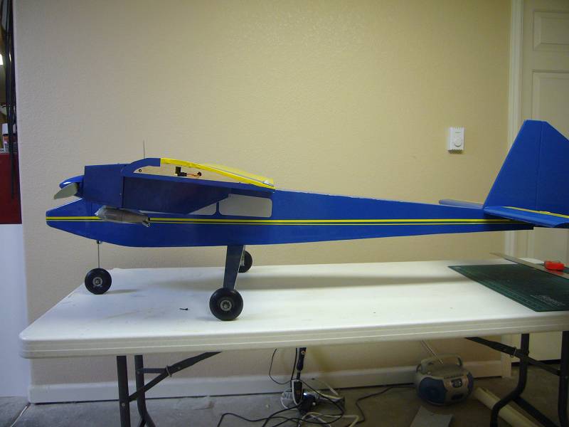

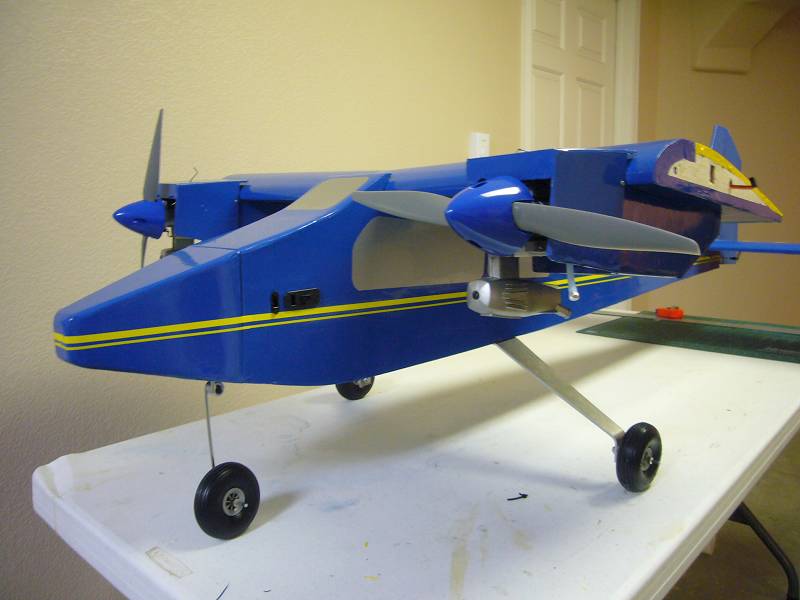

The TwinTele continues to take shape. Fuselage is complete, center wing section, nacelles, and all electronics are complete. Nose wheel seems weak, may need to replace that with a more robust setup. Installed a Sullivan glow driver and mounted batteries in the nose section to achieve a reasonable balance prior to the remaining wing section being added.

looks outstanding JB. If the nose wheel proves troublesome try a Fults type. I have one on my Quad Kaydet and it works well: http://www3.towerhobbies.com/cgi-bin...=RF&search3=Go

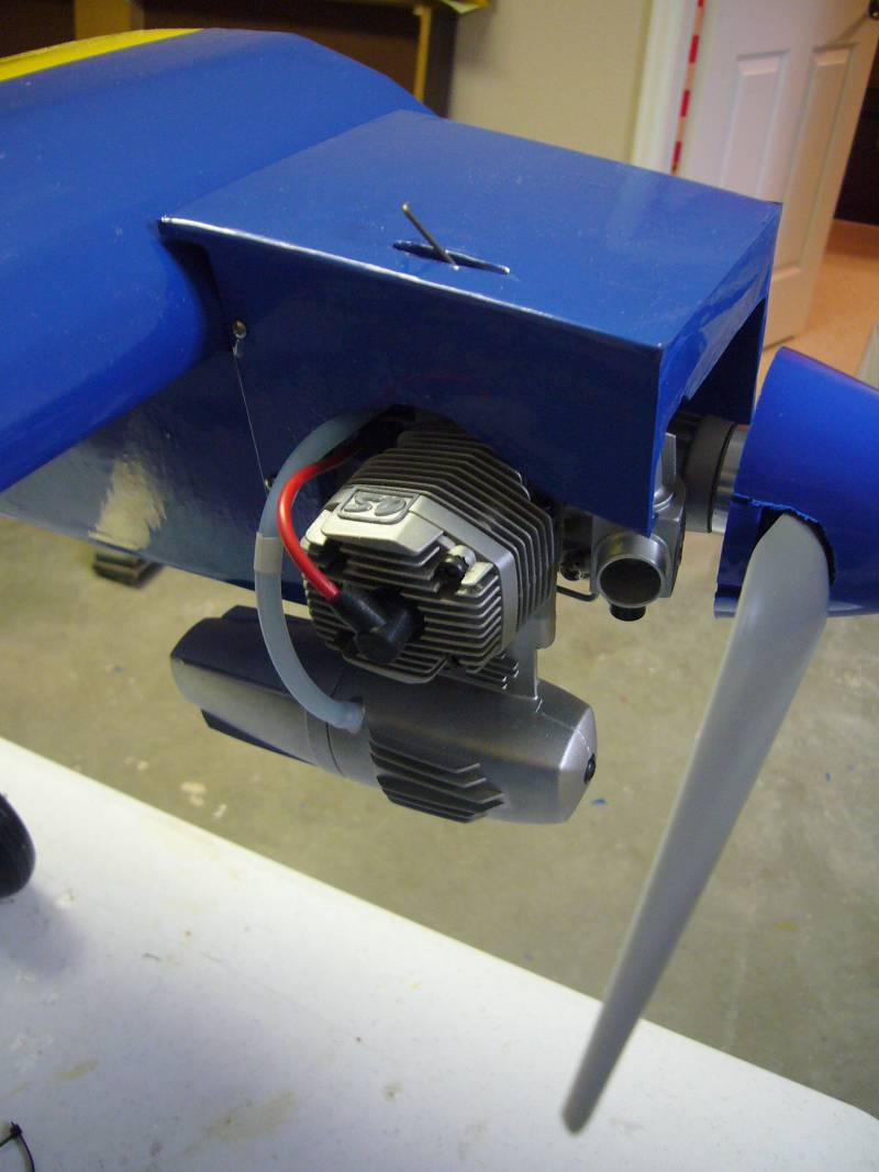

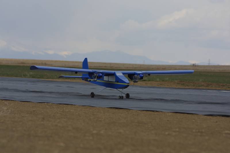

Got a break in the weather and took the TeleTwin for a test drive. Flew better than I expected. Way more power than it needed (even at my 5k foot altitude). Single engine performance was excellent. A little rudder, reduced throttle and no problem getting back to the field for a smooth landing.
