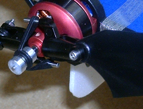

Here are a few picts of my set-up.
ID:	299813   Click image for larger version
ID:	299814   Click image for larger version
ID:	299815   Click image for larger version
Old 07-21-2005 | 03:44 PM
Posts: 230
From: Bakersfield, CA
Default RE: Anyone flying the OMP Variable pitch unit yet?
ckoerner:
You have the pitch slider attached to the trailing edge of the blade holder as shown on Ikarus website, yet the exploded view in the instructions show it attached to the leading edge. I wonder if they show it both ways because it makes no difference or is one way better? I assembled my just opposite of yours, it works OK but now I concerned I have it backwards.
ID:	299917   Click image for larger version
Old 07-21-2005 | 03:54 PM
ckoerner's Avatar
Posts: 429
From: Crest Hill, IL
I didn't notice that. You would get more positive pitch the way you have it.
Old 07-21-2005 | 04:19 PM
JohnVH's Avatar
My Feedback: (38)
Posts: 16,179
Received 10 Likes on 8 Posts
From: Ferndale, WA
Well, I flipped mine, and didnt have enough positive pitch to climb out.... Went back to origional setup with little negative.. Got to design a new pitch slider that allows enough negative pitch yet giving enough positive...
Old 07-21-2005 | 04:24 PM
ckoerner's Avatar
Posts: 429
The way mine is now, I get a lot of negative and a little positive.
