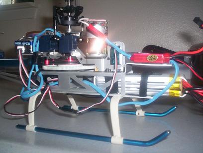

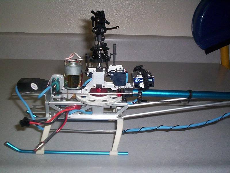

hello I have a new df60 with 1800mah lipo (brushless is on the to buy list but not for a while). anyway i am having problems trying to hover, i cant get this heli over 2 feet in the air. I have the pitch set at 4 deg at half and 9 deg at full stick, my throttle curve is set to max out at approx 80% stick. everything seems fine but the heli just won't go up. I was wondering if this is a common problem with the df60 it seems to just be uderpowered. so any help would be great.

Your too heavy simply put.
Get a brushless system, and get rid of all those cable tubing too/ the weight adds up.
make you unit light as possible.. Check your main blade pitch angle using the proper tool.

It's because you're at 4000+ feet. You probably don't stand a chance without the brushless motor.

Absolutely! Add in the 100 degree weather we've been having and your density altitude is over 7500'. Trust me, these electric heli's weren't designed to fly 7500' high. I'm in Reno and I've yet to get my 22E to hover out of ground effect. I'm about ready to give up. The only thing left for me to try is a LiPo. I hate to keep throwing money at this thing with no guarantee it will ever fly at Reno's altitude. You have to make it as light and as powerful as possible to have any hope, or take it to SF.

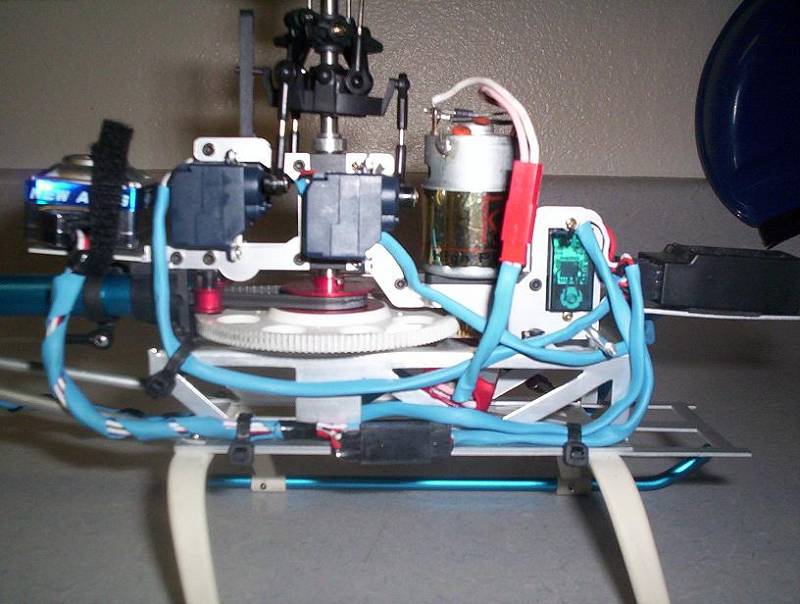

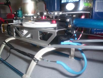

Sinse my bird is down right now I took the time to reroute the electrical system, the reciever is now all the way in the back inside the frame, I've tested it and it seems to be rock solid. I don't even get those little quivers in the servos anymore. I ran two batteries through it now and so far so good NO GLITCHES. take a look. just a little cleaning up to do now.

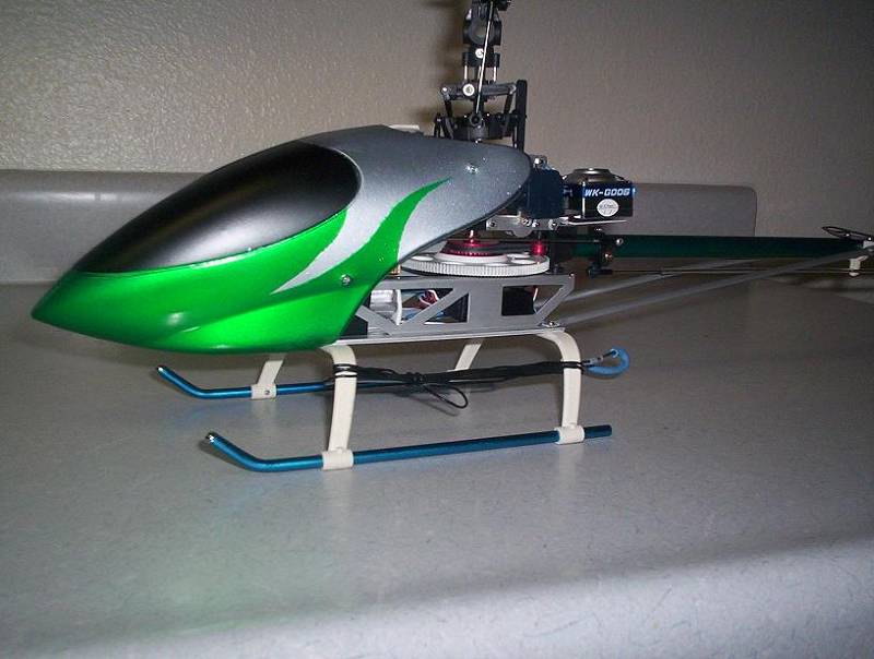

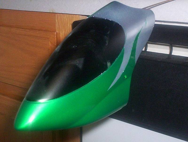

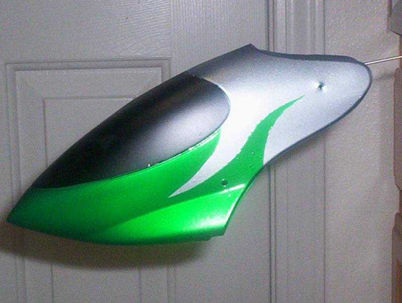

thank you soneebee for that info I will keep you posted if the main blades 315mm will fit. In the meantime i finished my canopy tell me what you think (not bad for a spray can job is it).
anyway im thinking of getting an align 430L brushless motor but should i get the 3550kv or the 4050kv and what is the differnce?
also should i get the align 25a esc or the 35a esc for this motor what are the advantages disadvantages of each... thanks
oh and does anyone know if i need to buy the pinion gear and conectors seperatly? or do they come with it?

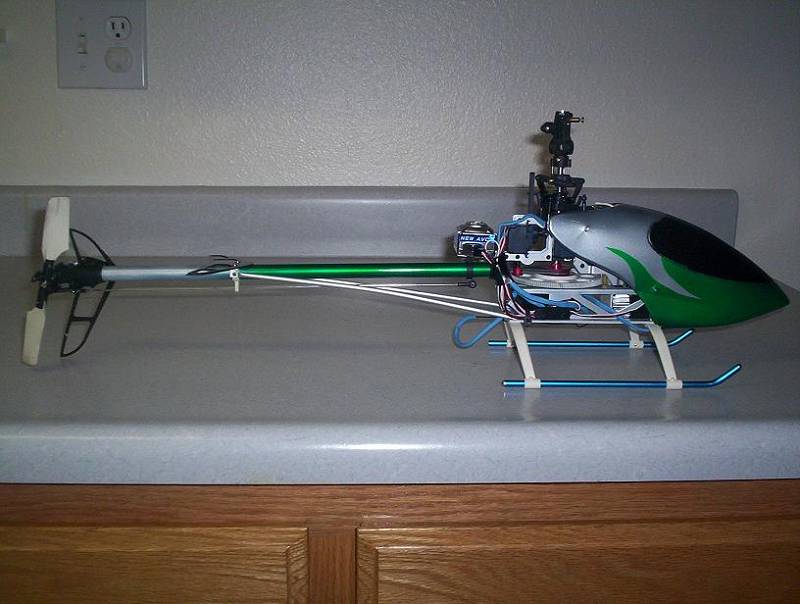

here is the rest of my heli with matching boom.
