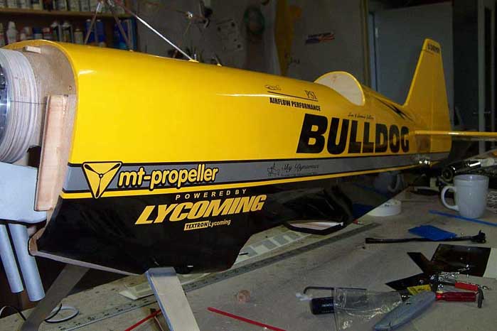

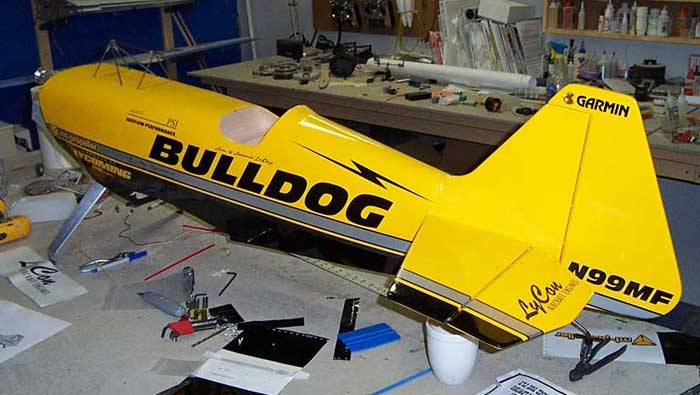

here's one of those custom builds almost done... a 69.5" Pitts Challenger III...
ID:	61413   Click image for larger version
