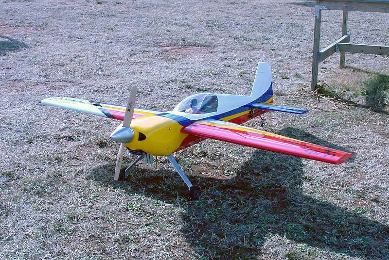

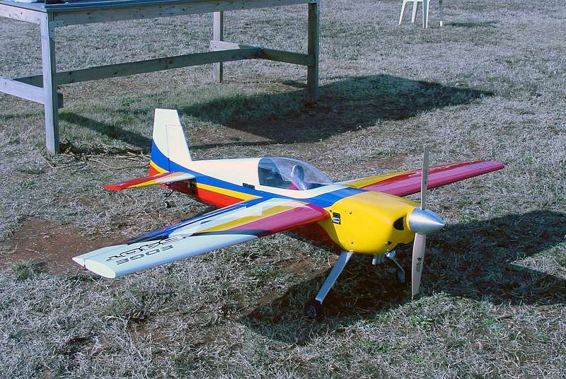

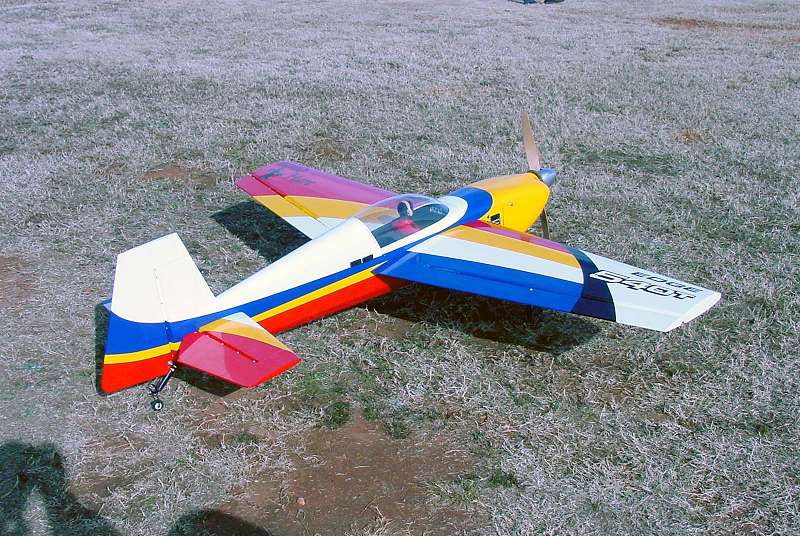

I have some pictures and video that is not very good. I used a camera I didn't know how to use and the pictures do not do this plane justice. Put in 4 flights on one tank of fuel! 32oz goes a long way! If there are any mpg gurus out there, can you enhance the video?
I out in 4 flights and found this plane to be very responsive and can fly VERY slow. A couple of people walked up to me and wanted to know how I made a plane this big fly so slow. I told them I had a excellent builder, Thanks Tom!
http://www.geistware.com/rcmodeling/.../Slow_Pass.MPG
http://www.geistware.com/rcmodeling/...le/Landing.MPG
As I said, the picture is very blue. If someone can fix it I would appreciate it. I will try to shoot a better video when I get a better camera.

Ok, we have a winner in the "First in the air" contest. I can breathe now.
Good job.
BTW doesn't Viagra make everything appear blue?

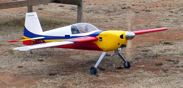

OK, after 7 flights I think I am in love.
The plane flies good at slow and moderate speeds.
I am finding that I need to add some additional right thrust to keep the plane flying at full throttle. Inverted flight is very stable and slow rolls are very axial. With the application of rudder (30 degrees), no aileron input is needed and only very little elevator is needed to compensate for pitch coupling. Stalls are difficult because the plane continues to fly at amazingly slow speeds. When the plane does stall the heavy wing (left) does drop first. I still have not balanced the plane laterially but I have checked and the left wing is heavy.
The links below were recorded with a digital camera. I don't have access to a video recorder so please accept this as an example of my first few flights.

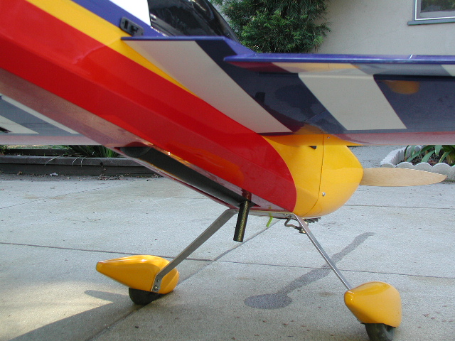

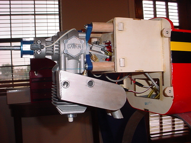

Greg,
Look around in this forum, Gas engines, and Giant Scale and WildHare, and you'll find a little info. I have this engine (mvvs58i) in the WH Edge, with a header and a large JMB can. For run in I'm using a ZingerPro24x10, and it swings the snot out of that prop. After run in I have no doubts it will swing a 26x10 or 27x8 or perhaps even larger load. I am running a very large and free flowing exhaust system, but it is still very quiet.

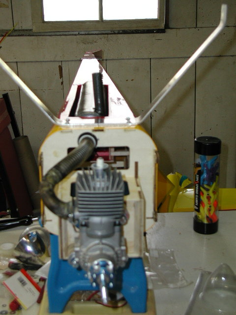

The MVVS 58 is indeed real. I flew it with a 3w 24-10, which was laying around and left over from my 3w75. I did not have a tach with me but the engine sounds very similar to that 3w 75 in power/rpm. For such a small engine it does an excellent job with that big prop.
I am using a fairly restrictive Bisson wraparound muffler which is definitely holding the engine back. With a decent header /canister setup it would make more power and less noise. But for a plane of this size it's still way plenty of power. I don't think I used full throttle at all.
I am flying this engine on a prototype of the new Extra 300L so the balance issue is not the same as the Edge, but overall weight is about the same. The MVVS 58 is about 1 pound heavier than a DA-50, which is no big deal on a plane with 1350+ in. sq. wing.
The engine is very well behaved, idles nicely, starts very easily, is reliable and responsive, and generally easy to live with. I don't know if we'll be selling them, it depends on the US distributor.
Speaking of engine weight, I think Geistware might have less issue with the right thrust if he would try a little more forward CG. I found flying IMAC that the Edge is much better about holding lines with a little more weight on the nose. I added 4 oz. to my DA-50 setup and it made a huge difference.
