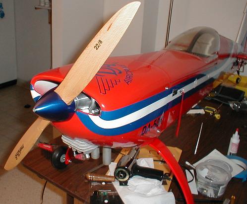

Radio: Futaba 9C
Servos: 5 JR 8611's, 2 Hitec 5475's (Throttle and Choke)
Reciever: Futaba DP148 PCM
Connections:
1- Right aileron
2- Right Elevator
3- Throttle
4- Rudder
5- Choke
6- Left aileron
7- Battery
8- Left Elevator
Servo Horns: SWB Double Lock 1.5" ail/elv 1.5" double rudder
Battery: 1 Fromeco 2200Mha for servos 1 1200 Mha for ignition
Regulator: 1 Fromeco 6v, 1 Fromeco Reliaswitch
Engine: DA 50
Mount: Custom 3.5" Standoffs (Anodized Red)
Prop: Menz 22x8
Spinner: Tru-Turn custom Anodized Blue (matches PERFECT)
Tank: Dubro 20oz gas converted
Oil: Amsoil 100 to 1 Synthetic
Switches: 1 Maxx Heavy Duty, 1 Fromeco Reliaswitch
Wingtube: Aluminum
Stab tube: Carbon fiber troy built models
Tailwheel bracket: Stock
Main gear: Wild Hare Fiberglass
Main wheels: Kavan 3.5" Tires(3 oz less than dubro)
Instrument Panel: None
Pilot: . None
Wingbags: On Order
Hardware: Rocket city/nelson---DHS Kevlar Pull-pull on rudder
Decals: Desert Aircraft, Fromeco, JR (all custom reflective)
Have not sealed the gaps yet...
Also, Is it assembled? What was your final weight?
My Feedback: (21)
Posts: 948
From: Alexandria, VA
Bought the spinner right from Tru-Turn. Guy on here (cannot remember his name) polished it and anodized it for me. He has done a bunch of things for me over the past couple years (Landing gear & Spinners)..
My Feedback: (21)
Posts: 948
I think it was like $15 shipped to me...His name is Tim Wiltse. Don't have any other contact info right now, but is nick on here is his name.

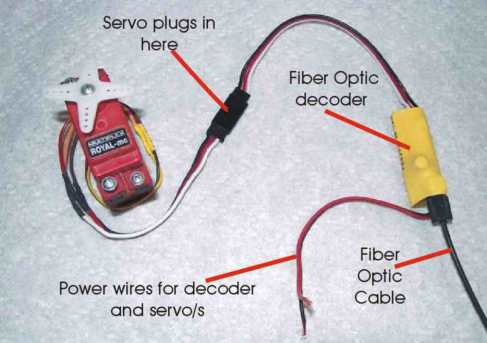

Throttle/choke servos are powered from the ignition battery and use fiber optic extensions for the signals from the RX
