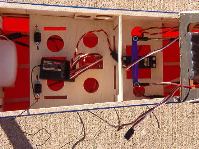

Should I run the pull pull wires straight back to the rudder or cross them?
This is on a 540 edge 28%

I run them straight.

Definately run them straight, with the 3" servo arm from airwild the cables will align perfectly you do not want to cross them because of possible hang ups and in some cases with the the raw cables (there are some with a plastic coating) radio interference has been reported

I crossed mine. It makes no difference at all one way or the other. If you cross them all you have to do is put one of the top of the arm and the other on the bottom and they never rub nor touch. I see no advantage/disadvantage to doing it either way.

I crossed mine as well, moves the exit point further back in the fuse. I made a small mod for the elevator servos to get better linkage geometry so I also used the lower hole in the rudder hardpoint for the pull-pull arm which gave plenty of clearance between the bottom of the elevator servos and the exiting rudder cables. As was stated in the last post, all you have to do to eliminate and cable-cable interference at the X in the fuse is mount one cable on top of the 3" rudder arm and the other on the bottom. This gives about 1/4" between the cables with no worry of rubbing or touching. I have pics if my setup too if it would help, just let me know.

The fuse slots are cut for straight cables. If you cross them you'll need to cut new slots.

What size arm do you need to use and which slot does the servo need to be in for the cables to run straight? I was planning on using a 2.25" full size arm from SWB on a JR 8611.

The air wild arm that Tom supply's is 3". works as advertised with straght wires. I placed the servo in the rear slot on the radio tray.

FWIW, I had mine crossed and took it apart and put them straight. I did this based on everyones input here. Thanks.
