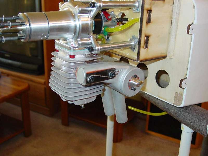

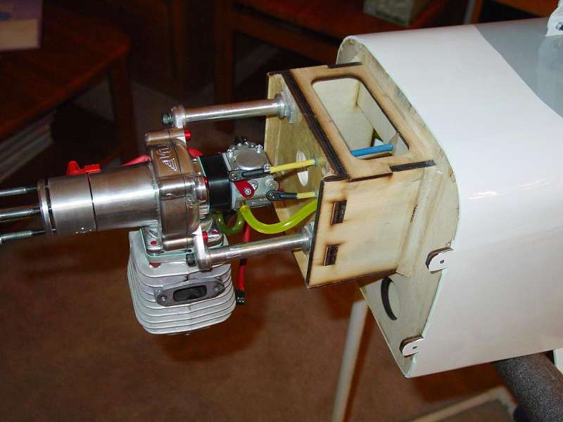

Old 05-28-2005 | 12:07 PM
Ken Bryant's Avatar
My Feedback: (10)
Posts: 1,493
Received 18 Likes on 15 Posts
From: Surprise, AZ
Default RE: Stand-off length
I took some 1/8" aluminium and cut it up to make up my missing 1/4"
