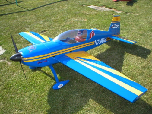

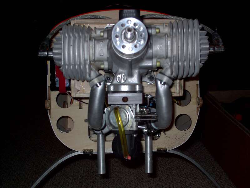

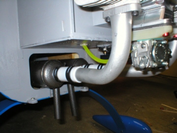

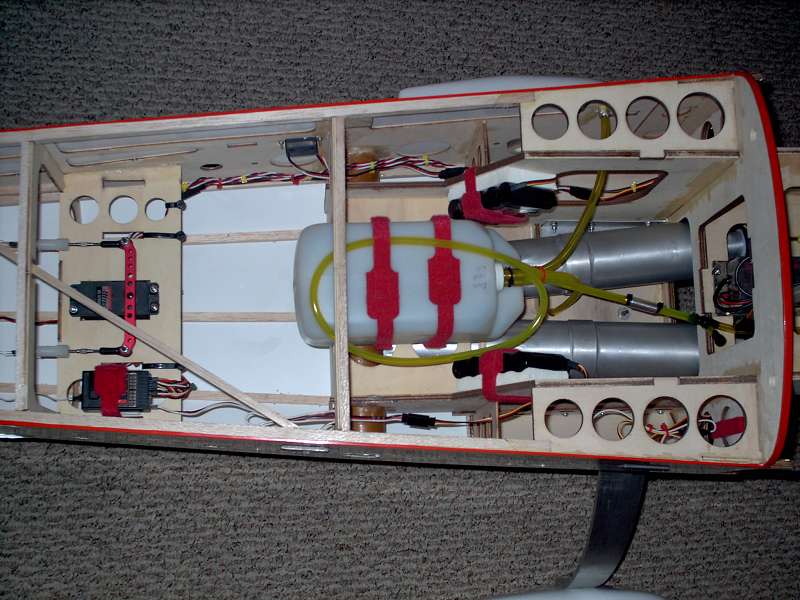

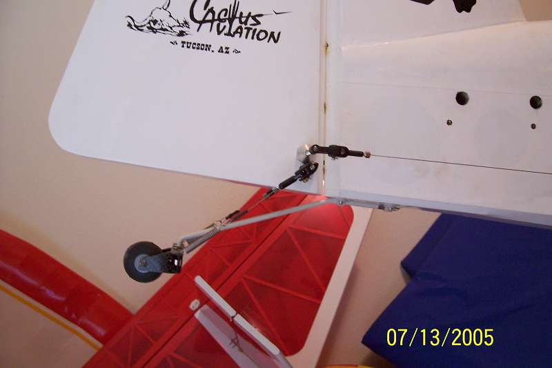

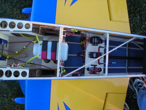

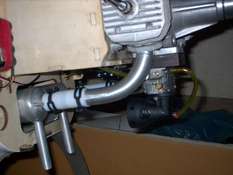

Perry,
Don't know if this will be of any help or not, but I've got the 330LX with a 3W-100 on cans.
For the hardware I used what Tom sent along with the plane, plus some personal upgrades.
The R/C Blimp CF tail gear, Air Wild cable fittings, SWB cable tensioners, MLP / SWB arms,
& MPI charge switches. No added weight to balance, batts in forward position.
Used all HiTec servos, for the programability(?). No Match boxes to add weight and cost.

Flier:
Great minds think alike, that looks almost identical to the one I flew 2 years ago exceot mine was a DA with 3w mufflers instead of a 3w with DA mufflers.
The only thing I would add is two more vent holes on the bottom in front of the two that are there to cool the front of the mufflers and also allow more vent air so the inside does not get hot after shutoff. I don't know if it's absolutely necessary but mine seemes cooler all around with more vents.
Nice plane.
TF

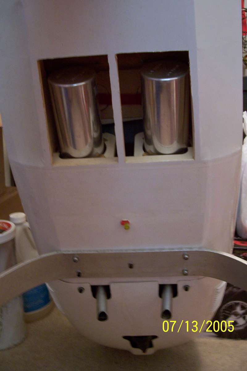

I'm flying the same set up with a DA and JMB cans. I added a tunnel.
Love the plane and the service.

T. Bob has the right idea. Completely enclose the cans off from the inside of the plane because you don't want the heat going inside the fuse. Plus you will get much better cooling by forcing all that air out the bottom of the fuse. I also intend to close off the fuse with 1/16" or thinner balsa from the engine area, again to keep the hot air out.
I intend to start assembly this weekend (HINT HINT ..... TOM ???) providing my plane comes in. It will be several weeks before I get it in the air because all my servos have to go to Horizon for a check up. I might even send in the 10X for a tune-up while I'm at it.

On my Rabbits, I glued a piece of i/4" ply at the bottom center of the large hole
under the motor box. Drill a hole in the small ply piece to exit your vent gas line.
Then Monokote/Ultracote the large opening.. Less weight, for those who are weight
sensitive..
Gerald
