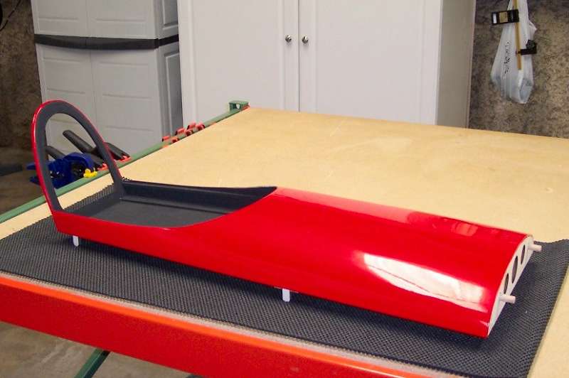

Well today I looked over everything and became familiar with the supplied hardware. I took the cowl deck and eliminated the wrinkles and also I found some stuff made by Novus that I bought at the local Harley dealer to take the dullness/scratches off Ultracote to my surprise. I know I am a picky pain in the ___. Also if you look at the front alignment pins you will notice at how loose these things are so I went to the local hardware store and bought some push in nylon bushings that will work perfect to snug the deck up. Take a look! More later . . .
Perry

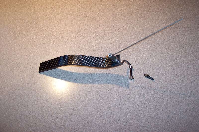

Here is a pic of the Aircraft International CF Tailwheel that will go on the Extra 330. No springs!
Mounts using a 4-40 threaded rod that screws into the ball link so the rod can slide fore and aft.
Perry

kinda like the sullivan, just more "high speed low drag"... until you have a couple hard landings and the rod gets bent.
Tim

The thing I like about the setup is if you ever bend the wire just backoff the set screw and replace. It would take one hard hit to bend this thing.
Perry

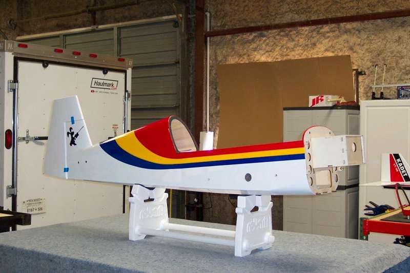

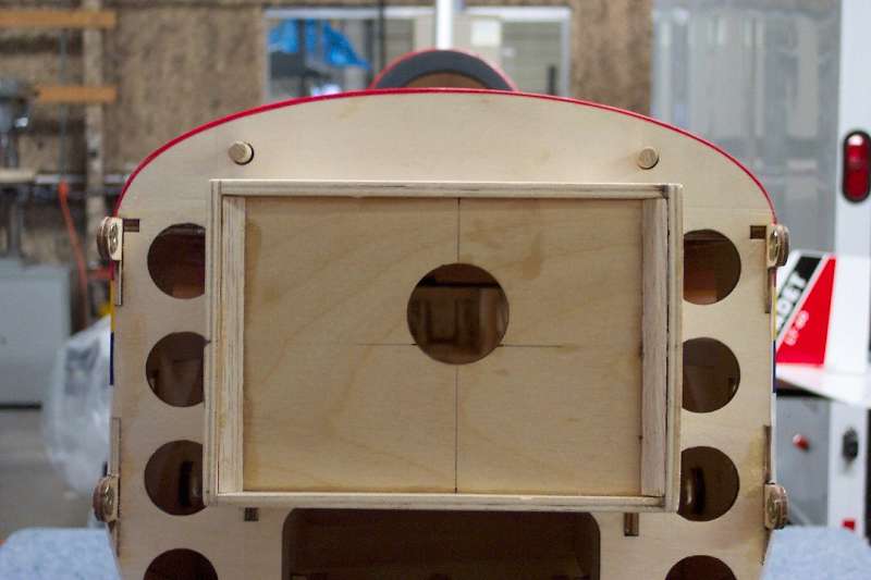

I'll try not to duplicate any of Perry's photos. Here is a few pics right out of the box. Notice the top and bottom photos of the elevator. It looks like who ever put the parts together did it opposite of what it should be. The blue and yellow stripes should go on the top and the two blue stripes should go on the bottom which match the wing scheme. That is not the way the two halves came out of the box. I tested the fit and both elevator halves will interchange, so when I do the final assembly I'll put the two blue stripes on the bottom to match the wings.

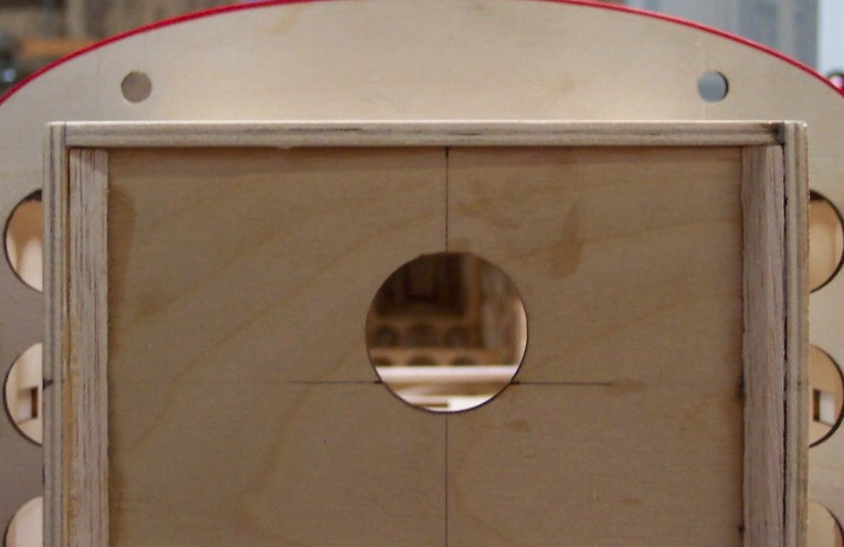

(1) Emphasize to the people who put these planes together the importance of not getting glue in the blind nuts. Every one on the blind nuts on my plane were filled with glue. What a PITA to drill it out and then run a tap through the hole. The four in the wings were the worst of the bunch.
(2) Anodize and seal the wing and stab tubes. Bare aluminum is messy to handle and it gets all over the plane. Fortunately I have to ability to do this at work.

Well I'm finally starting to get into putting this model together. I polished all three bare aluminum tubes and anodized them black. I also brushed finished the landing gear and anodized it black. Everything came out looking great.
I figured I finish off the landing gear by mounting the wheel pants and mounting the gear to the airframe. I already had pre-fit the landing gear to the airframe before I had it anodized. Thankfully I had not glued the wood mounts into the pants yet. The pilot dots on the wheel pants match the holes drilled in the landing gear but the holes in the wood mounts are so far off it looks like a blind man drilled the holes. The two lower holes on both wood mounts are way off, he must have been blind in both eyes. I had already glued the blind nut in the holes and when I tried to remove them....... well lets say I'll have to make two new ones. At least the holes will be drilled correctly.
I have almost finished the canopy. I have trimmed and shaped the clear plastic, and put in blocks behind the fifty #2 wood screws I used . I changed the black interior to stone gray and I have not decided if I’m going to put in a pilot and dash. I'll post some picks of the tubes, landing gear, and canopy in a day or two.
