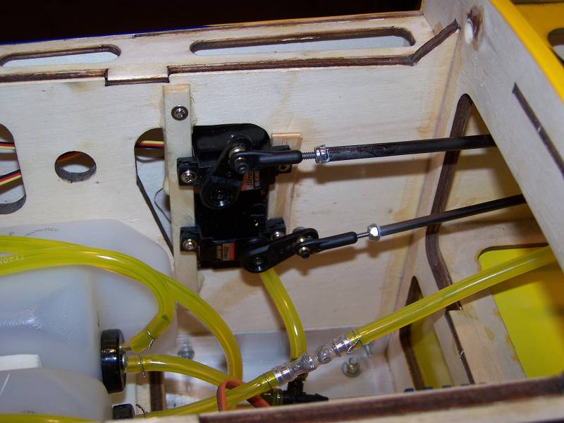

First try to avoid using metal pushrods that goes from the engine to the servos,,,, I use the Sullivan Semiflex Gold-N-Rod with a Dubro ball-link on the engine arms and dubro kuick-link on the servo arm here the link for the pushrod.
Sullivan Semiflex Gold-N-Rod w/Gold-N-Clevises 36" (2) http://www2.towerhobbies.com/cgi-bin...?&I=LXFU92&P=7
and here are some pics of my setup... I hope this helps!!!!

charrua
that is a good looking set-up!

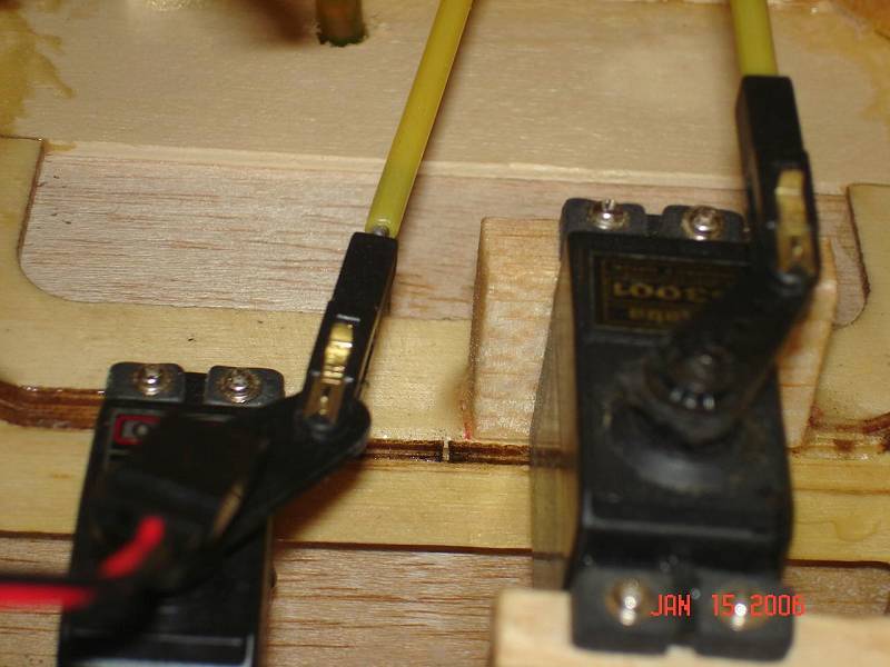

Here's my Edge and 300LX
I moved the servos back to near the wing tube on my Edge so that it would be less nose heavy.

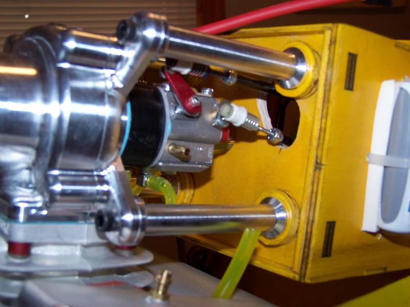

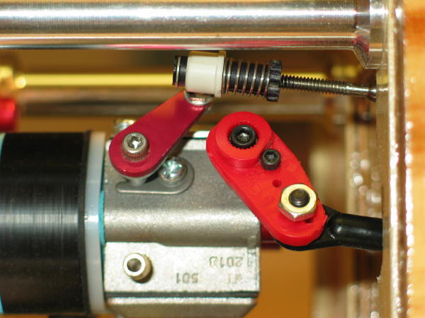

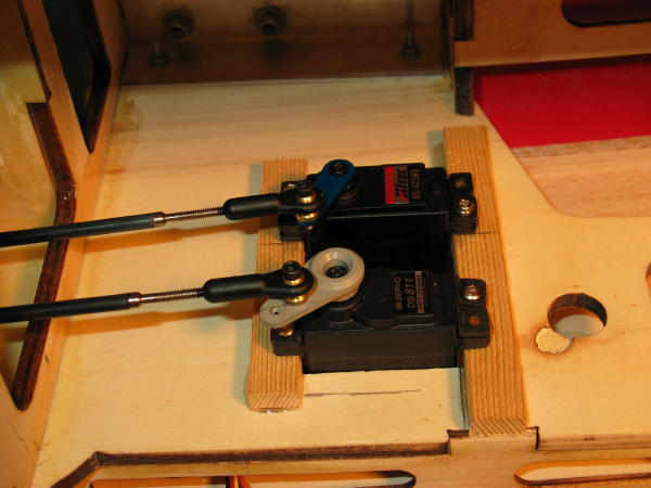

OK guys, I just finished the throttle and choke linkages on the Edge/DA50 and below are some photos. The lever that I added to the choke lever is made from a Hitec servo arm. I drilled and tapped the choke shaft to a 2-56 thread the way DA/Walbro does it on the throttle shaft. There was no grinding the old lever off as you can see. I used the old choke lever to help lock the Hitec arm in place. It worked out very well if I do say so myself sm=tongue.gif] ! The push rods move very smoothly with no binding and as you can see they are aligned very well without excessive angles to the carburetor attachment points. I do have a few other photos or if anyone would like a specific photo just let me know.
Monte, The pushrods are 4-40 and all the ball links are attached with 4-40 screws. The only thing that is 2-56 is the ball that came with the Sullivan "Locking Sleeve Ball Joint" but they sell a 4-40. If I can find one locally I may change to the 4-40 but for a throttle linkage I think the 2-56 will be fine. Do any of you feel the 2-56 stud on the Sullivan "Locking Sleeve Ball Joint" is not good enough?

For those interested, Dubro sells a ball link with the name something like 2-56 ball link for 4-40 threaded rod. You don't have to enlarge or re-tap any holes that way.
Also, for those using a Brison 3.2, you can cut a hole in the right side of the engine box and mount the throttle servo there with very short and very straight linkage. The servo arm may have to be inside the box. No big deal. You will likely have to install the throttle servo in the tail to offset the weight of the servo in the nose. Placing the ignition battery in the engine box and the flight battery on the servo tray and all balances at or near 3.5 inches on the 28% Extras.
There's some really nice looking work taking place in this thread guys.
