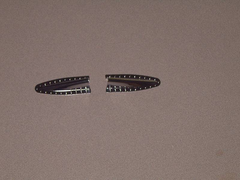

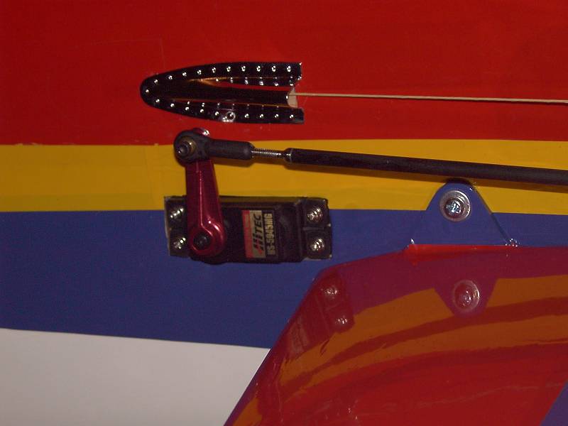

Well, I got my linkage exit covers today and installed them. What do you guys think?

Old 01-19-2006 | 11:17 PM
Joined: Feb 2003
Posts: 479
From: pleasant prairie, WI
Default RE: Pull-Pull Wire Holes
Ben those sure look nice. Who is the manufacturer? I'm just going to go with the open slot. I used some ideas from a couple of you guys. I cut the bottom covering off my Edge and drilled the two holes. I also lengthened the slot back to the plywood doubler. I think I could have done it like Jaketab but I wanted to get to the back of the fuse anyway so I could secure an antenna tube on the inside. I did not use the tubing for the pull-pull wire like you did Ben because the wire seamed to drag a little. Lengthening the slot gave the cable a little more free movement. I'm going to try to send some pics of my handywork in my next email. I tried earlier but it didn't work. Then I had to go to the flying field because it was 40+ degrees today so I got in a couple of flights on my beater stick plane. I will start to send them as soon as I post this reply so if they don't show up at least this message made it okay. If the pics don't show maybe someone can tell me what I'm doing wrong. Bill

I got those covers from Cactus Aviation. It started snowing here today, but it didn't stick to the roads which may mean the runway is still clear which means maybe Saturday afternoon when it's in the 40's I'll be able to get out there.

Ben thoes look sharp! Cant wait to see them in person next time Im home.
