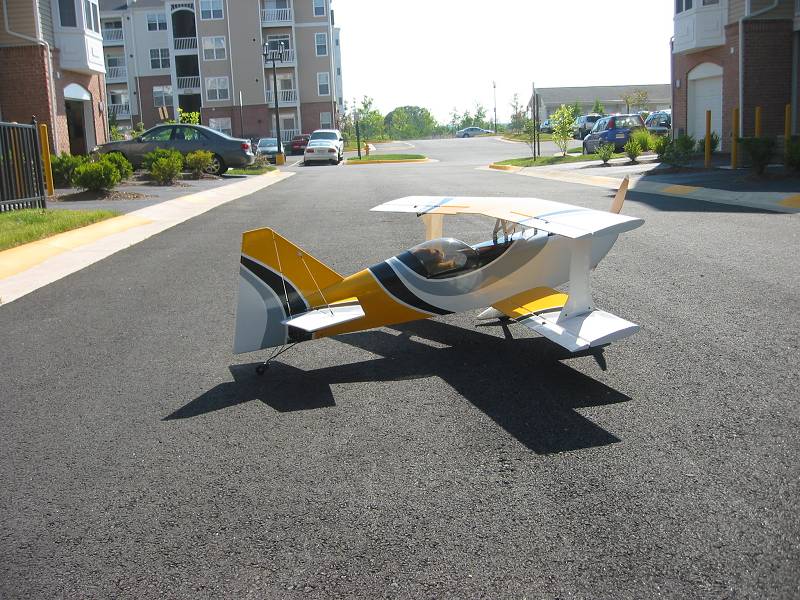

Have had trouble posting the last couple of times...trying again. Almost done - just need to balance and set the control throws. Been thinking how to balance it since I am on my own...

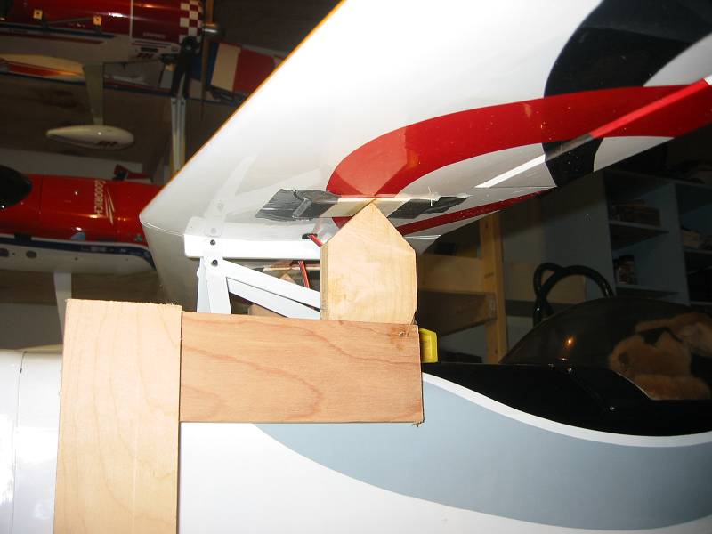

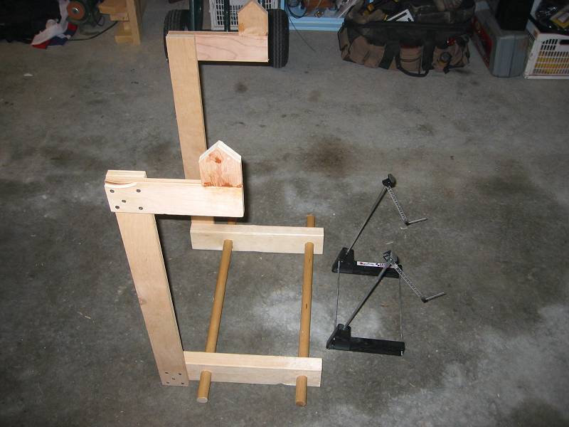

I found an article in the September 2005 Model Airplane News about a homemade balancer technique suitable for large aircraft...had some scraps of wood laying around...

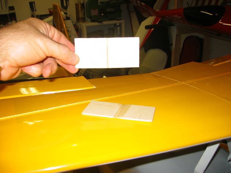

The points of the balancer pivots touch the plane via two lite ply "pads" that are taped to the wing on the desired balance points...the MAN article talked about cutting a groove in the lite ply for the point of the balancer to rest in...I reinforced the groove with thin CA. In actual use, it seems to work fine with and without the groove.

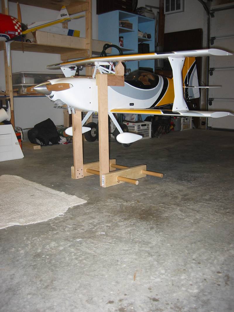

The c/g will come out behind the main gear, so... . Find a table that you can set the plane on while hanging the main gear over the edge. Get a piece of 2" pvc pipe about 3 feet long or so. Make a mark on the bottom edge of the fuselage where you want the c/g to be. Set the fuselage on the pvc pipe, 90 degrees to the pipe, hanging the main gear over the table, and not letting the tail wheel touch the table. Don't forget to place a wedge in front and in back of the pipe so it won't roll!! See where the plane balances in relationship to the marks on the bottom of he fuselage and add or subtract weight from there to hit the mark. Sounds complicated but it's actually very easy.

Looks something like this when it is in use...

And another shot.
