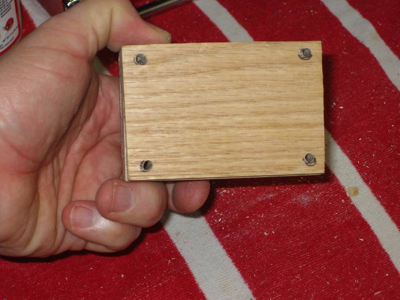

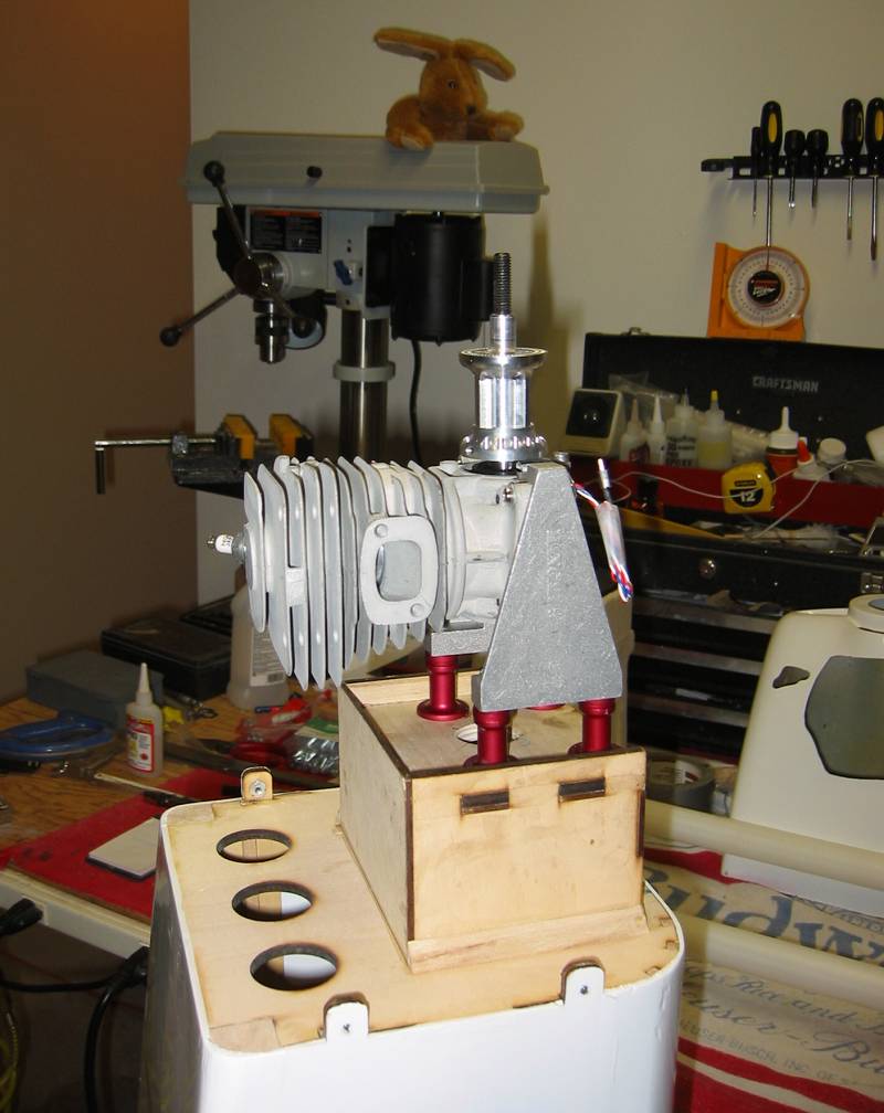

The engine mounting instructions in the manual work just fine for the BME - I made up a stand off block and mounted the BME to the Hanger 9 mounts and attached it to the standoff block.
This method allowed the engine to be positioned to match the spinner backplate centered on the cowl. I then removed the cowl, removed the engine and the hanger 9 mount, while leaving the standoff block in place.
Just like Tom's instructions said, the standoff block made an ideal drill guide to drill the holes for the blindnuts.

Old 03-26-2006 | 08:32 PM
tomriddle's Avatar
Joined: Aug 2004
Posts: 357
From: Woodbridge, VA
Default RE: BME 50 Wildhare Ultimate Build Thread
My standoff block was 1 7/16" but the resulting gap between the spinner backplate was too much - no worries - the Hanger 9 mount is slotted and it is an easy operation to make minor adjustments to the location of the BME by adjusting the engine bolt locations.
I used the 1" - 1 7/16" SWB Manufacturing standoffs to get the optimum positioning of the engine on the Hanger 9 mount. The standoffs come with 3 spacers and you use the ones you need.
A drop or two of epoxy (or medium CA) on the inside of the cowl around the bolt holes proved to be very useful to ensure the holes did not get enlarged during the process of installing and removing the cowl multiple times. This is important as the position of the cowl is how the location of the engine and spinner backplate is determined.
Also, be very sure that all 4 bolts are used to fix the cowl in place - the cowl is flexible and not using all four bolts can throw things off during the cowl cutting and engine mounting process.

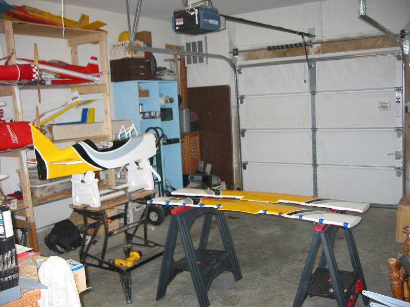

Old 04-02-2006 | 11:13 AM
tomriddle's Avatar
Joined: Aug 2004
Posts: 357
Wing assembly delayed by having to earn the daily bread - grrr...time to apply for that full-time R/C model assemblers position...
Assembling the top wing first. Instructions are straight-forward; dry fit first, practice clamping method, dampen surfaces to be joined; spread Gorilla glue, clamp (I'm using a combination of a small ratchet strap bought at Home Depot, a larger clamp and some catalogs to keep the wing flat as the glue drys. Check the joints periodically as some gorilla glue does foam out - a quick wipe with a rag dampened in acetone takes care of this just as advertised.

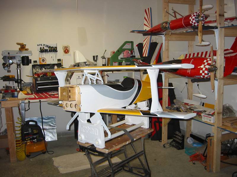

Sorry for the confusion - I took the engine off to make the fuse easier to move around and to fuel proof the firewall.
v/r
tom

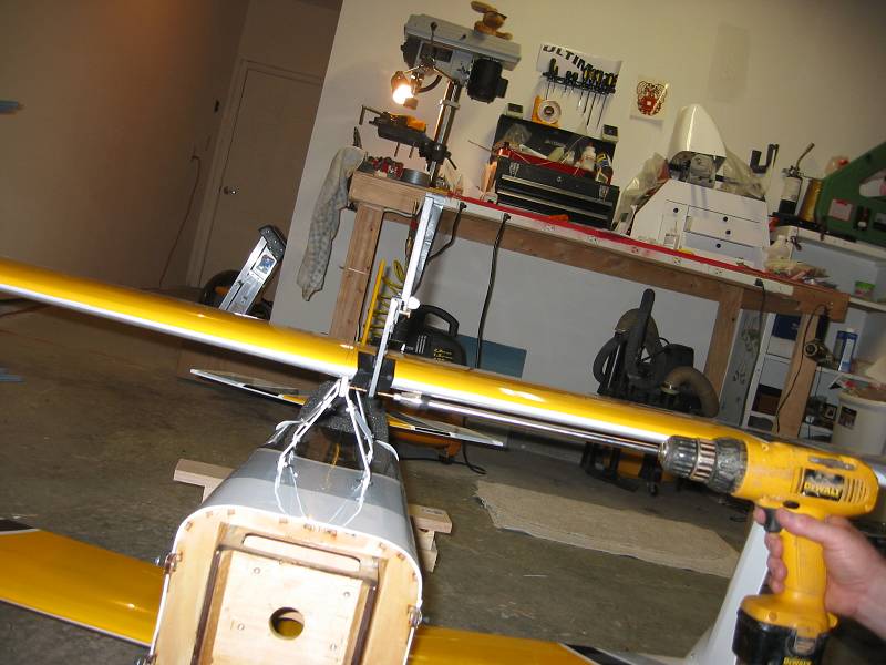

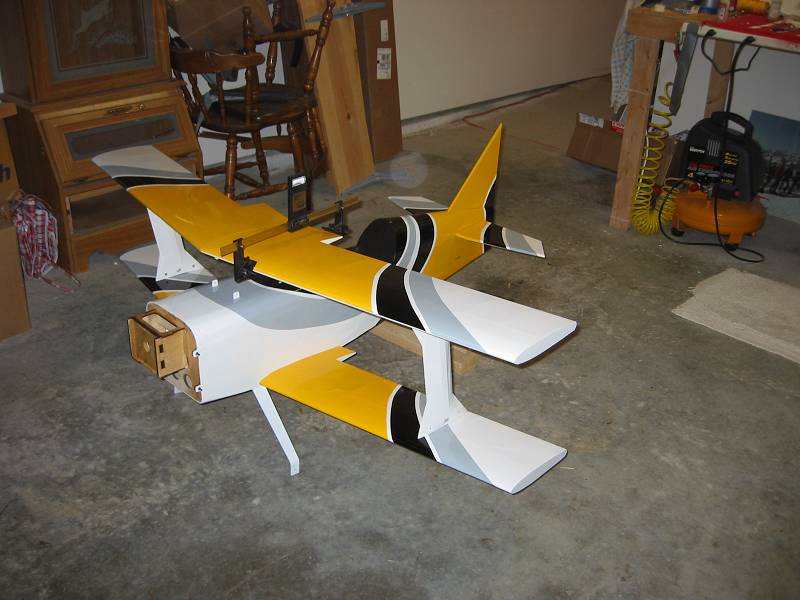

Alright...here we are with the setting up of the cabanes and struts. I decided to go for 0/0/(-1) incidence so I could take advantage of the top wing giving me a little longer before the stall takes over. The instruction manual clearly lays out the sequence and is straight forward. I read through it several times and referred to it often throughout the sequence to make sure that I did not miss something (I guess I have learned something over the years). First, attach the landing gear and the lower wing. Next, block up the tail until the stab is at 0 degrees incidence.
Old 04-22-2006 | 08:10 PM
tomriddle's Avatar
Joined: Aug 2004
Posts: 357

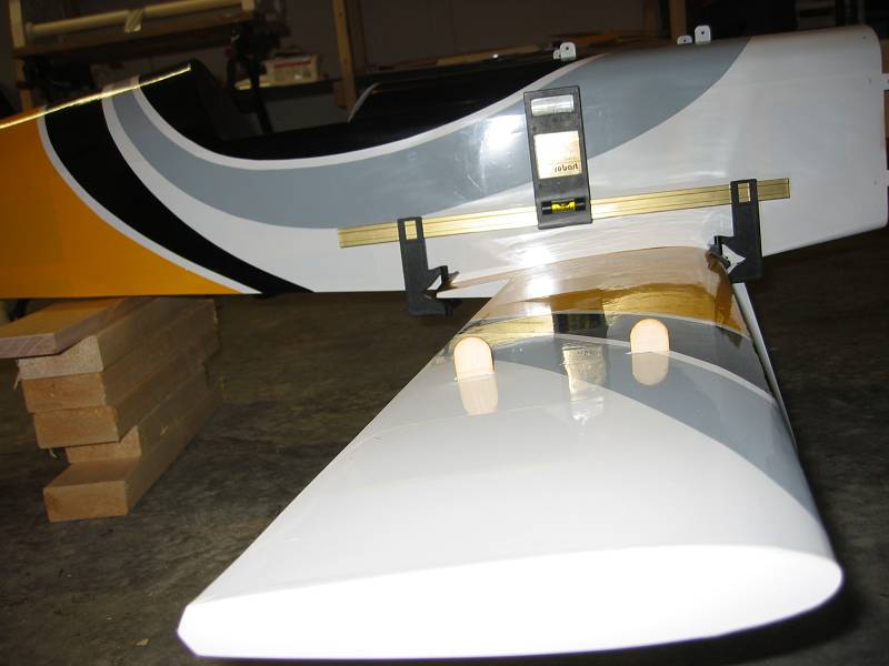

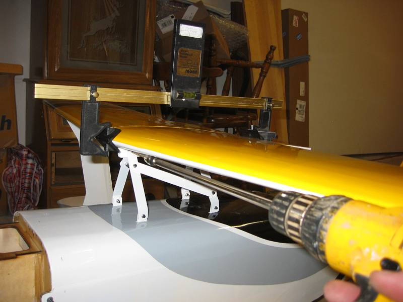

Next, I checked the incidence on both sides of the Fuse as well as out on each wing. I was very impressed - the bottom wing set up at 0 degrees with no adjustments. I made sure to follow Tom's guidance and recheck the stab incidence regularly to make sure that nothing shifted. It was true - the lower wing set up exactly at 0 degrees - very nice.
ID:	449672   Click image for larger version
Old 04-22-2006 | 08:28 PM
tomriddle's Avatar
Joined: Aug 2004
Posts: 357
Next I attached the top wing and checked the incidence - wow, it set up right at -1 degrees. After double-checking the stab and lower wing one more time to make sure nothing had shifted...yup, the top wing was spot on. Actually the center of the wing was slightly less than -1, but I figured I could make that up when I attached the cabanes.

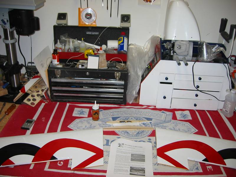

I used Gorilla Glue for the hinges. I tried the technique of using the masking tape to keep the foaming glue off the wing, but it seemed to me to take as much effort as watching the hinges closely and cleaning up the excess as it appeared. Per the instructions, I glued the hinge points into the airframe first.
