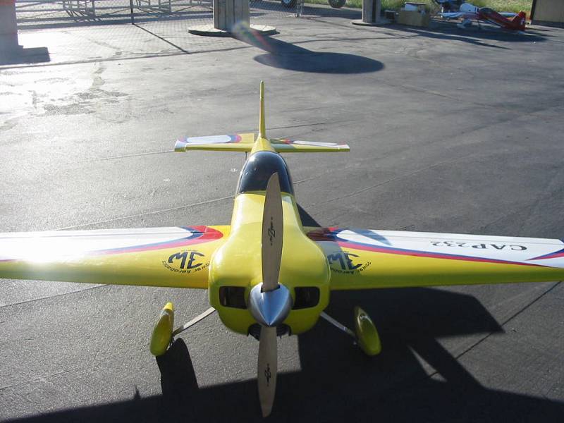

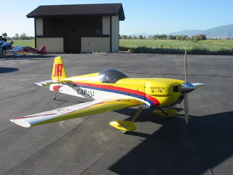

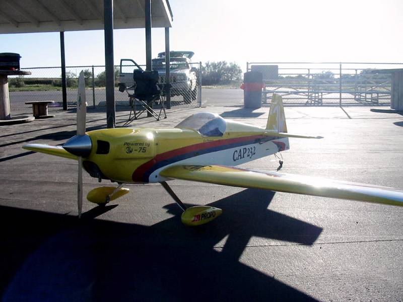

Well had another great day of flying today. This was my first experience flying down in the lower elevations (NE) it was amazing. More amazing than the power increase is how much slower the airplane lands. This was the first flight I got to fly my cap with all new 8611's. I noticed the biggest difference in the ailerons. So Crisp, so sweet, and no hunting! I realized today that the airplane needs a good throttle-rudder mix. Rolling harriers were good today, the airplane does them better, or at least I did them better today and I wouldn't say the low wing really matters as much as I thought it did. Harriers are good, but if i was to harrier land, I'd be buying a new prop. The gear slowly bends over time and needs to be bent back up.... I guess i am carrying more weight than most up front though.
My main focus now is getting some weight in the front. I took off the tailwheel today to weight it, and it doesn't feel that heavy, i don't think i'm going to get much of a cg change getting a lighter one. That was my last option besides adding nose weight which is what i've been really been hesitating to do.

Eric I thought the Cap flew great. I don't recall but from what I observed it looked to be very neutral in the pitch axis. Did you notice if it wants to climb when inverted? If not I would say leave the balance where it is and get used to it as the plane really does appear to fly very well.
You definately need a better prop though as you simply can't imagine how bad the Pro-Zingers are until your fly something better.

Weren't you the one that said anyone who hasn't experimented with Caps cg are missing out? yeah, it flies nice, but i think it would track better and be less likely to be snap-wobbley when you pull back on the elevator with a further forward cg. You should fly it for sure and see what you think. I'm ordering the prop tomorrow, can't wait.
everybody is pretty cool here, it seems like i'll finally get the help I need

I guess the time I have spent flying mine and others aerobatic planes was probably speaking when offered my opnion in the last post. Your right and you should move it some and fly it to get the model flying the way YOU like it. After all, it is your airplane!
IME if the plane feels snappy to you it's more than likely due to too much elevator throw, Caps are especially prone to this. If you leave everything the same and only move the CG ahead it will probably snap worse as that is what I have experienced every time I have been in this situation. I simply can't stress enough how powerful the elevators on Caps are and beause of the low wing/high stab configuration there is a phenomenon where at certain angles of attack where the wing blanks out the airflow over the stab/elevators resulting in that snappy tendancy Caps are known for.
In the end your just going to have to play around with it and see what you like, either way the plane really looks like Iit has a lot of potential and looks great in the air.
