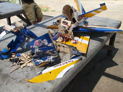

When two transmitters are sending signals to the same aircraft and it is PCM, the RX goes into lockout...the throttle went to low idle and the control surfaces stayed where they were when it had a valid signal. Here is the aftermath...45 degrees straight into hard dirt.
My 28% Extra 300LX had a carbon fiber spinner, carbon fiber wing tube, DA-50, carbon fiber stab tube, three Li-Ion batts and Duralite regulators, stock gear and wheel pants...weighed 15.5 pounds without fuel.
1. Construction on the original Extra 300LX was very strong and well built.
2. Glue joints were strong on the parts...wood broke and left the joints where glue was holding parts together.
3. The motor box was destroyed along with the whole front of the aircraft.
4. The wings ripped the sides of the fuselage out but the pins and bolts holding the wing on were in tact.
5. The tail section is very well built. The balsa glued over formers has no foam inside, just air...strong and light.
6. Using Gorilla glue made my hinges indestructable. I tried pulling them free and was completely unsuccessful. I even tried bending the control surfaces over past the bevels and wasn't even able to force the hinges out that way!
7. Over 100 flights and people still commented on how it looked "new."
8. Great plane - very strong and light weight!
If the other TX hadn't been turned on this plane would have been around for a long time to come!

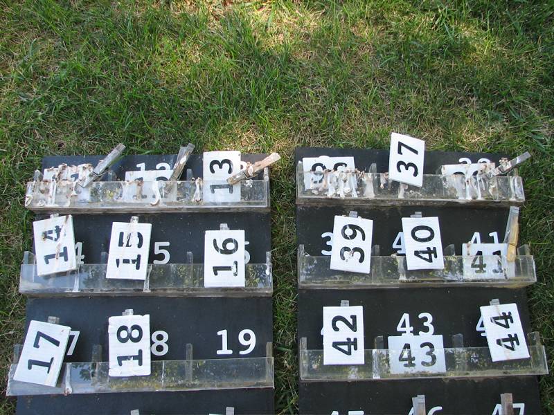

1. No where in the 2006 AMA Safety Code does it say that you have to use a frequency board. (You would be stupid not to if it is available, I agree. Now I will use it even when I am there alone.)
2. We do not have a "club" or written club rules to follow. "Common Courtesy" is the only rule. This field has been let go for quite a while physically. The charter hasn't even been kept up on for atleast a few years now. I think the AMA rules posted on the message board are from 1995.
3. This is what the frequency board looked like. Pins were missing...broken...and some were covered in bird poop. The nice slots in the plexiglass look good for AMA cards, huh? That was rarely used...mostly by us. The method that was used was to take the pin off the board and replace it with another plain brown clothespin with the owner's name hand written on it. From 10' away you can't tell the difference on some channels. Today, I brought the boards home, cleaned the boards, reglued some broken plexiglass, built an "A-frame" to keep the bird poop deflected, and I painted 50 new pins bright orange with numbers clear-coated on the pins themselves so they can't break off.
As soon as the paint is dry and I finish re-assemblying, I'll post pictures of the improved frequency board.
