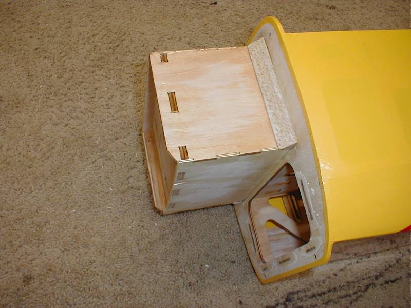

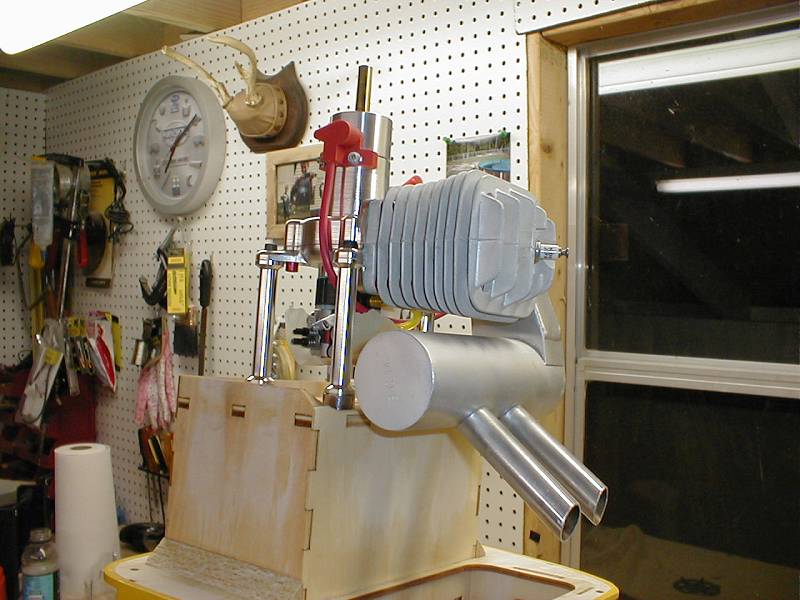

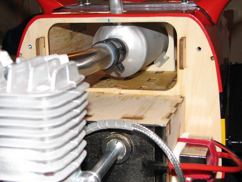

Default RE: 50cc Edge V2 has landed

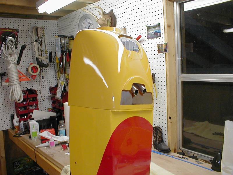

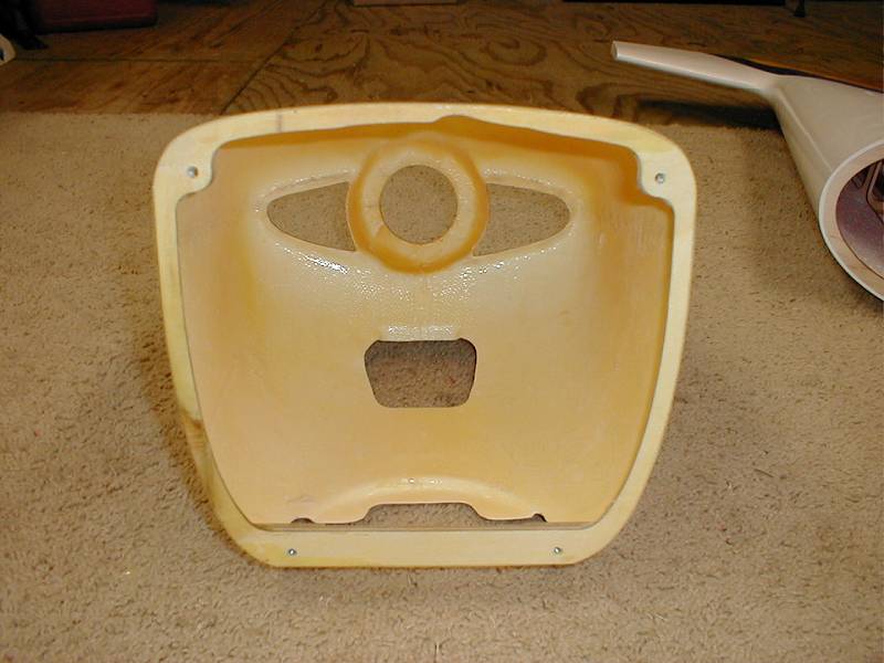

I said I was slow, but you can’t rush perfection. I had to cut about 3/16 off the stab and wing tube. The incidence on both stabilizer halves and one wing were off just a (wild) hare.
Cutting the cowl to fit over the muffler was a bit of a puzzle, but easily solved by shaving a bit off the bottom lip of the motor box and shaving a bit off the cowl ring at the top so the ring could pass over the prop shaft. There is no need to cut off muffler tips. I had already cut the tips off my Bison wraparound muffler for better engine performance. The cowl was cut just enough to fit over everything; I will be going back and widening everything for good engine cooling.

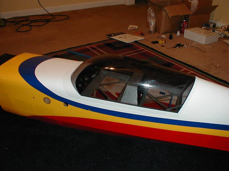

Wife is mad cuz I brought everything in the house. It’s too cold out in the barn 37 degrees. Sorry about you guys in the artic tundra. I glued on the canopy and painted the trim. It turned out very nice. Everything is going together perfect except for the following: The servo trays in the wings had predrilled screw holes. The holes on one end lined up perfect, but the other end was off enough that I had to fill them in using a tooth pick for a dowel and re-drill (no biggy.) I am using the Hitec 5955s in the wings. If I could have taken two days off work this week I would have been flying it Sunday [:@] #@%*!!!! Maybe next weekend.

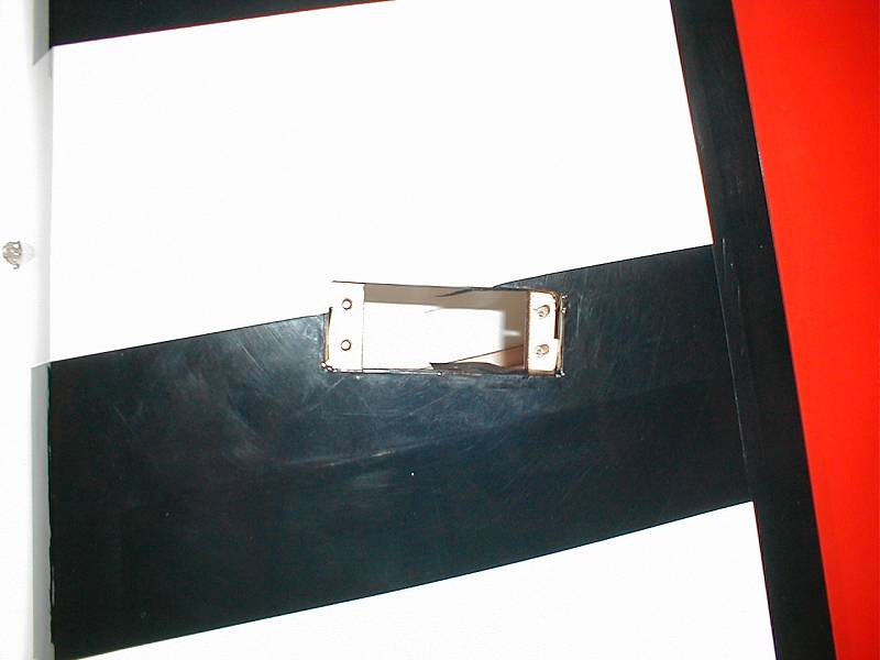

Capt Randy - I used JR 8611A servos in the wings and they fit perfectly. WH obviously believes in these servos. Oddly, the rudder and elevator servo trays are not drilled.
Old 02-10-2007 | 12:11 AM
  #48
rctom's Avatar
Joined: May 2002
Posts: 6,189
From: Flower Mound (near Dallas), TX
The builder drilled them, I did not know they were doing this. I will ask them not to do it in the next batch.
