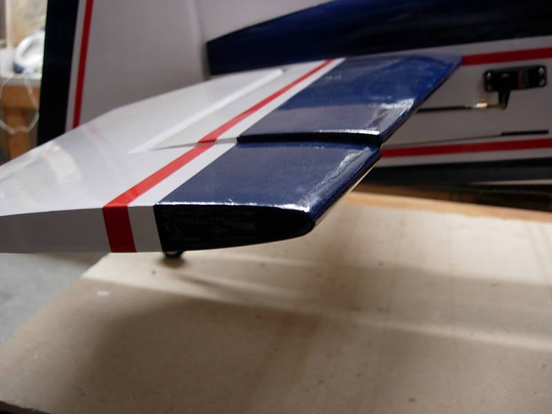

I was very disappointed today. I finally got a chance to fly the 260 after moving the CG back to 4 inches. There was absolutely no change in the amount of trim required to to fly level. I have 10 clicks of up trim to hold the nose. The airplane did fly better. More responsive on the controls. I am going to get an incidence meter and check the wing and horizontal. It is hard to understand how that could be off due to the laser cut kits these days. Anyone have any other suggestions? Stumped John

I was very disappointed today. I finally got a chance to fly the 260 after moving the CG back to 4 inches. There was absolutely no change in the amount of trim required to to fly level. I have 10 clicks of up trim to hold the nose. The airplane did fly better. More responsive on the controls. I am going to get an incidence meter and check the wing and horizontal. Anyone have any other suggestions?
I'm surprised there wasn't at least some change. I would look at the incidences on the wing panels and horiz stabs. Does the nose drop like a rock when inverted if you don't feed in lots of down elevator?

I was so P.O.ed today I did not think about flying inverted to see what happens. I knew from the way it flew I was not going to move the CG back any further. That would have told me if I could have continued to move the CG. It was very responsive. Enough that I will have to tone it down for IMAC. John

John:
I have a thought about this situation.
Some of these planes had the elevators built with a twist in them. Most of the time it was just in one elevator, so that if you had the counterbalances lined up with the h-stab one of them was off from the other one. Check yours for this.
Look at it from the rear with both counterbalances lined up with the stabs, it will be obvious of one of them is off.
If this is the situation contact me and I'll send you another set (if I have the right color in stock).
TF

Default RE: WH 260 Help
I have not check for that. Will let you know. Thanks John

Just checked. They are both the same. From a flat table, they both check 8 inches with the counter-balances centered. John

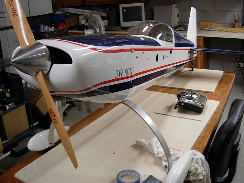

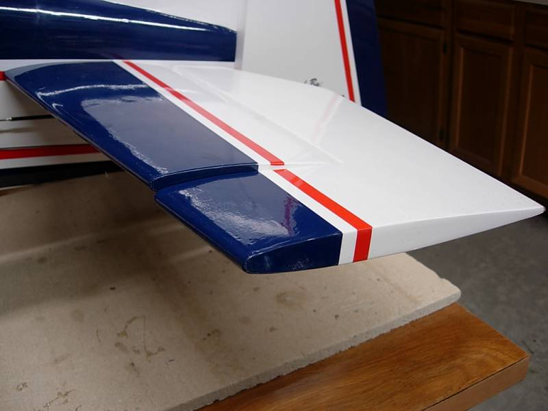

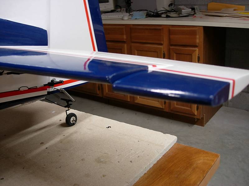

Here is what the trim looks like for level flight. John

The incidence meter says the leading edge of the horizontal is to high. It is one increment on the meter. I don't know if that is a degree. It is about 1/2 bubble off. That is what is causing the dive problem or at least most of it. I am wondering if I can loosen the attach bolt holes at adjust it down any. It could induce a twist but it is worth a try. Both sides are the close to the same, but the right side is worse than the left. It would be an easy adjustment with only one tube but with two it becomes more difficult. Does anyone have anything else to try without taking the tube sleeves out if I can't adjust with the bolt holes? John

You can't adjust the incidence on that plane. And 1/2 degrre would not account for your problem.
I still think the elevators are twisted.
Let me ask you this; if the elevators did not have counterbalances would you even know there was a problem?
I mean what difference does it make if you are carrying a little up or down elevator if it flies ok? I may have a set of non-counterbalanced elevators/stabs, what color is your plane?

Where you will notice the incidence issue most is on KE.
Even though your stabs are not adjustable it can be done... I just finished doing it on a Yak and the difference was night and day.
First take off your canopy and put a level on the canopy line... raise the tail till you are perfectly level. Check your wings and they should be at 0. From there check your stabs.. they should be at 0 as well.. if they are at 1 or 2 then you should consider spending maybe an hr to fix the issue.
All you need to do is enlongate (sp) the anti-rotation pin holes and maybe the holes in the tab that keeps the stab in plane. Take a rat tail file and slowly length the hole in the direction you need to go. Then just get it so you are at 0. Harden the holes with CA and then take some epoxy and make the dowel slightly larger on top or bottom so it's a snug fit and keeps your incidence at 0. Take your time and sand it so its a perfect nice and tight fit.
You will spend maybe an hr or 2 depending how fast you work and in the end with 0-0 incidence you will be closer to where you want to be and the plane will fly even better.
