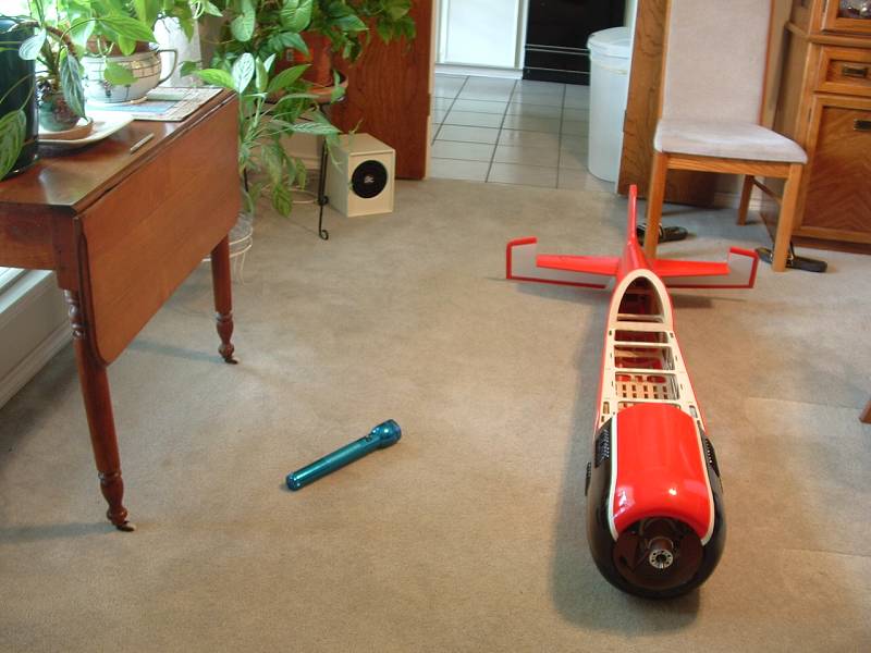

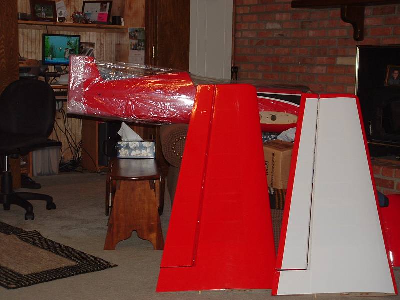

Default Another 50cc Sukhio Build!!!!!!

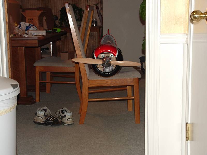

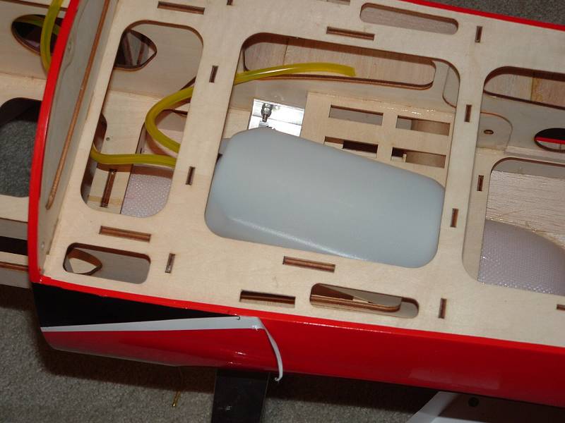

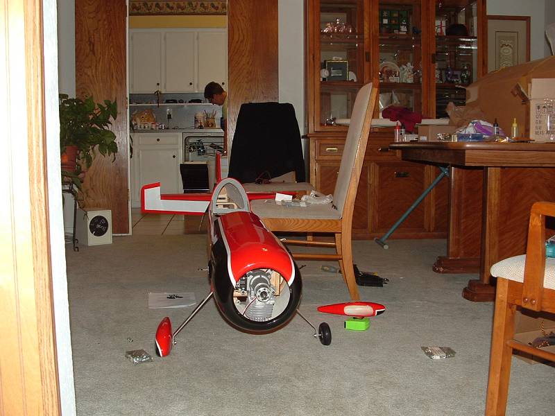

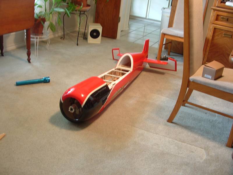

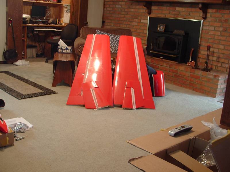

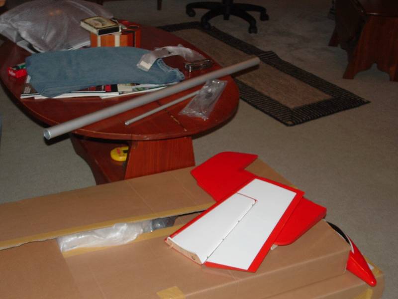

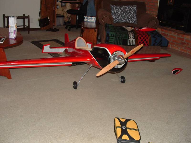

Okay well the plane came in the other day and I had some time and a ride to go pick it up. I have all the surfaces except the rudder ready to be hinged. I have the elevator glued. Tomorrow I am hoping to have the motor mounted the rest of the of the hinges glued as well as have the landing gear assembled. I will continue to have pics and I will keep you posted.

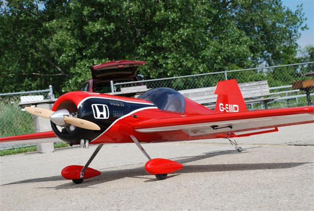

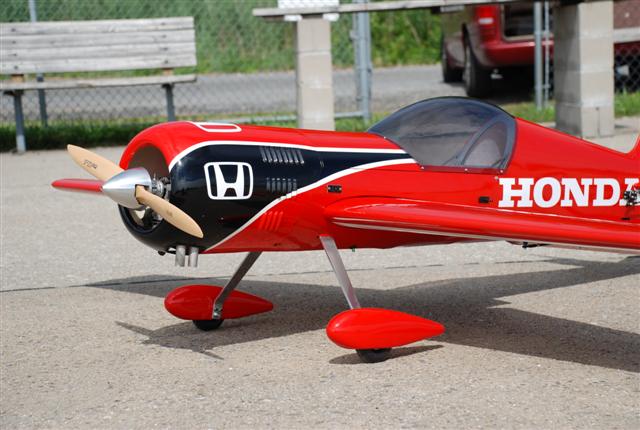

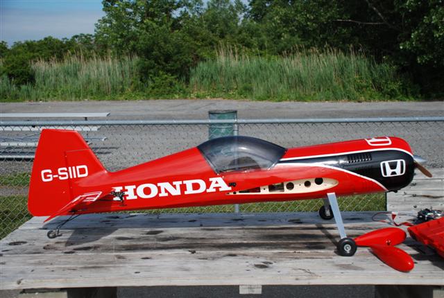

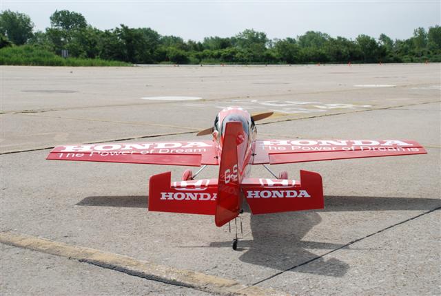

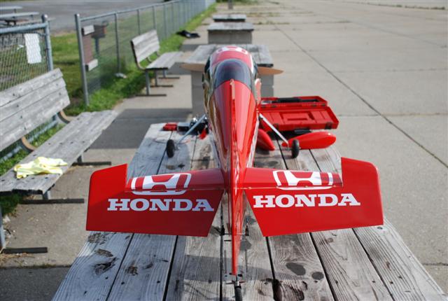

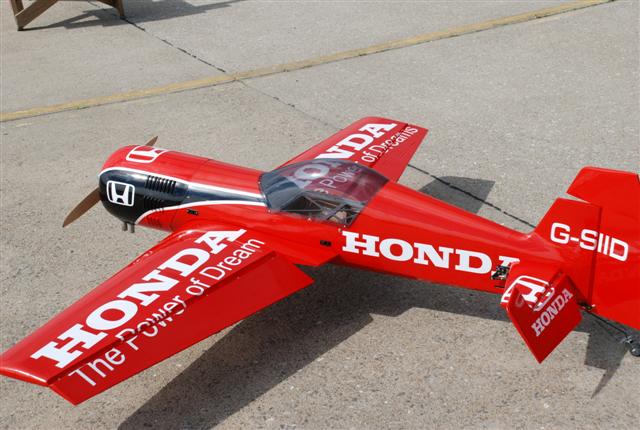

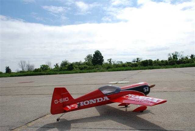

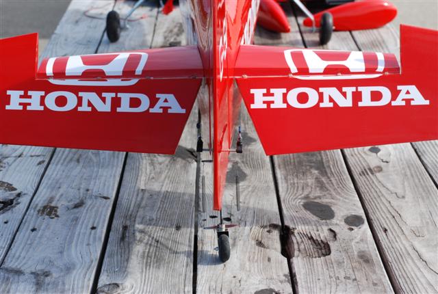

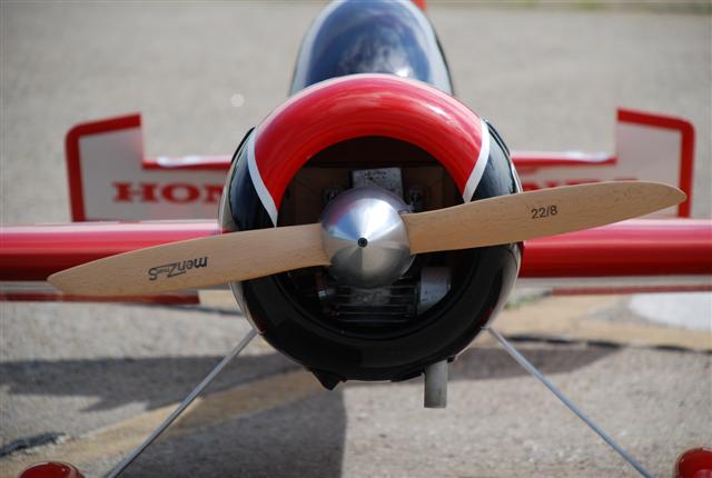

Had a nice photo shoot today. Could not fly the maiden though, Having soom really bad rfi issues.
Talk two more fellow modelers into buying a bunny though, and this is without even seeing it fly yet.

Mike:
Very pretty, nice job on the graphics.
What engine/muffler is that?
What kind of problems are you having with the radio?
TF

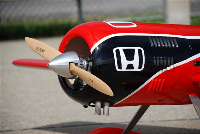

Thank you, Thats the BME 50 with a stock muffler. I really wanted to go with the cannister but I think I will save up for a spectrum system instead.
I'm having a very bad case of RF blues. With my engine running I can't walk farther than 10 feet before the servos go crazy. I check over a lot of things while at the field in an effort to get the maiden in ,ut no luck so far. I thought the problem might be with the servos for the choke and throttle being up front, but when I disconnnect them from the reciever and pull the wires away the effect was the same.
While reading up in the gas engine forum on RF problems, I learned that if the interference happens slightly less than the engine off distance (35-50% of engine off), that it might be RFI related and if it's much worse than that it might be vibration related. Either way I'm trying to narrow it down. The weird thing is this complete system, engine and all came out of my WH bipe which I had just recently flew 2 weeks ago with absolutely no issues. In going over the CH ignition unit I noticed the hall effect sensor lead looked weird. I moved it a little and it broke away from the bracket. Terry from CH is sending me a new one. When it arrives and I'll be able to continue trobleshooting the problems.
That small metal box you see on the top part of the engine is the CH Ignit.

Thewrap that's a huge prop on there. Is it a 23 or 24 inch.

Neither. It's a 22x8 and I have a 22x10 that I can throw on if I would like. Today was an almost unsuccessful day. I only had to call Tom once today and he didn't pick up so I never even talked to him today. But I was able to solve the problem. I will have pics and a story of how well the build is going.

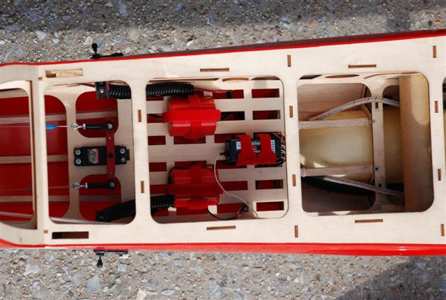

I have made some progress. I was able to get the landing gear mounted all the surfaces test fitted. I have the wheels on and a wheel pant on. I test fit the elevator servos so I have that cut out. And I was able to get the hatch to fit and center the cowl.

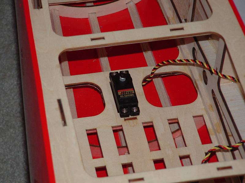

Okay here's the latest. I finished all the hinging. Mounted the rudder servo, for that I'm using a Hitec 5645. I was able to finish with the wheel pants except for getting them glued. Tail wheel has been mounted, and I've started to go on with the plumbing of the fuel tank. Here are the pics. Things should really start to come together when I get my parts in.
