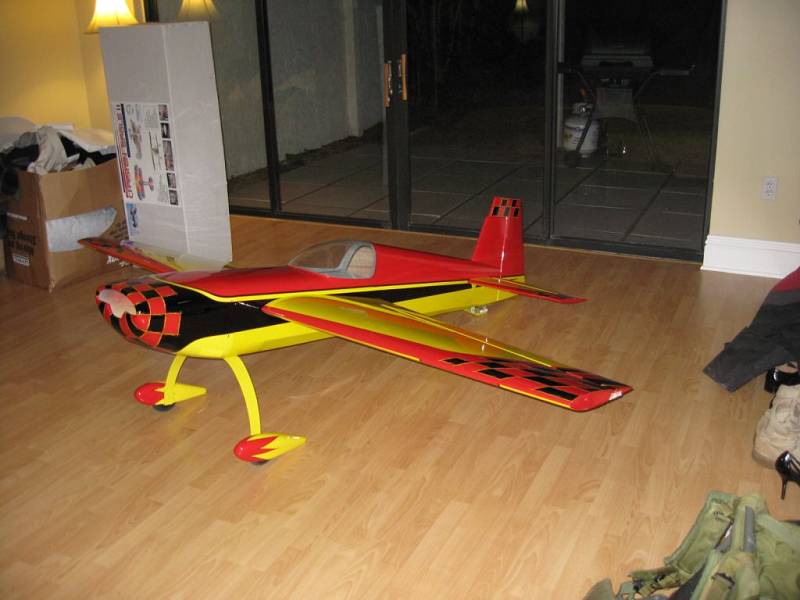

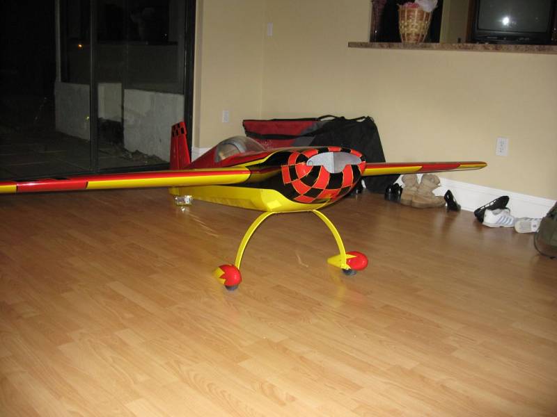

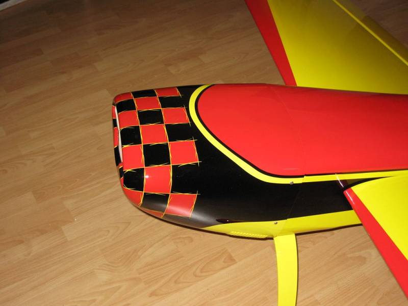

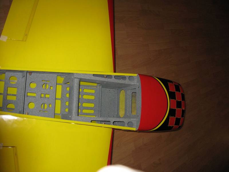

Well it was picked up this Saturday from the master himself Tony's shop. I am always amazed at the work that he does. He and Aerotech share the same shop now. If you cant tell, this is the WH 260. This one is totally custom and I dont think there is another one out there nicer.
A really nice detail is that Tony glassed and painted the hatch. In person the entire plane itself looks painted.
I am leaning towards the DA 85 with a single can. I will also being going 2.4 on this one. I am not in a huge rush to finish this one off and I have to admit this is the first time in a while I have had a nice looking plane I am only slightly afraid to have fun with.

What was used to paint the inside of the fuselage

Note: The inside is first sprayed with a cheap grey primer. You then use fleckstone paint (Walmart carries it). Adds about 2oz to your plane but is worth it in looks. Spray the fleckstone sparingly.

Yeah I am 100% sure its a Wild Hare! Its a 260 from Tom that from some strange reason I decided I needed to be re-covered.
Here is how you can tell 100% its a WildHare:
1. It was purchased from WH
2. The way the stabs mount to the fuse and the position of the elevator servos
3. The landing gear are curved (Dalton's are straight)
4. Firewall and motor box
5. Behind the canopy there is the tray used to mount batteries.
For those who dont know Tony (Dalton Aviation) is the one who told me to go with the larger (33%) planes in the first place when I was making the jump from smaller planes. He also built my first WH 260 that I crashed on account of low batteries
Yes for those who have the patience and the $$ you too can have a pimped out plane.

holy wow!
now that has to be the BADDEST WH plane I have ever seen. I love WH but this dressed up doll looks like the ones that cost 2x the price! Love the clean smart scheme. presents the lines very nicely and looks like it will lend itself to custom gfx nicely.
good job man!

Is that paint on the wings, or cut vinyl?

It looks like it was worth the wait. Man I love the pin striping very nice
