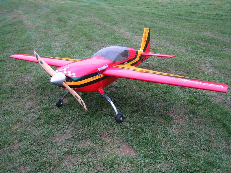

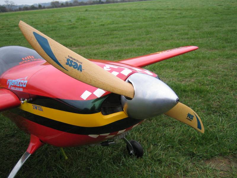

Old 01-30-2008 | 06:21 PM
Tetley's Avatar
Joined: Feb 2004
Posts: 298
From: Bournemouth, UNITED KINGDOM
Default RE: extra300 50cc input needed
Hope you get it sorted dude , i just put a Vess23A on mine and its awesome, real made it fly how i wanted it to.
Get some more time on her and listen to the guys here who gave you some great advise.
Here's a clip from my vess maiden flight, just feeling the prop out etc ive only had about 8 flights on this extra now.. check the landing .
Its got a 3w55i in it and still pulls out of hover well!
http://video.google.co.uk/videoplay?...97649822956067
Jim.

Tetley's Avatar
Joined: Feb 2004
Posts: 298
I'll have to get back to you on the exact cg as i changed it at the field on Monday, but its pretty close to book, maybe a little further back. Next time out im gonna tweak the cg back a bit more.
I also found it was landing a little hot but since changing to the vess 23a it bleeds of speed very well on the approach, my tick over is getting better now too as the motor beds in which helps on landing!.
Jim.
