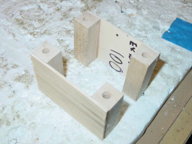

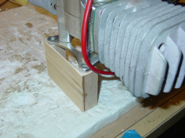

How is the DA100 mounted on the 35%? is it just by using some thick ply behind it or is it a spacer method like on the aeroworks planes? i see u have a da-100 mounting kit for it could you explain what is in this? thanks
Old 01-26-2008 | 07:17 PM
rctom's Avatar
Joined: May 2002
Posts: 6,189
From: Flower Mound (near Dallas), TX
Default RE: 35% DA-100 Mounting
My mounting kit is done by epoxying 3/4" square oak to a ply plate, then I cut it to the proper length and drill the oak.
It's like having standoffs except that it can't rock back and forth. It's done in 2 pieces (top and bottom) leaving the sides clear to get at the carb for adjustments.
Photos below.
TF

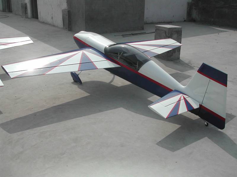

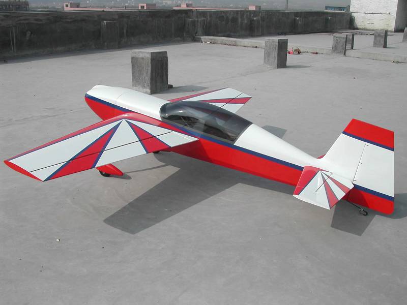

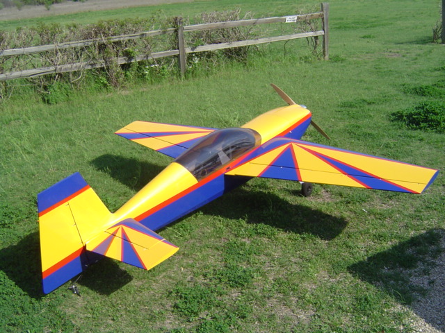

do u have any picsw of the other scheme u have besides the yellow one and the other one thats red with white on top or could u explain so we can get a mental image wife wants to pick color she's KILLIN me...
Old 01-27-2008 | 10:32 AM
rctom's Avatar
Joined: May 2002
Posts: 6,189
There are 3 color sets. BLue/yellow, red/white, and blue/white.
In these photos the red/white and blue white are actually the 41% Extra, but it's the same plane. The blue on the blue white 35% Extra is actually a slightly lighter blue than what is in these photos. It is like what is used on the 102" Sukhoi, it's very pretty.

she is sold on the white and blue bummer i like the yellow one let me see if i can talk her out of it i have till tuesday
