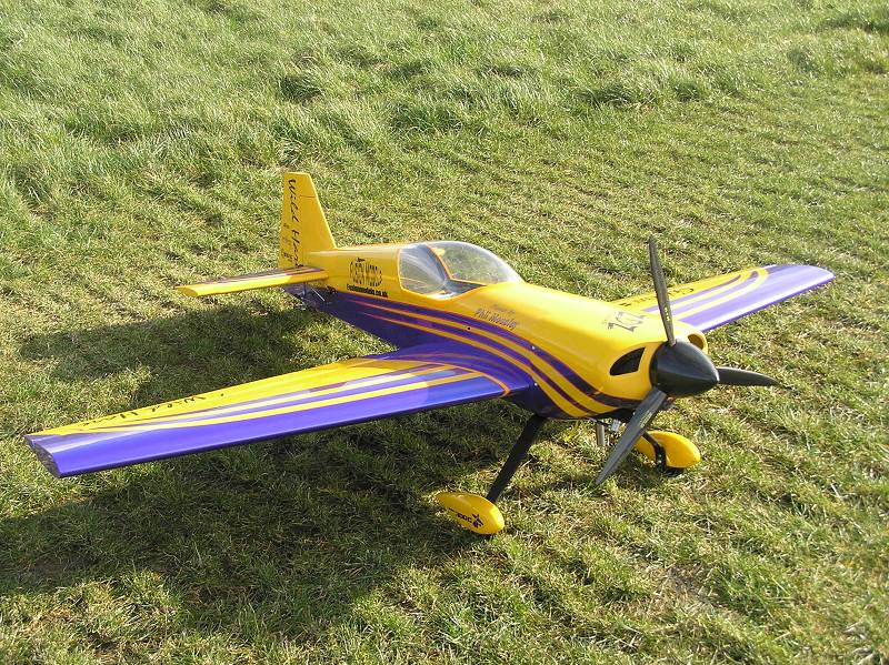

I know this is a bit behind, we get used to that in the UK, but I finally got round to finishing my Wildhare Giles 202 - 35% (only took 15months) and test flew it yesterday - when the weather finally improved!!!!
Despite issues with the engine being very rich (ZDZ 80) as it is new, the plane was still very impressive, very precise with no coupling to knife edge what so ever!!!!!!
Balancing the plane the night before I thought a rearward C of G may be a problem but as it turns out it was about 1/2" infront of the wing tube. Landing was fine not too quick and when pulled to 45 deg and rolled inverted it only gently began to pull to the canopy.
When the stall was tested it felt a bit snappy and holding in elevatorinduced a gentle spin - This was confirmed when 'harriers' were attempted - kept in a straight line it seemed ok as soon as a turn was initiated it was VERY difficult to stop it snapping.
Another thing is that I am running a three blade prop 10" pitch, just to keep the noise down really - but I thought coming in on an overshoot that when I throttled up the plane yawed????? Does anyone have any info on three blade props .....never used them before. In the vertical it gently pulls off to the left - Is this another result of the prop. Would changing to a 2 blade solve some of this????
There's a couple of issues here all help will be appreciated - need to get it dialed in soon as IMAC season is coming up!!!

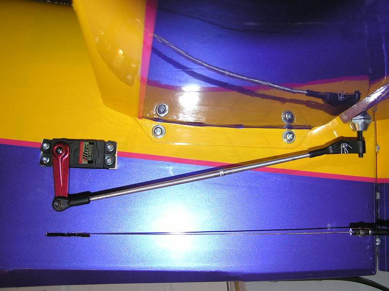

do you ahppen to have any pictures of both servos at the rear.....not sure I could get even one to fit???? Will upload some pics later to show why. The servo heads will hi the servos

You need to be a little creative with the linkage. The servo arms for the elevator or the rudded servo need to be opposite each other. For 3d the longest arm you want to use has linkage centers 1-1/8" from the output shaft. If you have 1-1/4" arms you need to grind off the excess length from the end of the arm. The linkage rod angle won't be a factor.
For precision or IMAC stuff you don't need an arm longer than 1". In truth, for most 3d stuff the 1" arms work well on the 35% Giles. I don't believe I have a picture of the Giles with 4 servos in the tail, but I haven't found a need for dual servos in anything other than the big Sukhoi so far, although I'm sure the 40% Extra needs them. Let weight and balance be your guide to the number of rudder servos. If it needs the weight, use two. If it doesn't, use one. The plane will knife edge loop all day with only one good rudder servo. That's a pretty good test of what a rudder needs for servo power.

Just for reference I have uploaded a photo. The servo head is pretty much right in the middle of the bay for the rudder servo. Will have a good look at it tomorrow night and try to work it out.

You'll find that if you rotate the elevator servo so the output shaft is to the rear, and install the rudder servo with the output shaft to the front, the linkage will not be a problem if the rudder arm is fitted to te low side. Use a standard 4-40 ball link and clevis unit on the rudder tiller. Use either Tom's type or a Nelson/Rocket City. Doesn't help the Pro Link on the elevator but what can I say...
