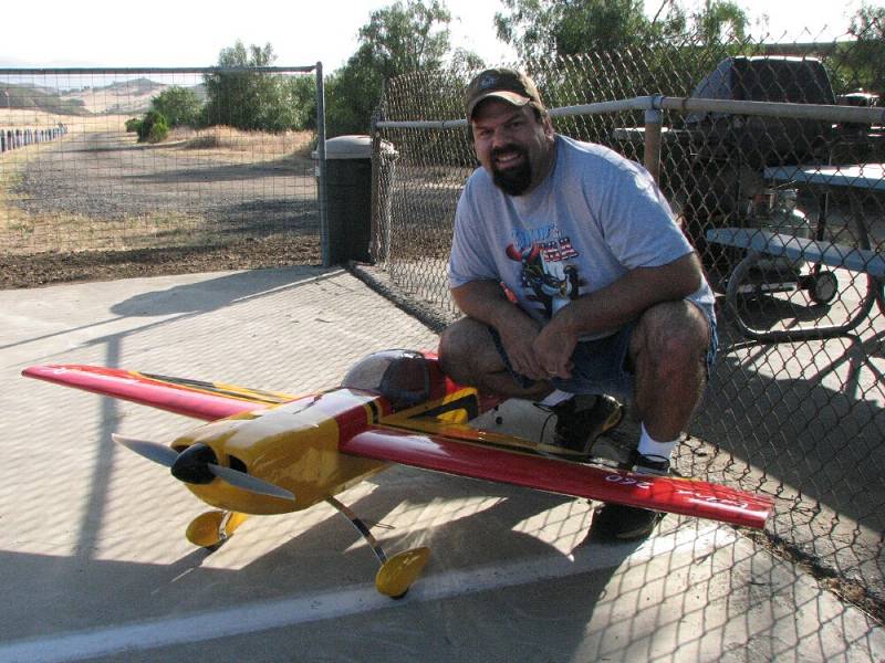

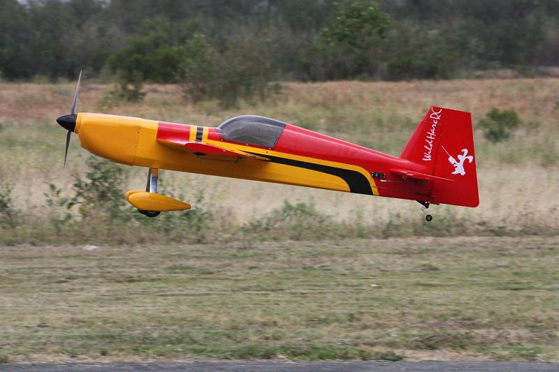

Tom,
I finished the plane a few weeks ago but am just now getting around to uploading the pictures. It flies great and has plenty of power. Right now I am getting about 8 min flights with the batteries not even getting to warm. I am making about 1600 watts at a 50 amp draw. The auw is 10.5 lbs.
Here is a list of equipment:
Hyperion 4035B-14 motor
Castle Creations 85HV ESC
2x 4s 5000mah batteries
1x 2s 2200 lipo for the receiver with Castle Creations bec
4x JR DS821 servos
1x JR 8611A servo for the rudder
1x JR 790 receiver
Thank you for an excellent looking plane that flies great!!!
Ken
