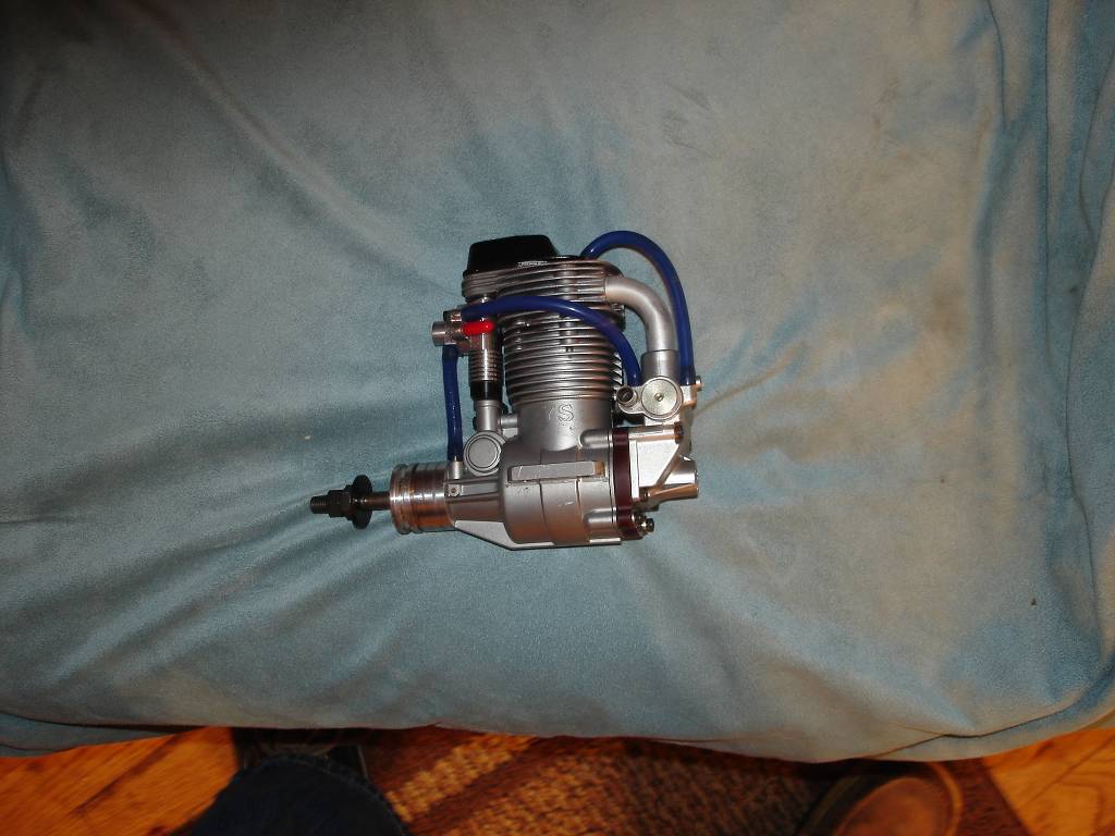

I got this engine and to tell the truth, I know nothing about ys engines. My question. It did not come with a muffler, where can I get one? I will post a couple of pictures. On the engine there is a inlet with a red covering on it. What is that for? The picture in the 1 page manual shows that the vent line in not connected to the engine. It that vent line, just that a vent. Like I would have on my gas engines? Sorry for all the questions, just not familiar with YS.

The red covered inlet is the fuel inlet from the tank. The DZ uses a fuel pump instead of a pressurized fuel system. You will vent the fuel tank to atmosphere just like a gasser.
Central Hobbies has a lot of different exhausts for YS engines, the YS 1.20-1.75 all use the same exhaust thread, but I will caution you that the standard 1.20 muffler will choke the DZ.
Do a search here on the DZ and you will learn a lot.
