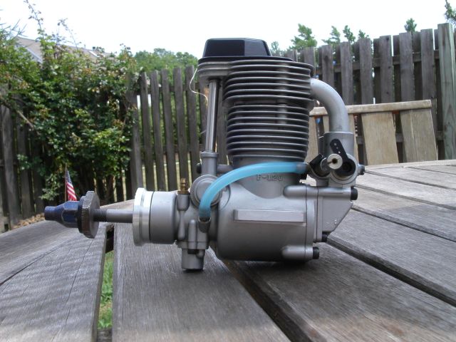

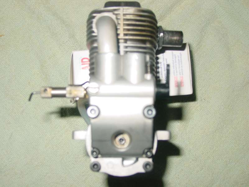

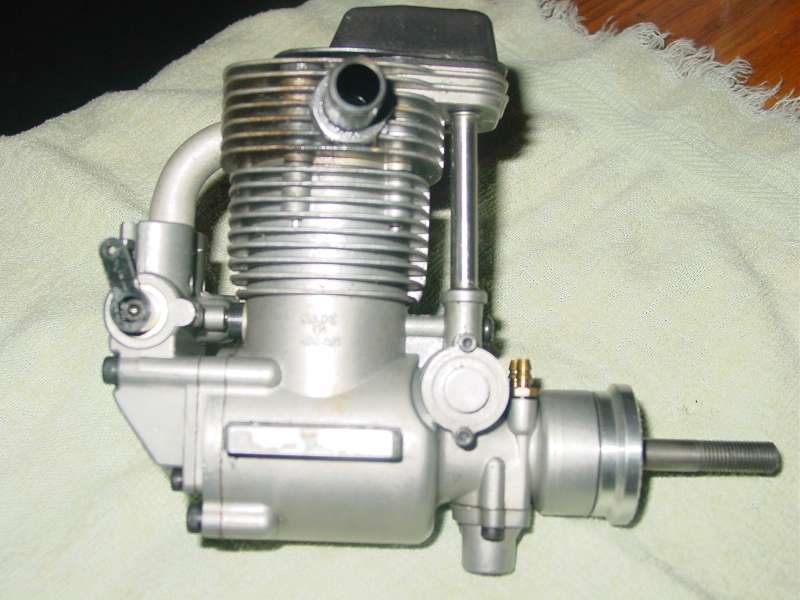

Hello Dave
I finally got the pics that you need to identify my 120. Can I get some specs on it? Opinion?
Thanks, Randy

Looks like the early F120. Not nearly as much power as the later ones. Try a 15x8 or 16x6 prop.

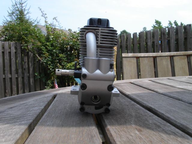

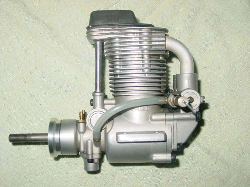

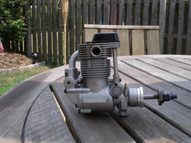

Hi Guys,
I also have a YS F-120 and would like to know what type it is in order to get the proper spare parts.
can you help me on this?
Rainer

120 FS, looks like it hit the ground. Pushrod covers are the same on all 120's

Dave,
What do you mean with "it looks likr it hit the ground?"
Don't get it - it's probably my poor english -well ...
Nevertheless, I want to order a gasket set and a muffler. The muffler shouldn't be a problem but the gaskets are different - aren't they? Which one do I need to order?

From the photo it looks like one of the pushrod covers is bent. Probably just the photo.
You need a YS 0900 gasket set. Try Central Hobbies.
