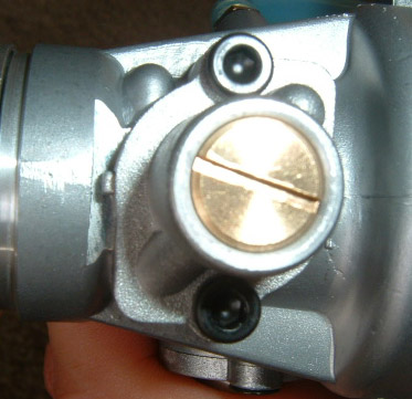

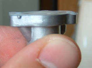

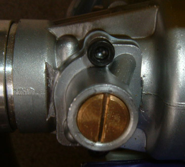

ORIGINAL: sfsjkid
...I had the regulator on backwards...
I have a related question Dave - I took my regulator off yesterday (110) and ran into a similar problem - how do you tell the correct orientation to re-install it? There seemed to be a little blob of metal on the regulator in one spot, but I couldn't find any matching registration marks on the engine to line it up. The motor seemed to run ok when I re-installed it, so I guess I got lucky.
More questions: The diaphram in my 110 has a small fold or crease in the middle. When you first take the reg off, you can see a bubble of air between the diaphram and plunger under the crease. Is the crease supposed to be there, or should the diaphram be completely flat?
I am having some problems with the way the motor runs, and I am taking the advice you gave a number of other folks and ordering the replacement plunger for the 91 (I'll get a few diaphrams and springs too). While I'm putting in an order at Central, I could use some fuel too. Would Magnum's YS 140 DZ blend be a good choice for the 110FZ? From Magnum's website, it appears to be a 30% nitro blend, but I don't know the other additives (assuming low viscosity lubes like heli fuel?). I've been running Coopers 30% Plus grade, but Brian is not yet back to producing fuel since he moved to NY.
Kurt
Old 10-02-2005 | 02:39 PM
Posts: 5,385
From: Gardnerville, NV
Default RE: FZ110 fuel problems
The diaphragms are never flat after being run. The important thing is that they have no tears or holes. The blob of metal or the regulator housing goes forward as you have found.
The DZ fuel works well in any of the YS engines, Cool Power 30% heli and Powermaster 30% heli work well too.
Old 10-02-2005 | 03:05 PM
Rumple's Avatar
Joined: Apr 2003
Posts: 142
From: Longview, TX
Thanks Dave.
After I posted that message it occurred to me that I have a second 110 NIB that I bought during the last production run. The regs are different! The newer reg has a bit of metal that should face forward as you mention, but my older one does not. The "blob" of metal that I referred to on my older one is in a different location. See the pic (this pic was meant to show you the crease and bubble in the regulator, but you can see the "blob" I was referring to on the left).
I also noted that the newer 110 has the 91-sized plunger in it! I guess they decided to switch back!? There is also a gasket on the newer one, but not the older.
Thanks again for your Sunday reply. I'm going flying now!
Kurt
pics: older reg left, newer reg center, older reg right

Old 10-02-2005 | 06:48 PM
marvintm's Avatar
Joined: Sep 2003
Posts: 78
From: Cleveland, OH,
Dave,
1) What do you mean by a 120 regulator, being the 120 is not made anymore? And don't keep the details secret....why does it work better?
2) How much difference would there be for a 110 running the newer block nib regulator (with small plunger) or the older reg with little nib and (?) plunger?
Old 10-02-2005 | 07:00 PM
Posts: 5,385
It's really no big deal. Neither one makes more power than the other. The 120 regulator fixes the problem of plunger sticking that we encountered in some of the 110's.
If your 110 works fine the way it is, the reg from the 120 won't make it any better.
Old 10-02-2005 | 07:14 PM
marvintm's Avatar
Joined: Sep 2003
Posts: 78
So how do you identify a 120 regulator? Is it the big nib or little one?
Old 10-02-2005 | 07:21 PM
marvintm's Avatar
Joined: Sep 2003
Posts: 78
In the picture posted on the left, the reg is on backwards. Note the different passage shapes on either side of the reg, one is straight, the other is rounded as witnessed in the right hand photo.
Old 10-02-2005 | 09:30 PM
Rumple's Avatar
Joined: Apr 2003
Posts: 142
From: Longview, TX
ORIGINAL: marvintm
You know, I think you're right. I can swear I had 2 or 3 flights after re-installing the reg yesterday. Will the motor run with the reg installed backwards Dave?
As for which reg has the little nib, I can only speak of the 2 regs I have. The small off-center nib is on the older, large plunger reg, and the larger centered nib is on the newer, smalll plunger reg. I'm not sure if that is universally true, maybe Dave will chime in.
Kurt
EDIT: I added a pic with the older reg reversed compared to the pic in my previous post. Now the little off center nib faces the front of the motor.

Old 10-02-2005 | 09:48 PM
Rumple's Avatar
Joined: Apr 2003
Posts: 142
From: Longview, TX
Ok, my new question is, do I want to replace my old large 110 plunger with the 120 version or the 91 version? My newer motor has the 120 version, but if the 91 version will work I think I'd prefer it since I wont need to worry about ever replacing the reg gasket. It appears that the reg gasket used in the 120 reg is only available in the $10 gasket set, and the 91 version doesn't use a gasket.
Will the 91 plunger and diaphram work in the 110? Any reason to chose the 120 version over the 91 version?

Old 10-03-2005 | 12:47 PM
marvintm's Avatar
Joined: Sep 2003
Posts: 78
Dave,
Sorry to chime in uninvited... I can start a new thread if needed.
So how would you identify what reg is installed on a used 91 / 110 / or 120 motor for example?
Old 10-03-2005 | 02:53 PM
Posts: 5,385
The 120 reg is the photo on the left and right above. Middle one is 110.
