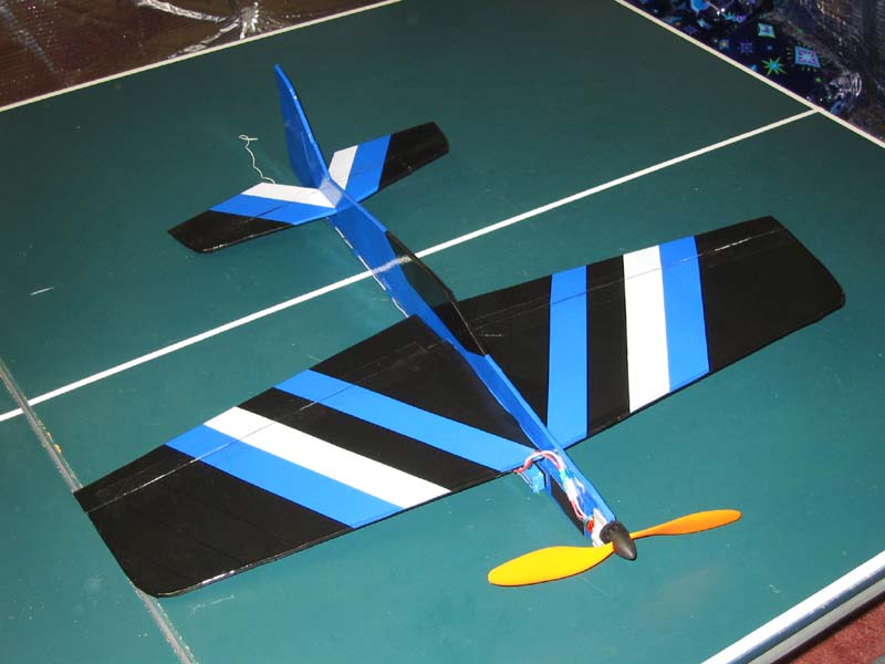

RE: 3DX!
Here's my standard 3DX that was scratch built from the Foamy Factory plans.
GWS 350c motor with D gears.
GWS 12x6 prop.
GWS Pico 4 channel rx.
Blue Bird BMS-306 servos.
Castle Creations Pixie 20p speed controller.
E-Tec 1200 mah Lipo, 3S1P.
FanFold Blucore foam.
Covered with colored packing tape.
Weight = 13 ounces.
CG moved to 5.0" back from leading edge at fuselage.
Here's a short video of my 3DX hovering inside the house:
http://www.eldonmo.com/video/3dxscarescat.wmv
Shortly after shooting this video, the replacement brushed motor burned out. The original motor had lasted about 10 flights, the replacement motor only lasted about 3 flights due to excessive torque rolling. I'm now flying a brushless Himax 2015-4100 and a Castle Creations Phoenix 25 controller in my 3DX and have been extremely pleased with the results!
In hindsight, I should have gone brushless from the beginning since a brushless Himax motor with a brushless CC controller works out to be about the same price as a brushed controller and 6 replacement brushed motors.
My advice is to spend the extra buck$ up front on a bru$hle$$ motor and controller. In the long run, the brushless setup will be cheaper than a brushed setup, and you'll avoid the hassle of dealing with burned out brushed motors. Since it's very likely that you'll end up going brushless later on anyway, you won't want to end up like me with an expensive but useless brushed controller as a token reminder that I should have listened to the advice I was given about going brushless to start with.

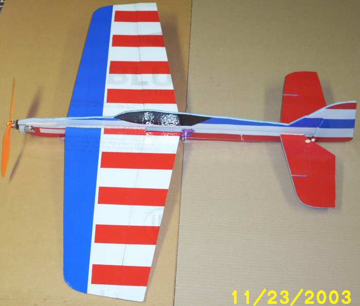

Join Date: Mar 2003
Location: Wollongong, AL, AUSTRALIA
Posts: 171
RE: 3DX!
Definately Chris. It has enough to hold a hover right down to 7.4V. Thats about 12mins in my plane, it has no undercarriage so thats how I take off. By the way there is a charger kit available from [link=http://www.modelcopter.com]andrew zaf[/link] for about $30.
Matt

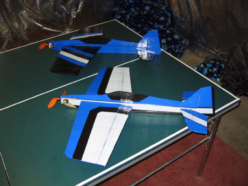

RE: 3DX!
I am using the following setup and am very pleased:
HiMaxx 2015-4100
GWS Gearbox D gearing
12x6 GWS slow fyer prop
CC Phoneix-25 speed controller
E-tech 1200 maH 3s1p 11.1v li-polys
4 HiTec HS-55 servos
Berg 5 channel RX
Here is a pic of my plane and my sons:
HiMaxx 2015-4100
Berg 5 channel RX
Join Date: Mar 2003
Posts: 171
RE: 3DX!
Chris
I am using a e-tech 1200. New etechs are comming out so as of the 13 of feb the price for the current generation will hit its final price ( the new ones will be heavier, more expensive but able to handle much higher currents). Under $40 Aus for 2s pack from modelcopter ( I picked 3 more packs up on tuesday night for the new price). I have a new 2400 etech pack that I will try in the plane, this will bring the plane up to about 12 oz. If it works I will be able to have 3-4 flights on the one charged pack.
At the light weight it has more than enough thrust to hover and t'roll, enough acceleration to get out of trouble quick and will do waterfalls and blenders very nicely.
