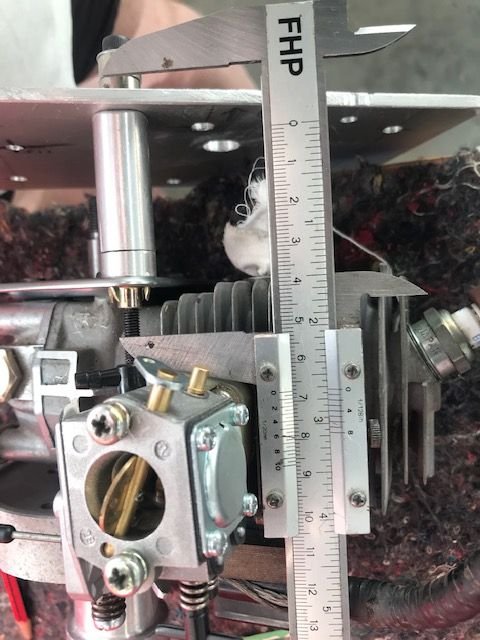

Peter I have a couple pictures of mounting the 38, it must be angled. You can see how I modified the muffler. You can also get a muffler for the G-38 from B&B Specialties B & B Specialties, LLC - Home of Bennett Built products
Hope this helps

many thanks for those photos, sort of confims my thinking as well. Muffler will be a challenge for sure.
I'll check to see how mine fits into the fokker and will need to work out distances from firewall to prop thrust washer on the engine.

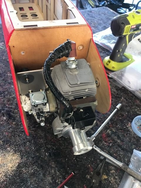

Tail feathers on. Will start looking at the engine mounting next. Will use the distances I have with the Evo 33 in my RV-4 to work out the firewall to prop hub distance that is required as the Evo 33 is one the engines used in this Fokker and has set length standoffs supplied.
I intend to get some rubber isotaion mounts that will mount to a 4mm alluminium plate and then onto the firewall. The G38 will then bolt to this allow plate. Thi is the set up I have with same engin in my 90" Spitfire and it works very well.

I'll still use them, H9 structure is not as solid as a model we would build ourselves, the less vibration then the longer this ARF will last.

Progress so far. Aluminium mount is fitted to 6 rubber isolation mounts.
I had to cut the mount down as I forgot to allow for the muffler.
I am thinking I can get away without the 90 degree carb bend, will have a play with a 90 degree arm and see how it works. If that is successful I will then use a velocity stack to feed air to the carby. It will stick out a bit but can paint it red.
Need to get a prop yet, thinking an xoar wooden prop in the style of WWI.
Only down side to the mounting is that I will have to cut an opening in top of the cowl for the spark plug boot, not overly worried as it will be hidden amongst the dummy exhaust anyway.
For the muffler I will knock up a dummy using balsa and see if I can get it fabricated at a local engineering works. I have one on my spit like this. For the fokker I will make it wider and have the oulets towards to outside so that can go down on either side of the mount and be clamped there.
Hard to explain.
Still need to get some 5 bolts and lock nots to use through the alum spacers. Ones shown are too long and using the T-nuts temporarily.

Carby linkage sorted.
Need to get new gaskets for cylinder to nylon housing and from housing to carby.
Hoping a bennetts muffler may fit with tubes pointing down, have emailed them for some dimensions.

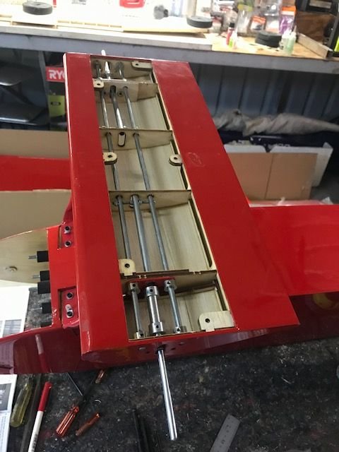

After work I managed to get the push rods, linkages, rudder pull pull cables completed and have started on the tail feathers bracing.Click image for larger version

Progress from the weekend. 18 hours over Saturday and Sunday!
I have found that quite a bit of small hardware is missing from this kit, 8 of the rigging couplers and clevises, lock nuts, 4 grub screws for the wheel collars. Undercariage legs not drilled.
Fuel tank kit had no tubing.
QC lacking with this sort of stuff. Hopefully nothing else is missing.
Directions are lacking in a few key areas and had to work out what the hell they were wanting done with cowl in particular. Look at end photo then work backwards.

Muffler has arrived, the angles were a bit off forcing me to grind about 1/8" off the alum standoffs so that the flexi pipes could fit.Battery packs have also arrived, 2 x 6V 2500mA/h NiMh Eneloop packs.
Prop hole spacer has been done but a friend of mine on his lathe.
Have to get 4 hose clamps and some plumbing pipe brackets to secure the exhaust pipes.

mmm I'd be reinforcing what is left of that firewall, especially around the bottom of that "V". Vibration cause it to splt there.
Carbon fibre cloth epoxied in place and a strap accross the top to lock that in.
