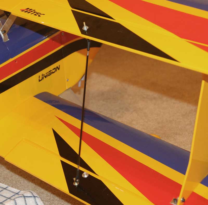

I am considering changing the upper to lower wing control rod, it seems to be a little weak and flexible. Might go with a carbon tube setup. I already installed a bigger tail wheel and it tracks beautifully on a grass runway.

Thanks for the response. I have already considered changing to a carbon rod for the wings and will probably do it. I broke-in the engine this weekend and, if the weather is OK, will maiden it Sunday.

It was an idea I was toying with using carbon tube for ailerons. I cant decide which way to do it yet, the wire for elevators seem to be just fine. throttle setup I used was what was supplied in the kit(solid rod). Since the plane is virtually built for a direct fit of the saito 125 it was an easy install.
If I go to carbon tube I will epoxy or CA glue 2-56 threaded metal rod into it and use metal clevises to attach to control links. Might be easier to purchase better quality metal rods instead of using carbon.

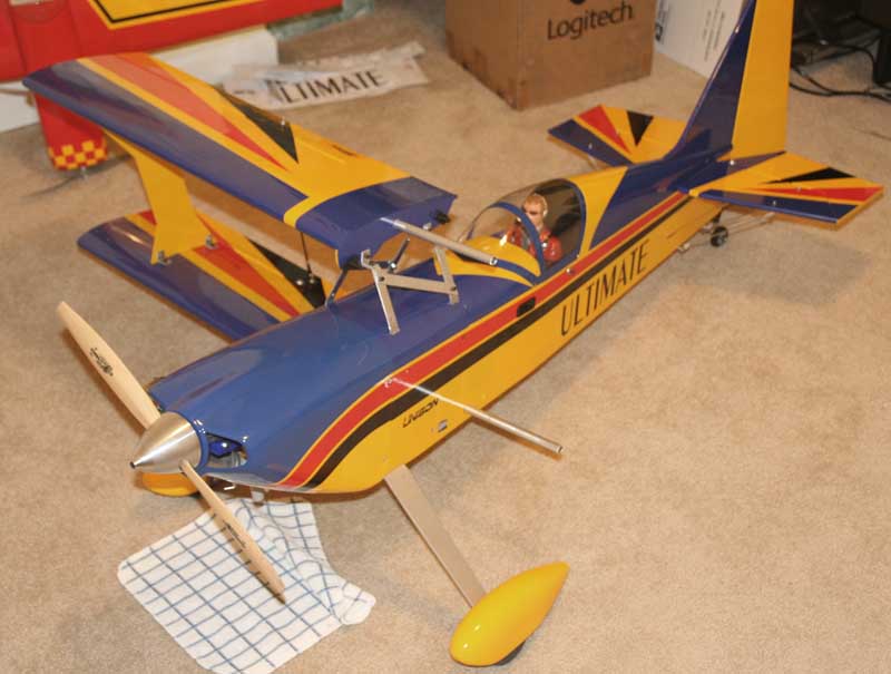

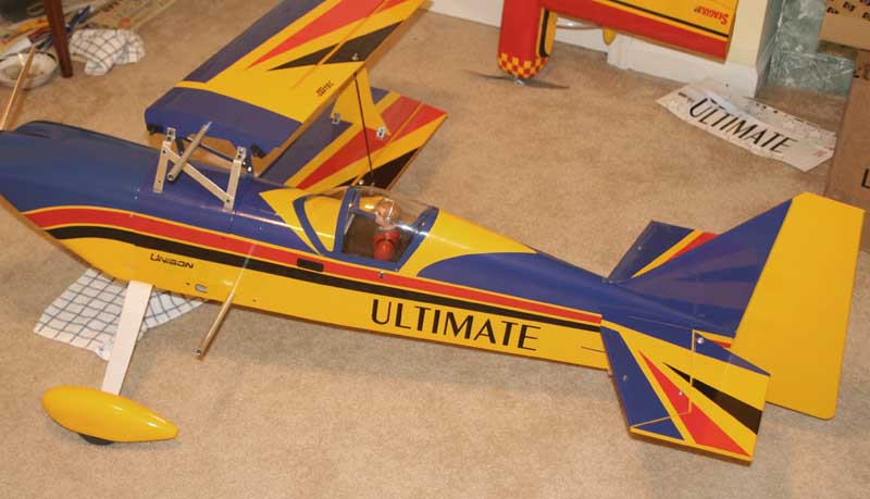

here are a few pics. of mine awaiting its next flights.
